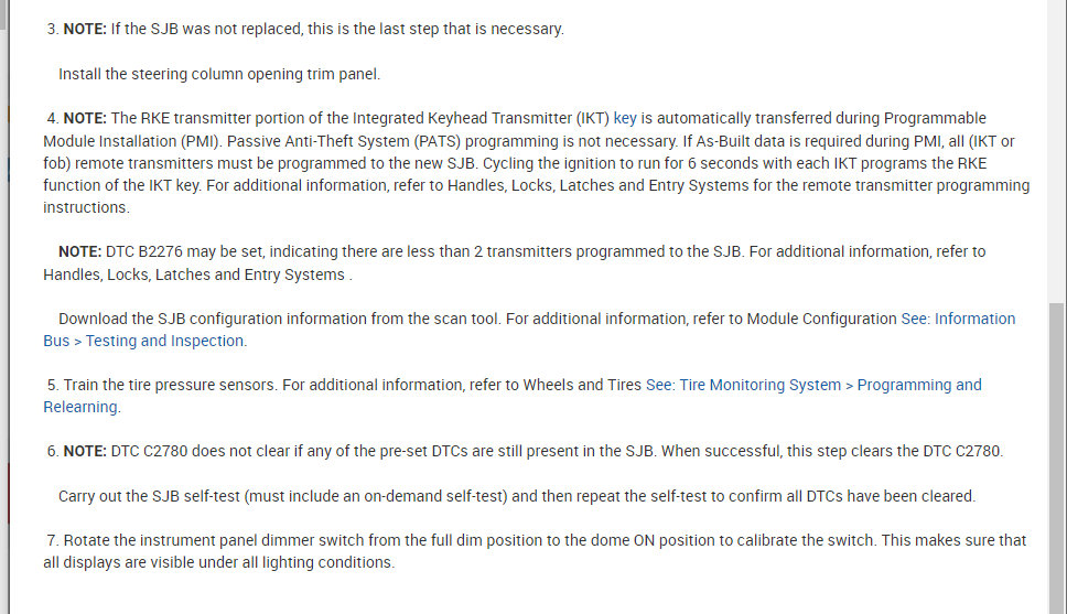

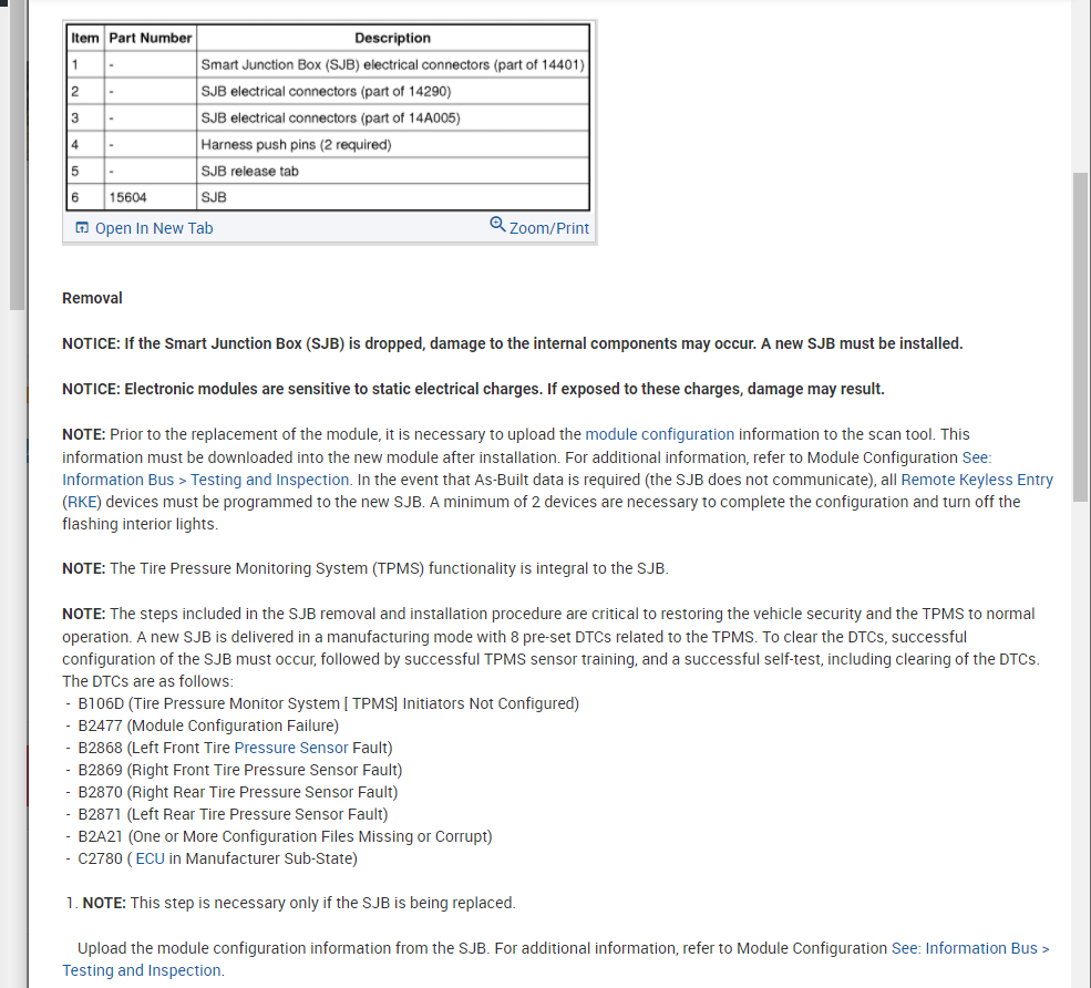

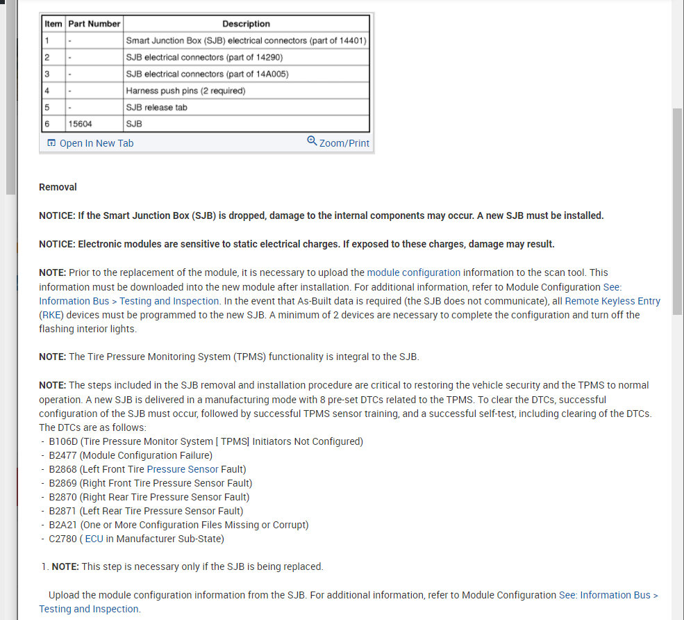

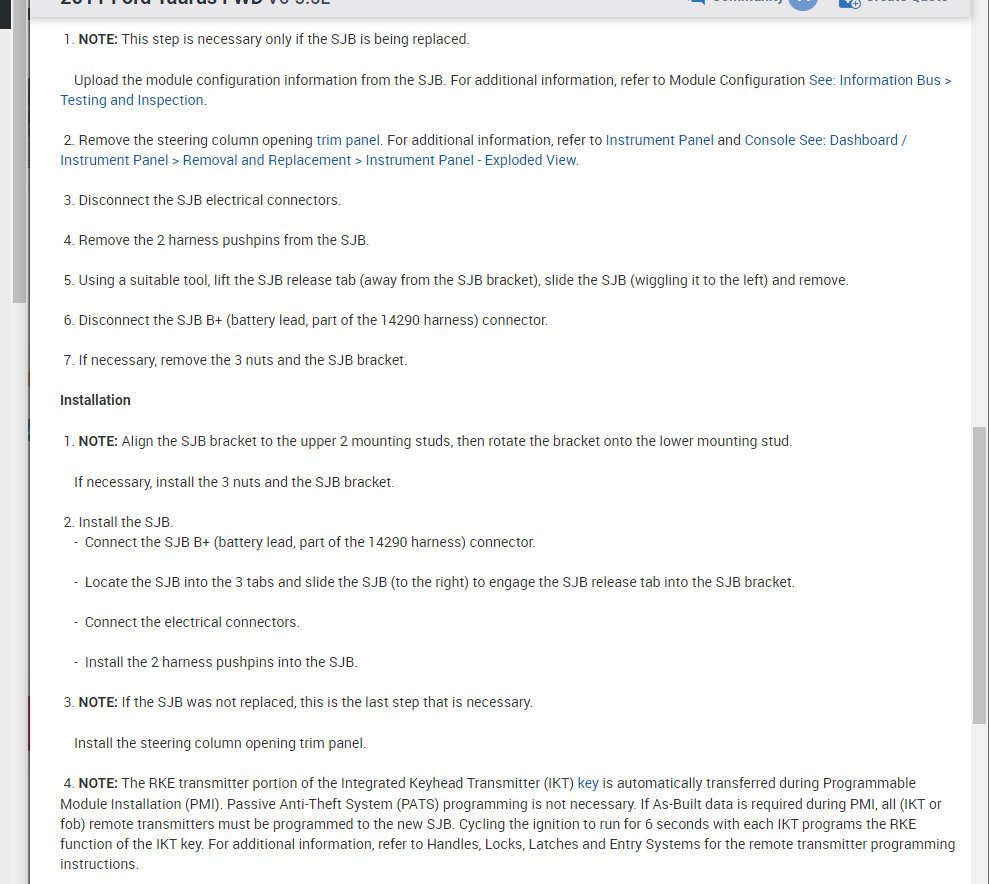

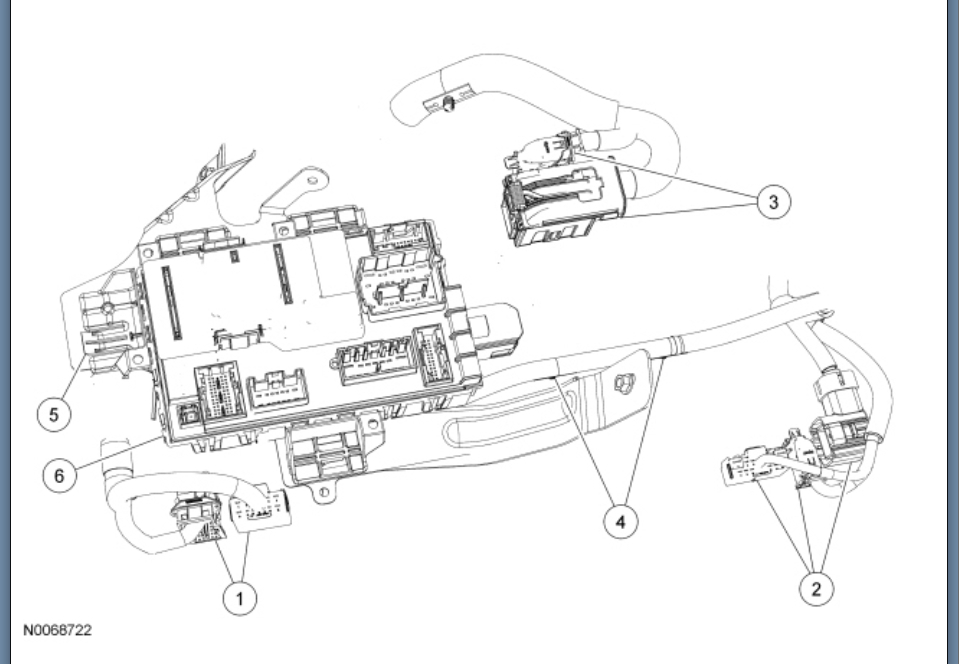

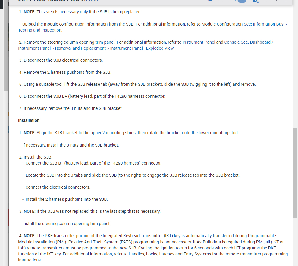

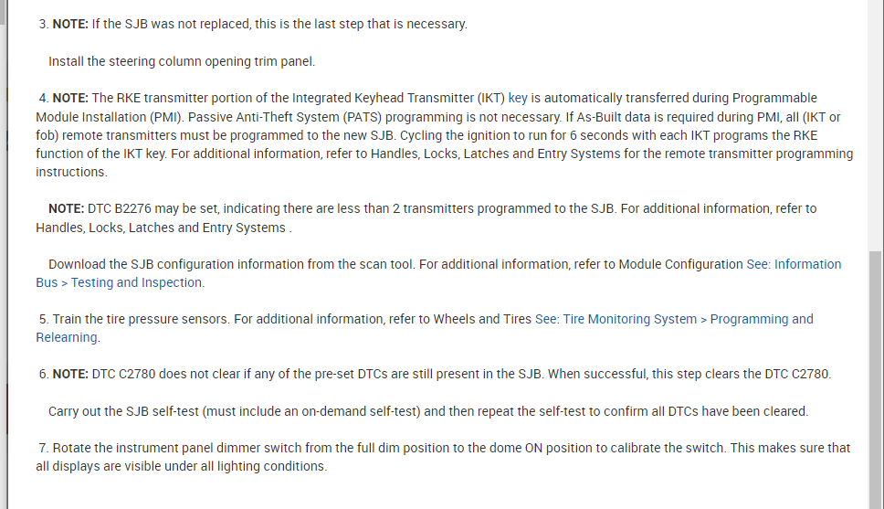

where is the BCM located?
Jul 23, 2017 at 5:49 AM
Ford calls this a smart junction box and it is behind the dash.
Here is a guide that will help with replacing BCMs:
https://www.2carpros.com/articles/how-to-replace-a-bcm-body-control-module
While your will be slightly different, the process is basically the same.
Please see the info below on how to replace this from the manual and let us know if you have other questions. Thanks
