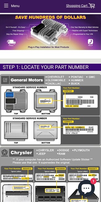

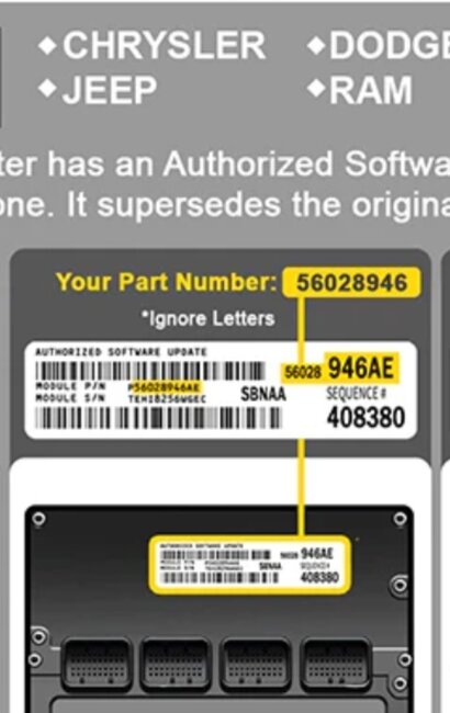

Thanks for the reply. All fuses are intact both in the FCM and also in the trunk. What is that "box" that sits between the passenger and the wheel arch? Where the connector for the hood is located, there is also a box with 4 connectors. Black, orange, white and green. Isn't that BCM?Had it in front of me and it says something about upgrading.
You might think that there shouldn't be any problem finding someone who can program my BCM. I have contacted Chrysler dealers here in Sweden and they cannot help as it is far too old software.I'm starting to wonder if I shouldn't buy what's needed for programming and then contact auto repair shops around here so I can do this work. But apparently I can order a new BCM that is programmed to my VIN number. I hope to get some advice from you on how you would have done it?

I have looked at Flashmaster's website and According to them, the BCM is the module that is located where the connector to the hood is located. If that's the case, then I wonder why many people claim that FCM is the same as BCM?

Yes, the FCM and BCM are the same thing. Can you upload an image of the part in question so I can confirm?
