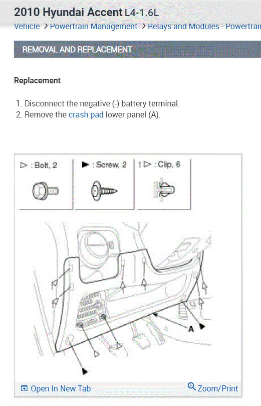

Where is the BCM located?
2010 HYUNDAI ACCENT
210,000 MILES
GSTANGLER
BCM location needed.
Can I reset it without bringing it in?
Mar 8, 2022 at 8:36 PM
  • 110,241 POSTS

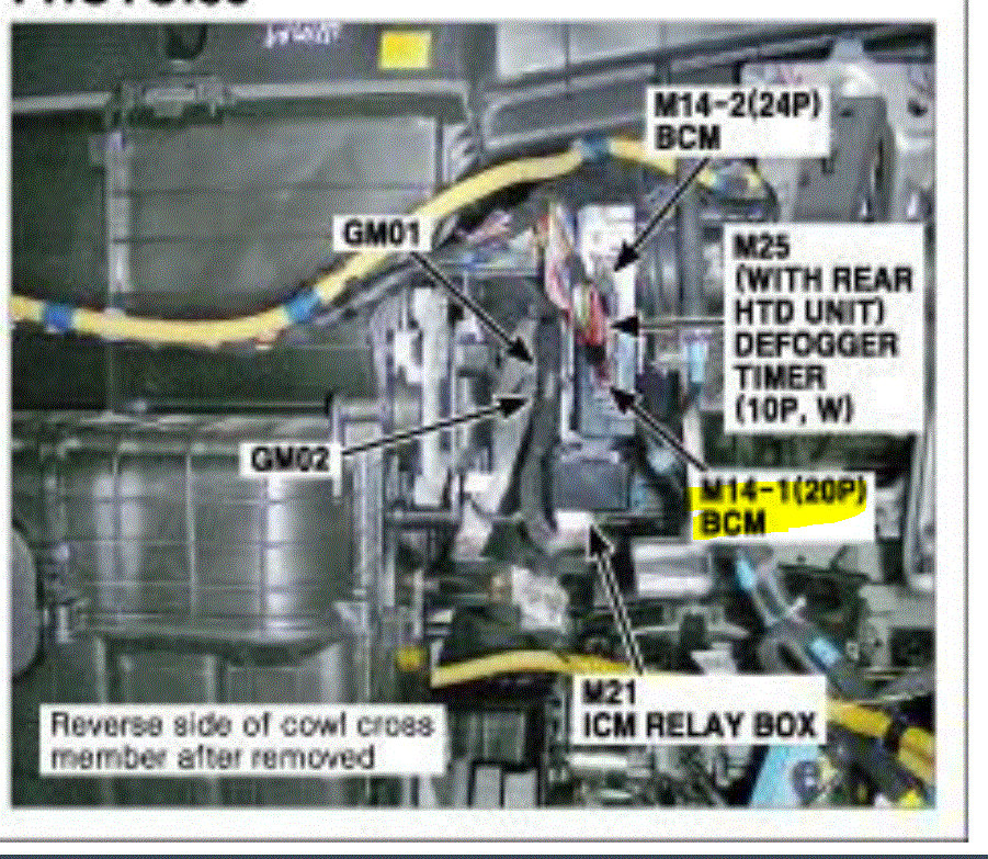

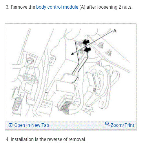

The body control module is located under the left side of the dash (driver's side).
I attached a pic below showing its location and pics 2 and 3 are the removal and replacement of it.
There is no reset. What is happening with it?
