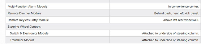

I want to know if there is a separate BCM and if so, where it is located?

they do not show a BCM for that year, but I have copied most of the modules they show. see picture. it will not load i will have to try another reply.

okay, got it to load.

No separate BCM on the 1993. Those started when they switched to OBDII in 95.
