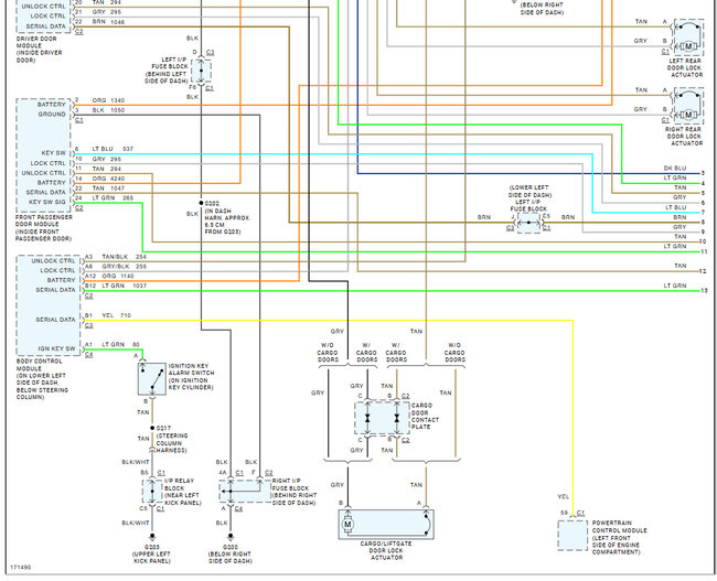

Wiring diagram needed for the BCM and the doors, including ajar switches and actuators, driver seat heater and motors and the wiring in between it and the BCM as well?
2003 CHEVROLET TAHOE
245,000 MILES • 5.3L • V8 • 4WD • AUTOMATIC
AIRICKZOWPA
Former auto tech but been away for 15 years. My "Passenger Rear Door Ajar" message is always displayed. My driver seat no longer moves and no longer heats.
I have checked the basics, fuses, connectors etc.
I am looking for accurate wiring diagrams for my vehicle listed above, specifically for the BCM and the doors, including ajar switches and actuators, driver seat heater and motors and the wiring in between it and the BCM as well.
I suspect my BCM is shorted internally, but I don't have the money to just throw one in and have it programmed in the "hopes" that it fixes my issues.

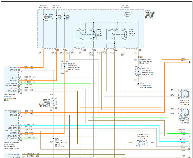

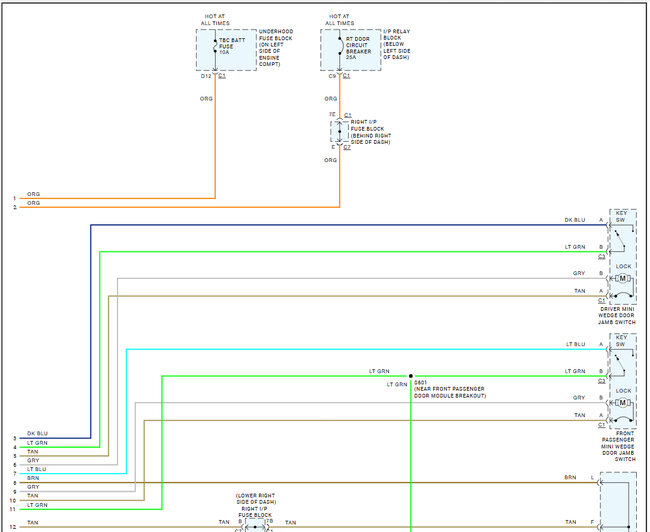

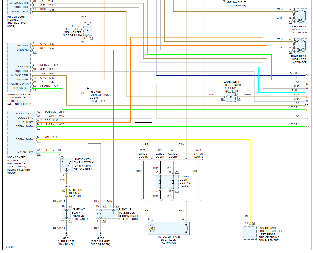

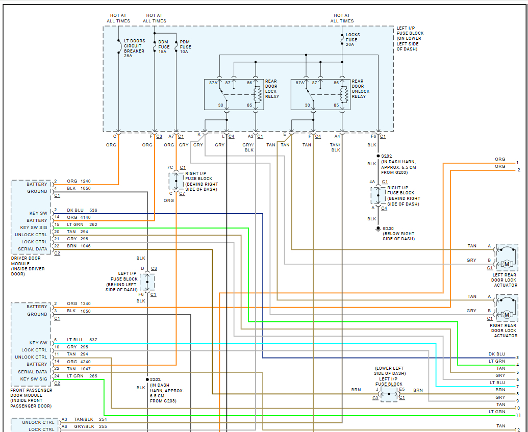

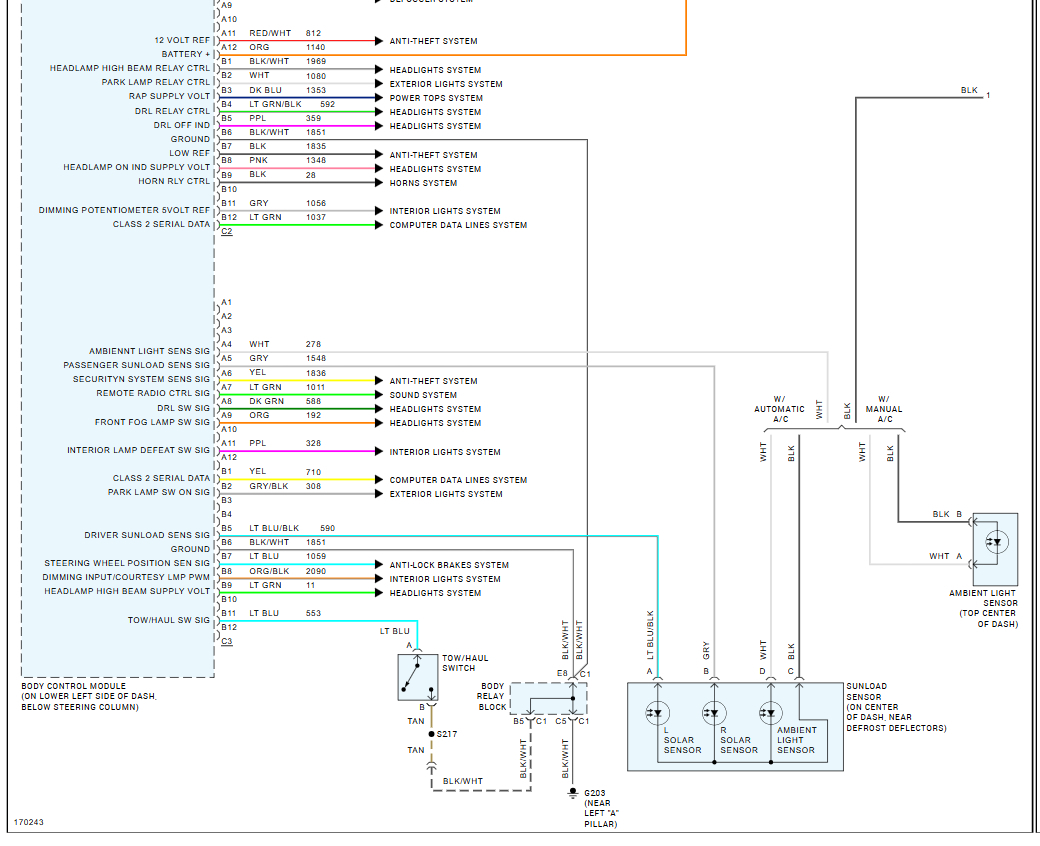

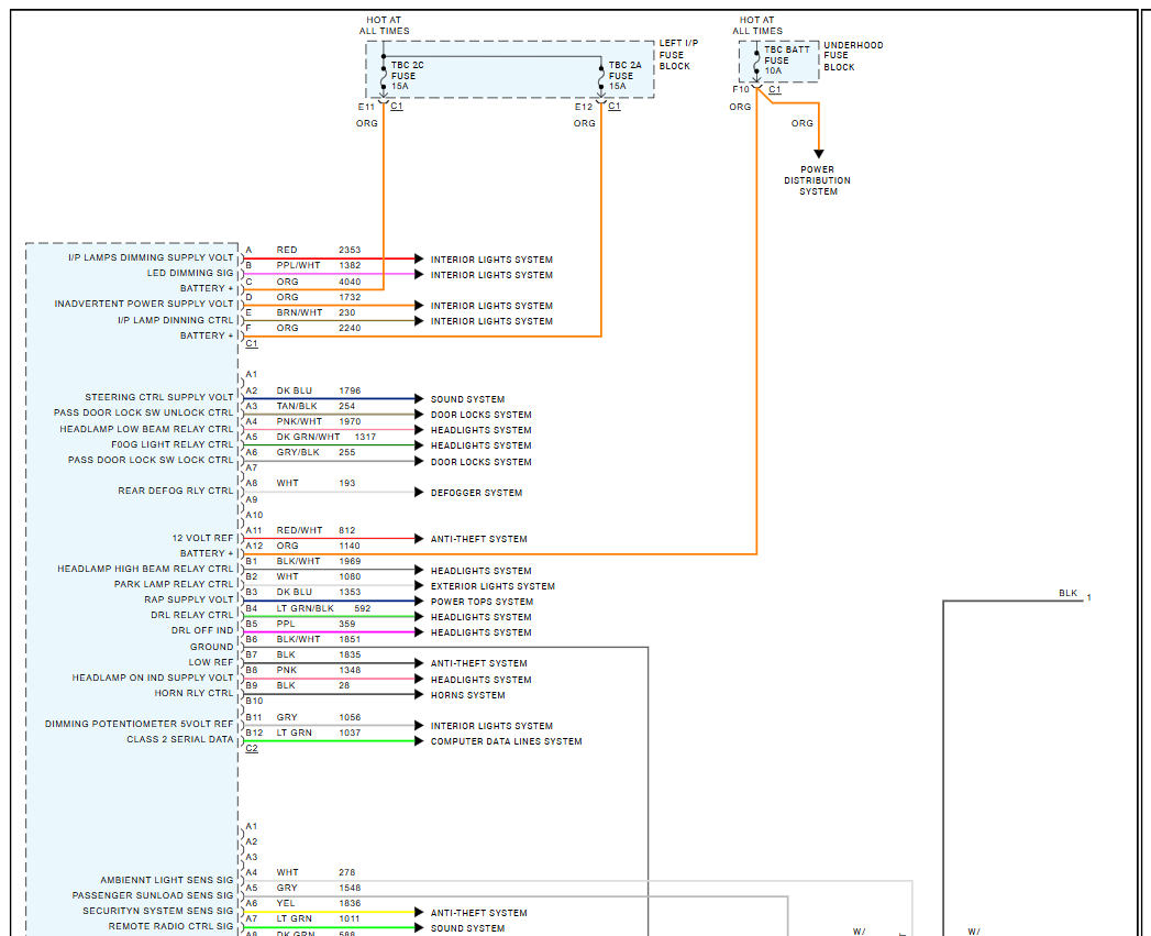

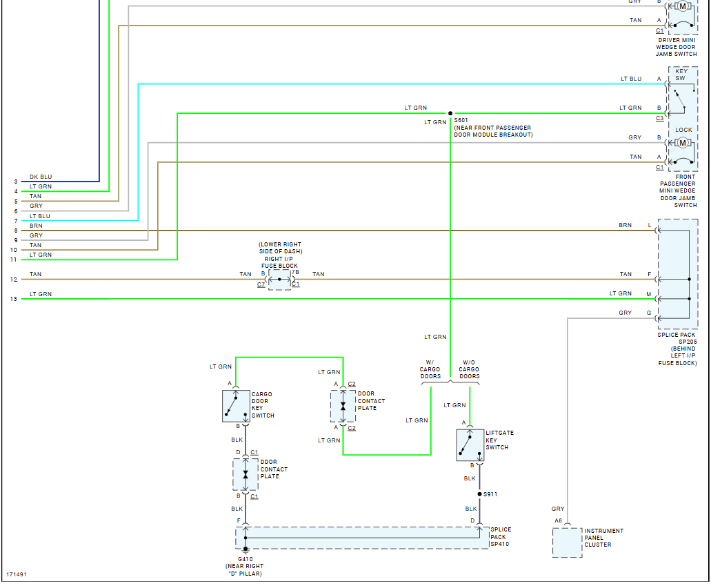

This sounds like the DDM is out, but here is the BCM and door lock wiring diagrams so you can go over the outputs and inputs. Also, did you try a CAN scan which can help give you the codes for a bad DDM? You can get a CAN scanner (Controller Area Network) which will work on most cars from Amazon.
https://youtu.be/u-4syLc-ifQ
As you can see the BCM does not have much to do with the door locks. Check out the images (below). Please let us know what happens.

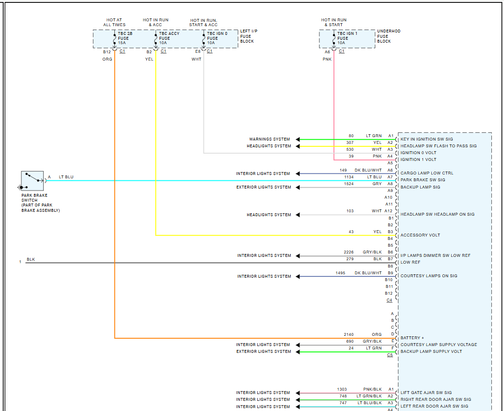

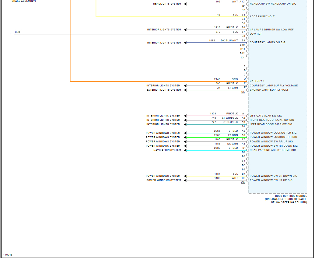

Issue A- Please tell me if my logic is correct.
Today, I went and checked the voltage readings at the BCM Connector C6 terminals a2 (RR Door Ajar) and a3 (LR Door Ajar). Since the LR Door Ajar switch is known to work properly, I got a baseline from it.
With the LR door closed, the voltage at a3 is 10.7v, opening the door causes this to drop to 0.0v
The voltage at a2 (for the RR door) is 0.5v and drops to 0.0v when opening the door.
To confirm proper operation of the switches, I swapped the terminals a2 and a3. With ck#748 (for RR door) plugged into terminal a3, the vehicle recognized the LR Door being opened when I opened the RR door. In my opinion, this confirmed proper switch function in the rear doors.

The Pass Rear Door Ajar sounds like the latch is bad and I would try the DDM unplugging and check for corrosion on the connector and if okay I would replace the DDM.
