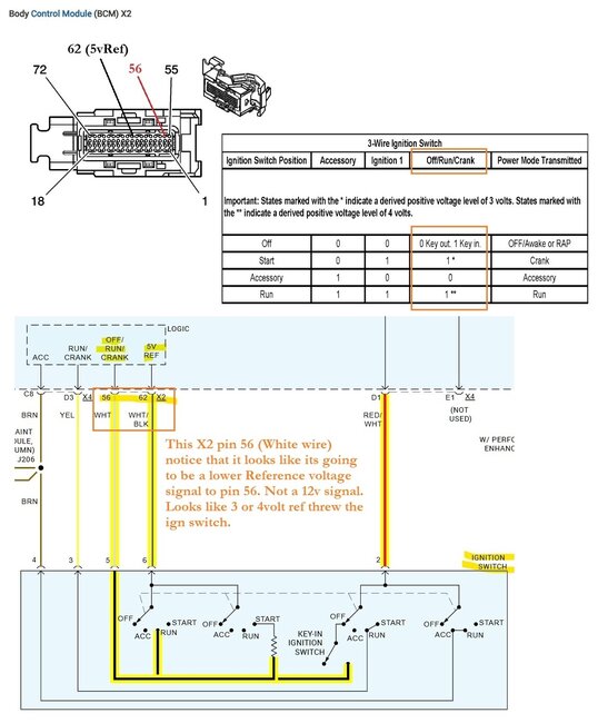

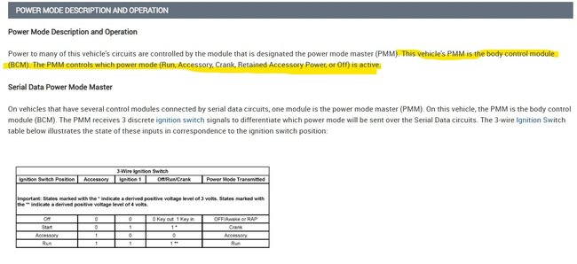

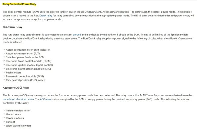

Hello, sorry to hear about all this trouble, I can't believe they charged you almost $900 for nothing really, In the tech notes here he's stating the BCM is lacking power to it and needs to be replaced before proceeding, that's a red flag to me. You don't replace a module because it doesn't have power to it, that's not logical at all, lets pull up some wiring diagrams and BCM pinouts so you can check for power yourself and see what its missing, all the reprogramming was unnecessary, since this obviously a wiring issue. Going to look through the rest of these notes and will post some wiring diagrams for you to check right at the BCM connectors themselves, you have it located I assume?

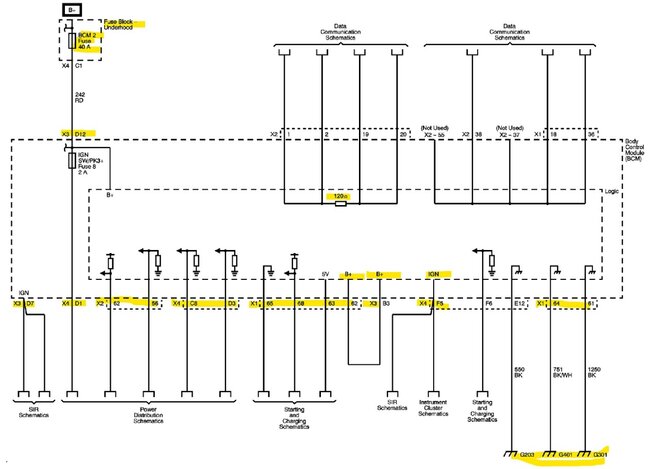

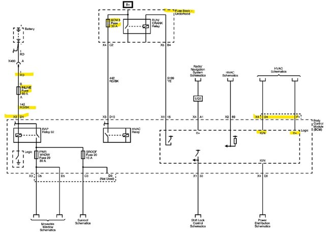

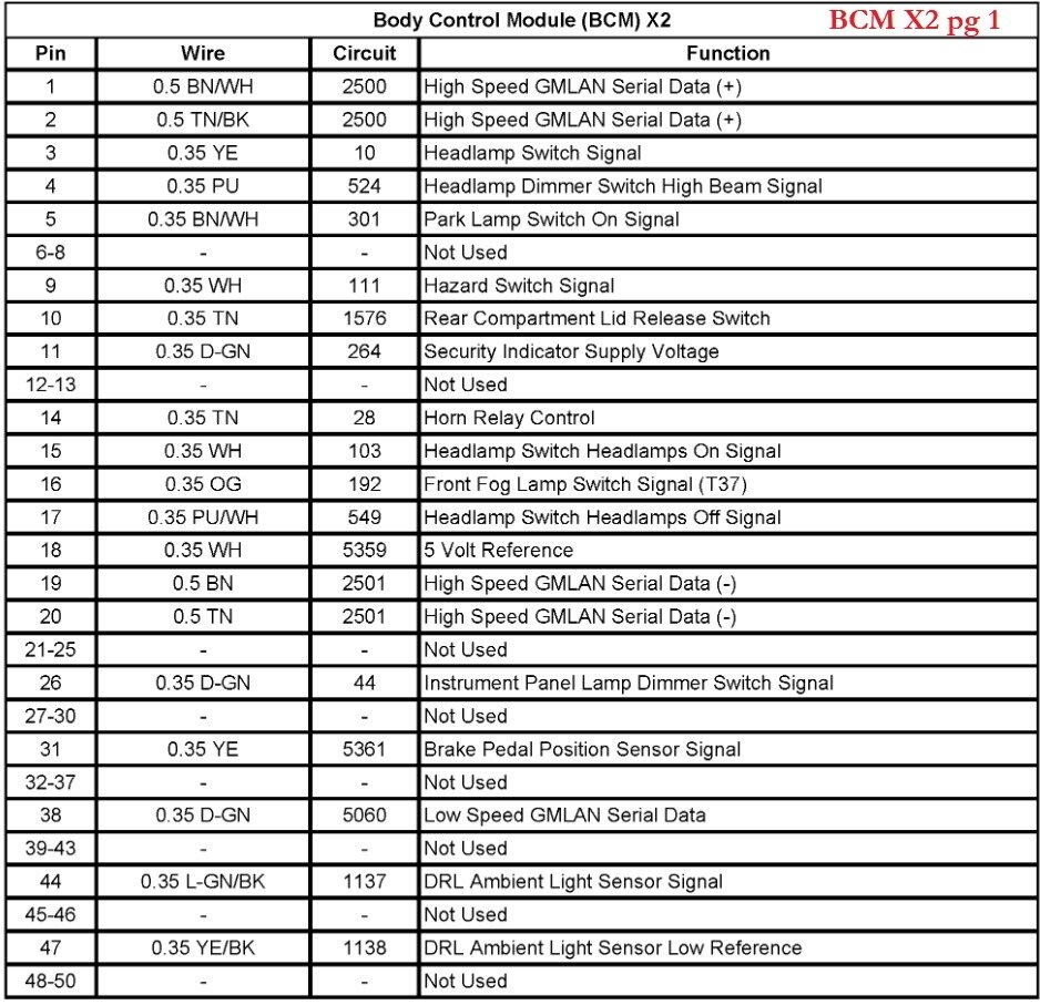

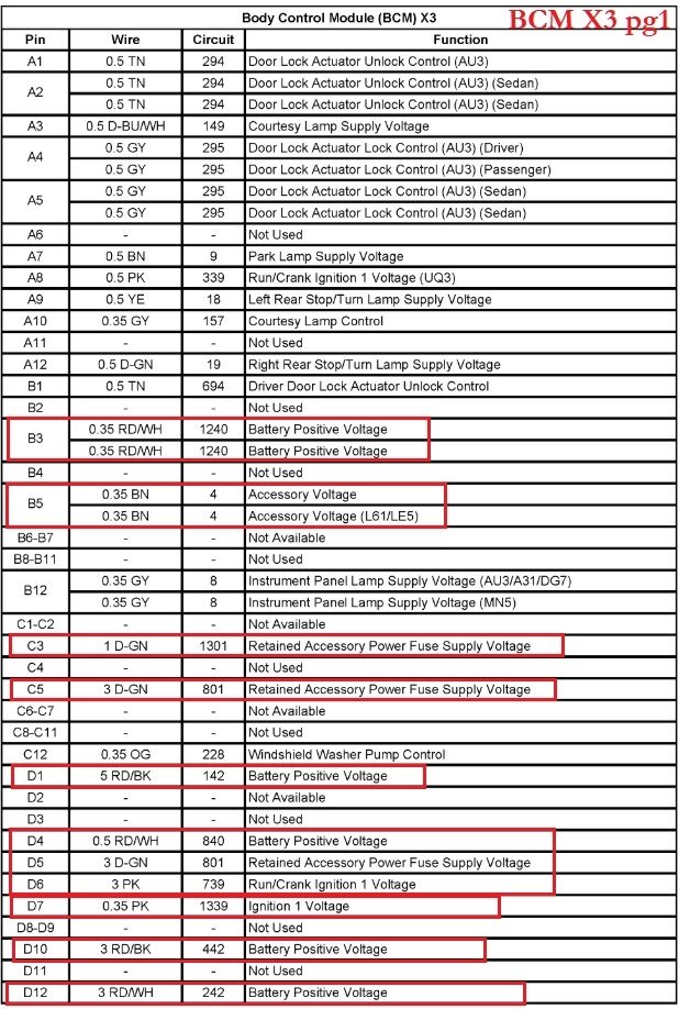

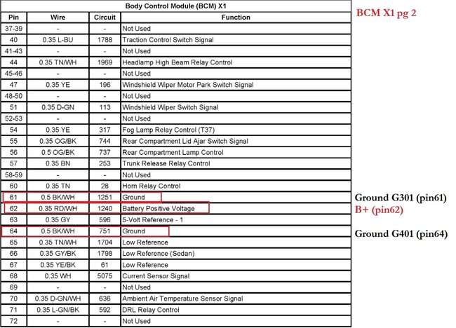

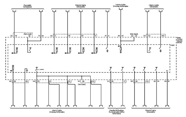

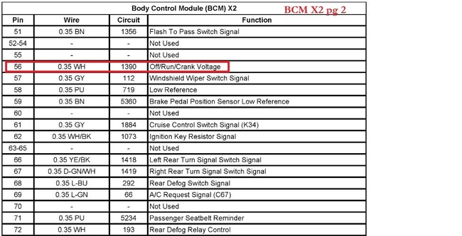

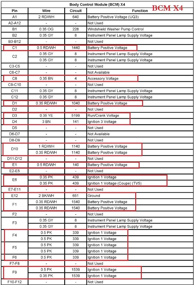

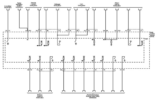

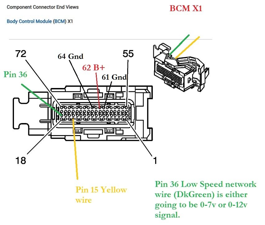

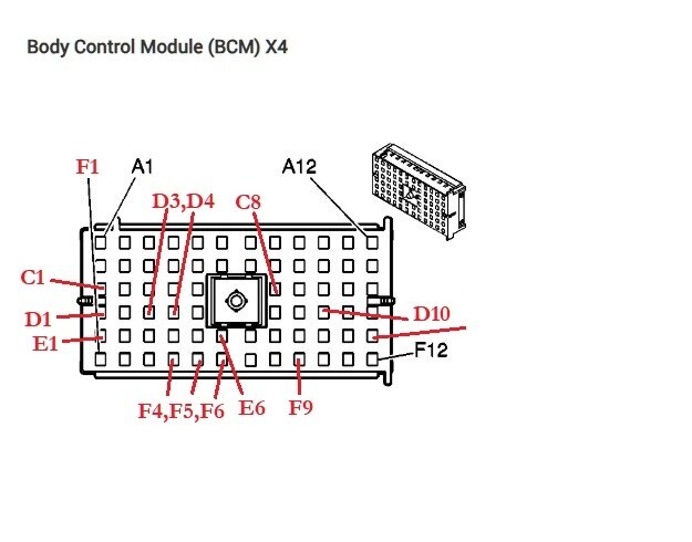

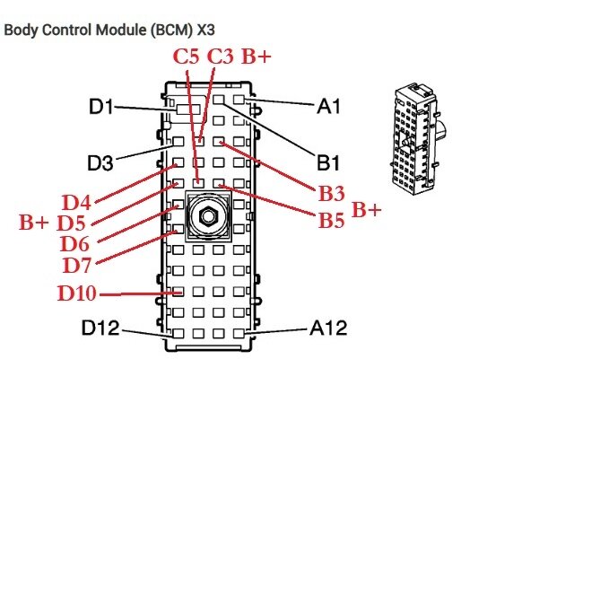

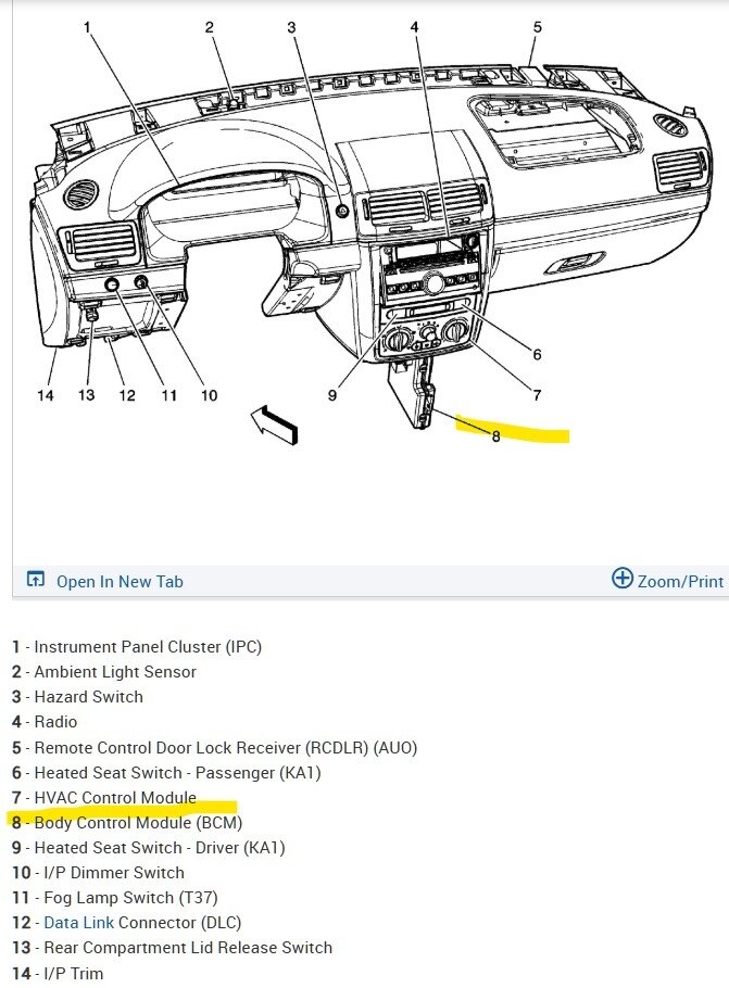

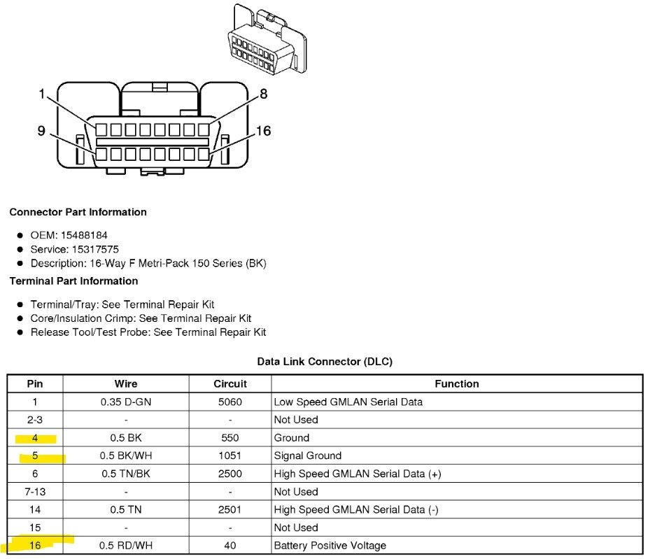

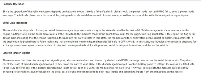

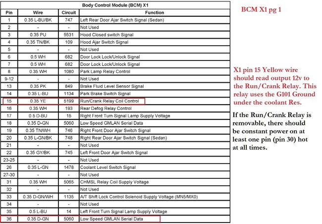

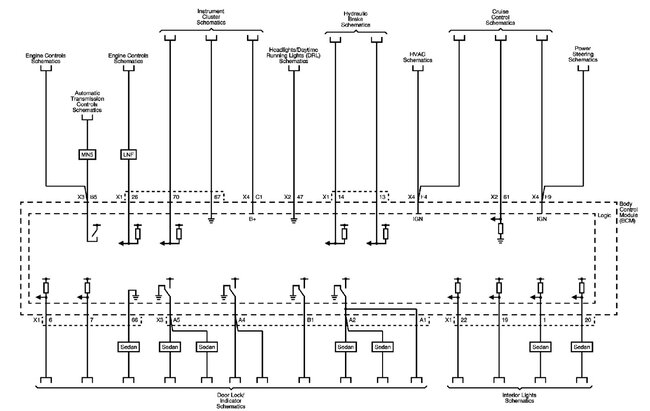

Okay, there's a lot of service information here, there are 4 BCM connectors and I have marked all the B+ power and ground wires that should be powered up and outputting power. There are also some BCM operations diagrams at the beginning there, so go through those and see how it operates in different modes; I would start by rechecking the areas where you worked, any wires and sections of harness that may have been moved around. It's very possible there are some loose pins in some connectors not making good contact, I don't see why the BCM would need to be replaced if it wasn't the original fault. The dealership is just trying to do that with hopes that replacing the module resolves the issue, but there are many power wires having to do with this module, I think you'll find power or a ground missing somewhere. The dealership shouldn't have charged almost a thousand dollars and not resolving anything. You may want to try a smaller shop that has a good reputation to take a look at it and give an honest diagnosis.

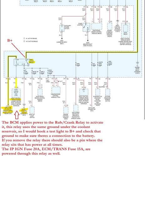

So sorry for the delay, it has been an extremely busy week, regarding these chassis and body grounds, make sure the actual ground wire's connection, so the connector crimped onto the wire itself is not over a painted section of the body, if the bolt used to hold that ground on does not conduct well the ground will make contact with the body but it may not carry current well. On body grounds I will grind off the paint in the small section where the connector washer is making contact. And when it comes to situations where there might only be one or two grounds that run to the body and engine block, those grounds need to be solid, most ECM/PCMs are grounded to the body, and the engine block to the body as well, so one ground that looks okay, but can't carry current will cause issues that can be misleading. If you think about how much current flow a starter pulls and see how large the main power wire to it is, all that current needs a ground just as large to make it back to the battery.
Something else that I see overlooked all the time is the battery terminals themselves. The cheap painted, wire bolt on terminals are only supposed to be used as a temporary fix. There is high voltage drop across those types of terminals when the electrical load is high.
You can do a voltage drop test when trying to crank the engine by going from B-(Batt Neg) to the engine block and B- to the body with a meter set on DC volts, you may be surprised to see a few volts on either the positive or negative side of the electrical system. But I see bad battery terminals quite often, even causing the wires going to the battery to overheat when the engine is running.

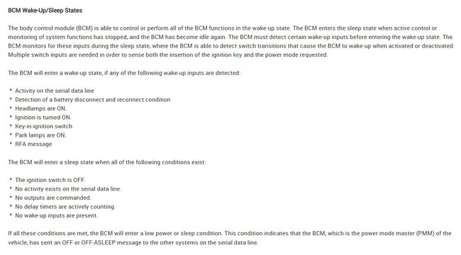

The theft light coming on a few seconds is okay, as long as it goes out. Same with the Check engine light, I think you're going to find that correcting all these grounds might take care of any power issues with the BCM, the GM BCMs do so much in these vehicles, with sending out wake up signals to other modules on the networks, they actually have the most functions of any module. So bad grounds are going to affect everything it powers up. Once you get done with cleaning and repairing the grounds, clear all the codes out, turn the key off for 30seconds or so, and see if any codes come back. If not and it cranks and starts, then you don't really need to check any BCM powers. This might all just be due to taking things apart and the grounds not making good contact afterwards.

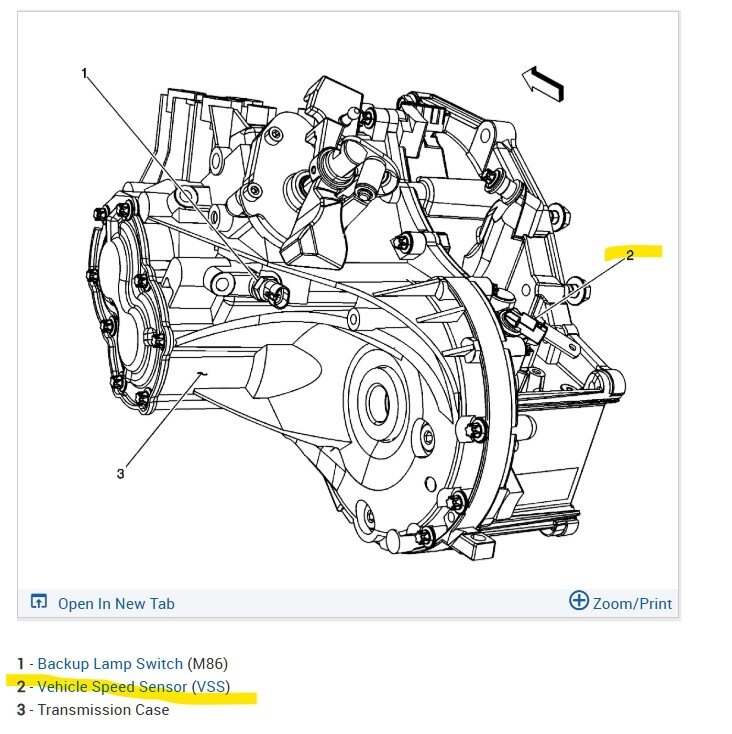

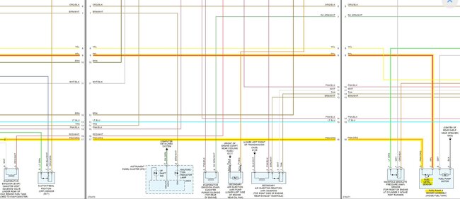

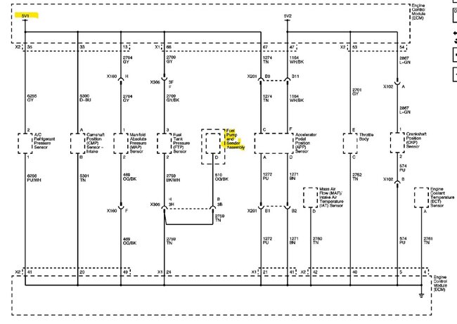

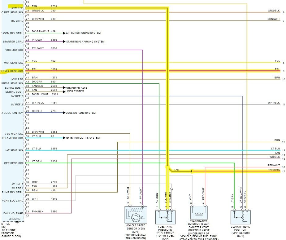

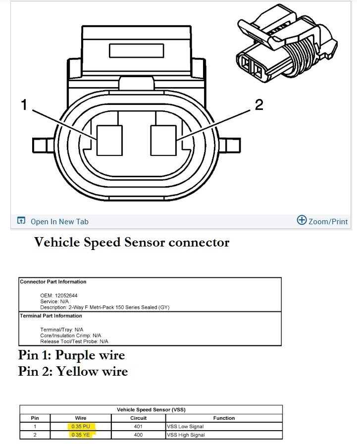

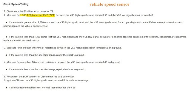

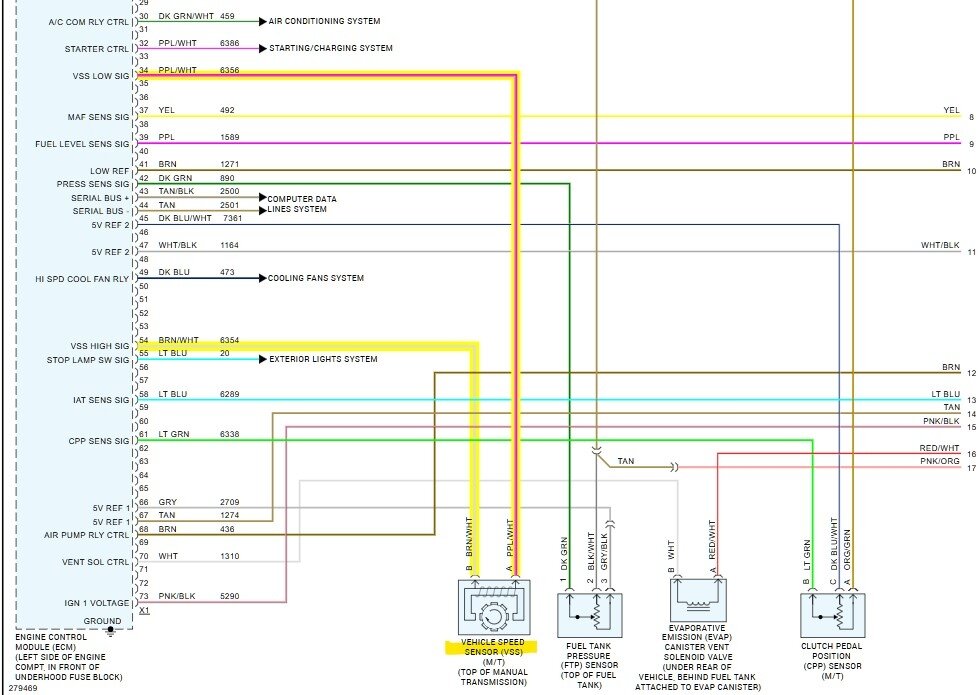

Sorry I had to read your posts again to catch up, been through a lot of vehicles lately, So, the dealership is returning most of what they previously charged you. But still no Speedometer and gas gauge? The fuel gauge code P0463 (Fuel Level Sensor circuit High Voltage) on the OEM wiring diagram shows the fuel level sensor is fed a 5volt reference and when the float on the sensor moves up and down as the fuel level does, the float is on an arm which changes the resistance in the circuit, and therefore changes the 5volts to a different level to indicate the fuel level. So, if the sensor is missing/open its ground (low reference) or the sensor is shorted to a power wire, it will read a high voltage level at the PCM.
As for the vehicle speed sensor code, there are some specs for checking the resistance of the speed sensor for the manual transmission, but the PCM pins they have listed for testing are not the same as what is shown in the aftermarket wiring diagram.
But it's possible the vehicle speed sensors wiring may have been affected when changing the shift cables, since the speed sensor is located on the transmission housing. With all the wiring harness movement you had posted about, it's difficult to say exactly where these wiring issues could be, but again going back to any areas where the harness was moved around and worked on, including the PCM connectors if they were disconnected, would be the first areas to check.
