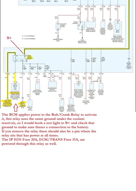

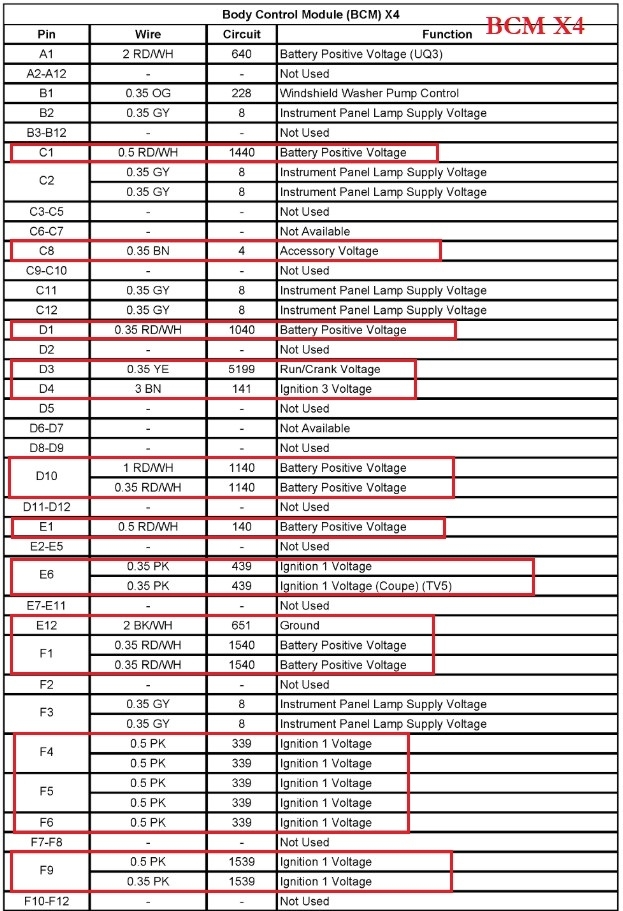

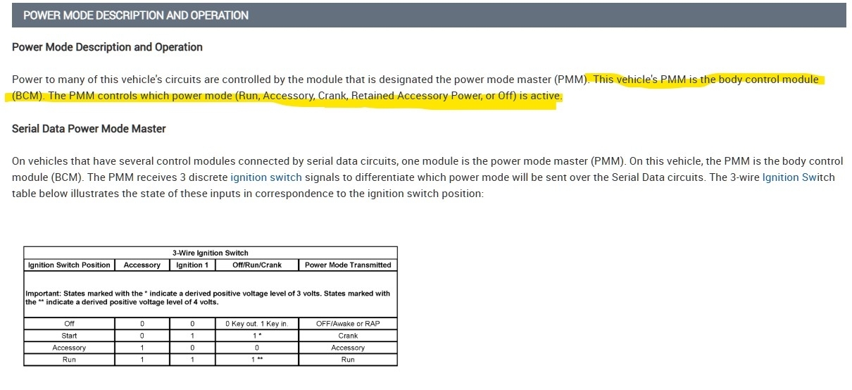

Hello, sorry to hear about all this trouble, I can't believe they charged you almost $900 for nothing really, In the tech notes here he's stating the BCM is lacking power to it and needs to be replaced before proceeding, that's a red flag to me. You don't replace a module because it doesn't have power to it, that's not logical at all, lets pull up some wiring diagrams and BCM pinouts so you can check for power yourself and see what its missing, all the reprogramming was unnecessary, since this obviously a wiring issue. Going to look through the rest of these notes and will post some wiring diagrams for you to check right at the BCM connectors themselves, you have it located I assume?

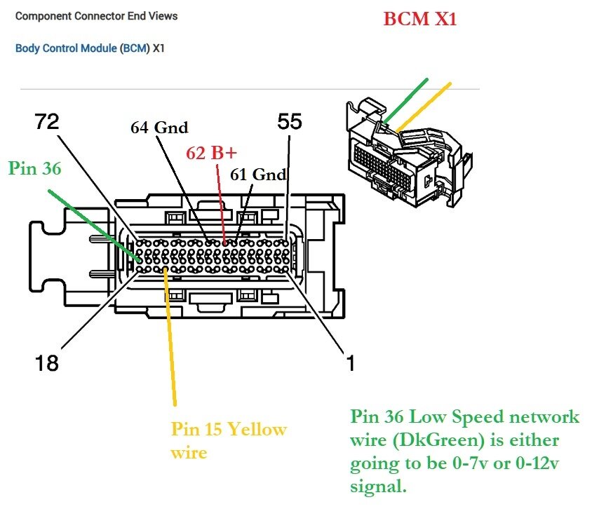

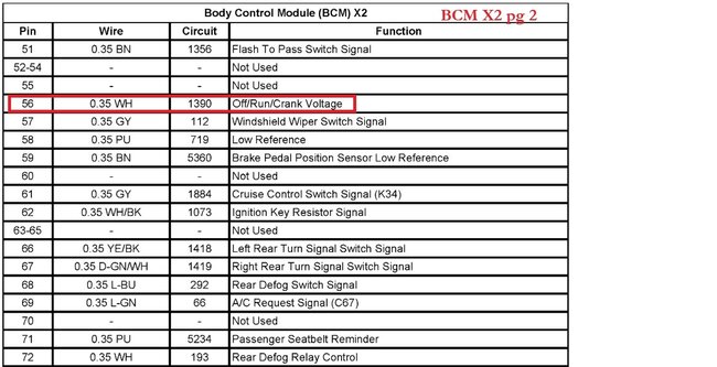

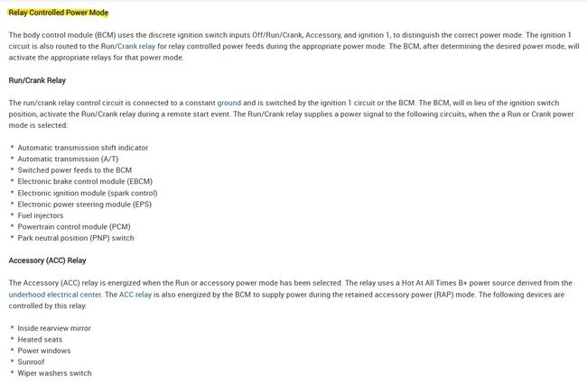

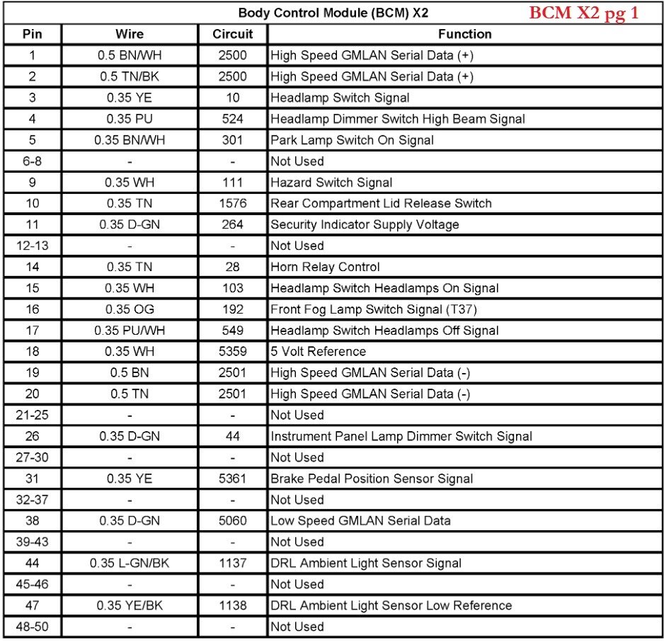

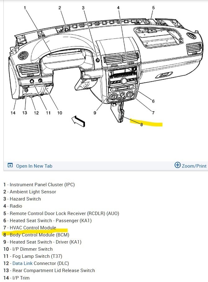

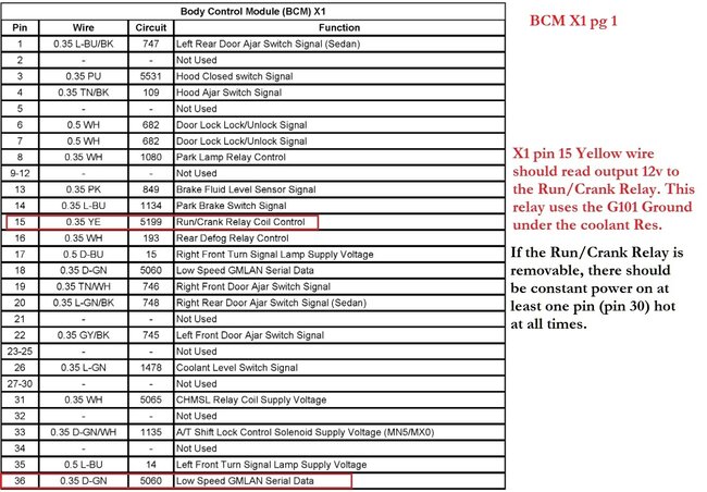

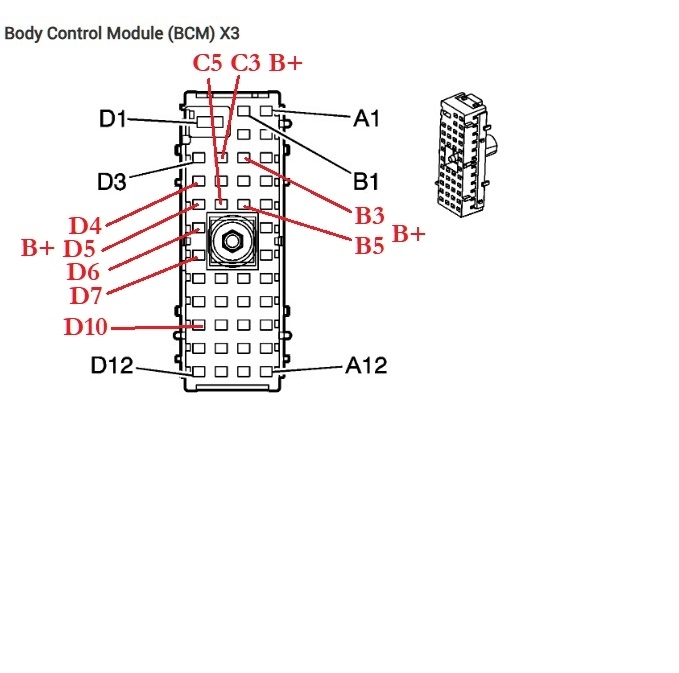

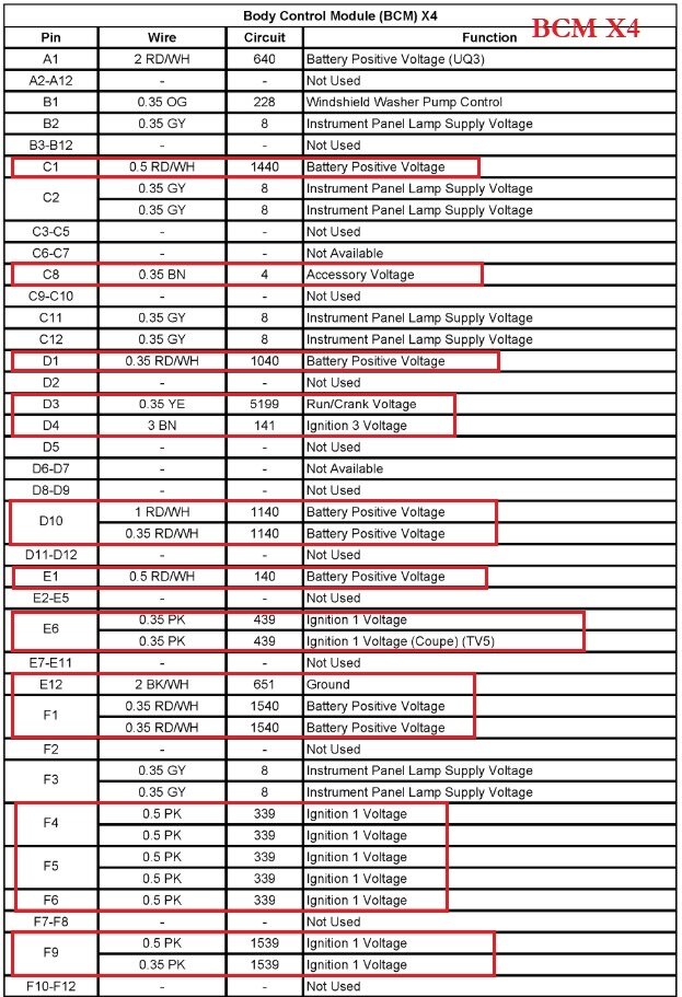

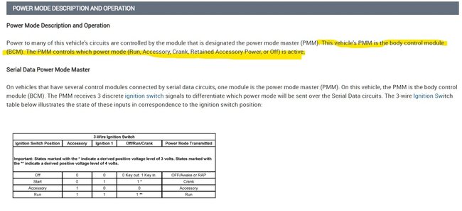

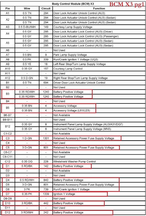

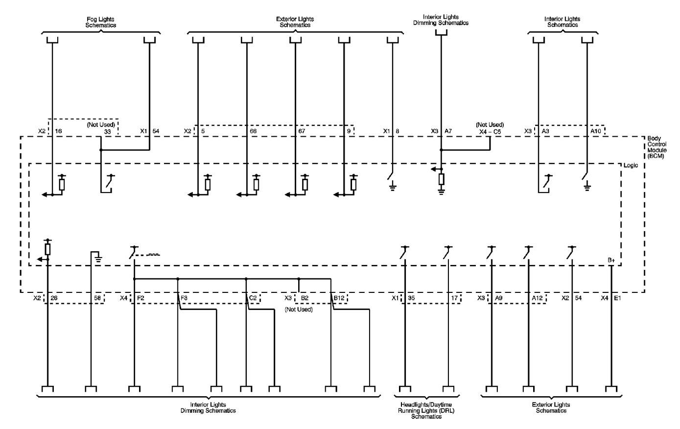

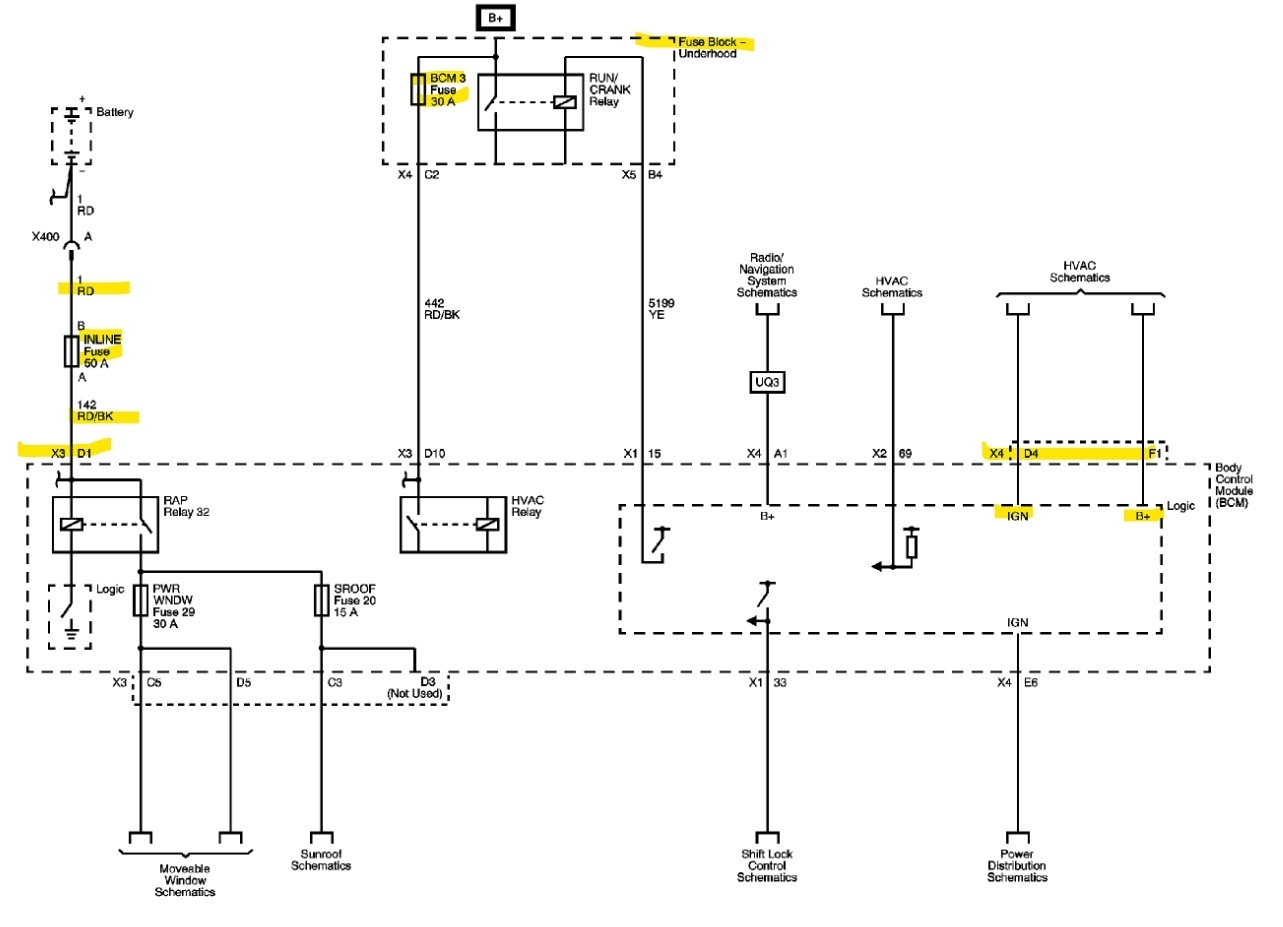

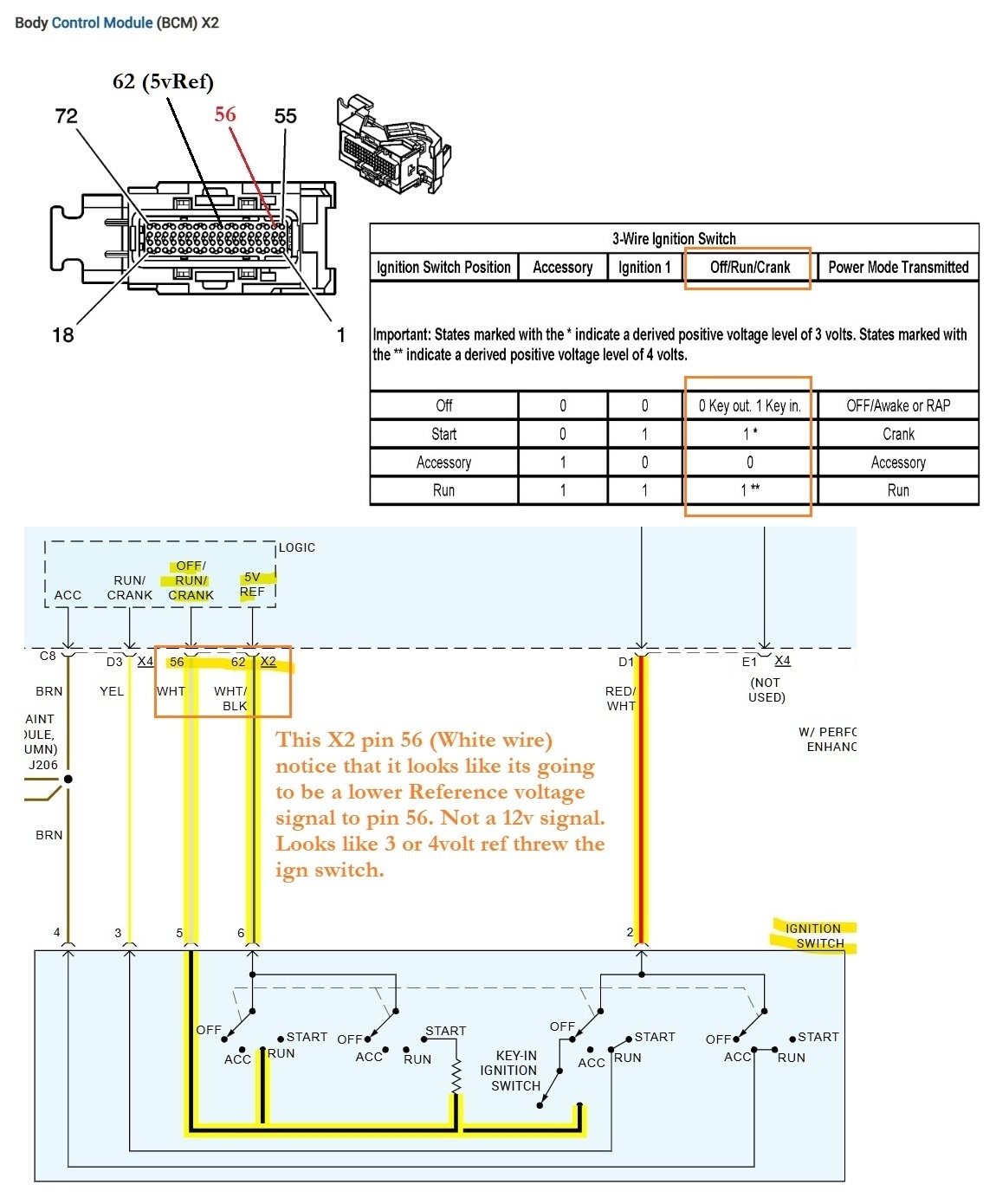

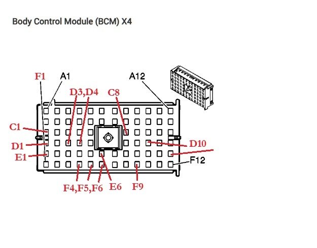

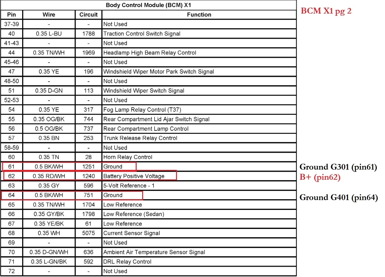

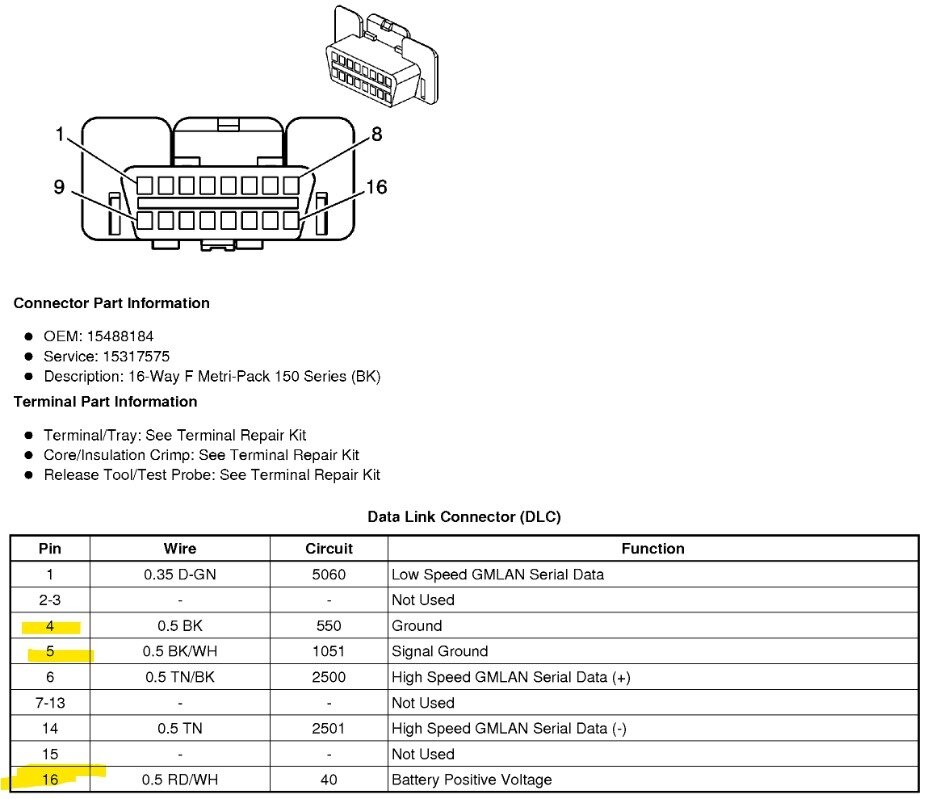

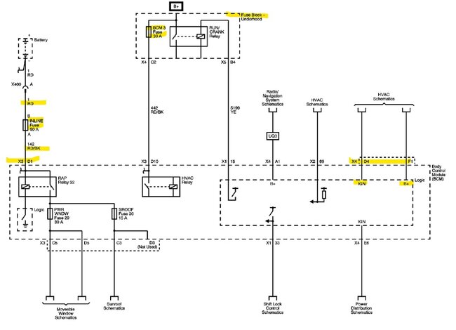

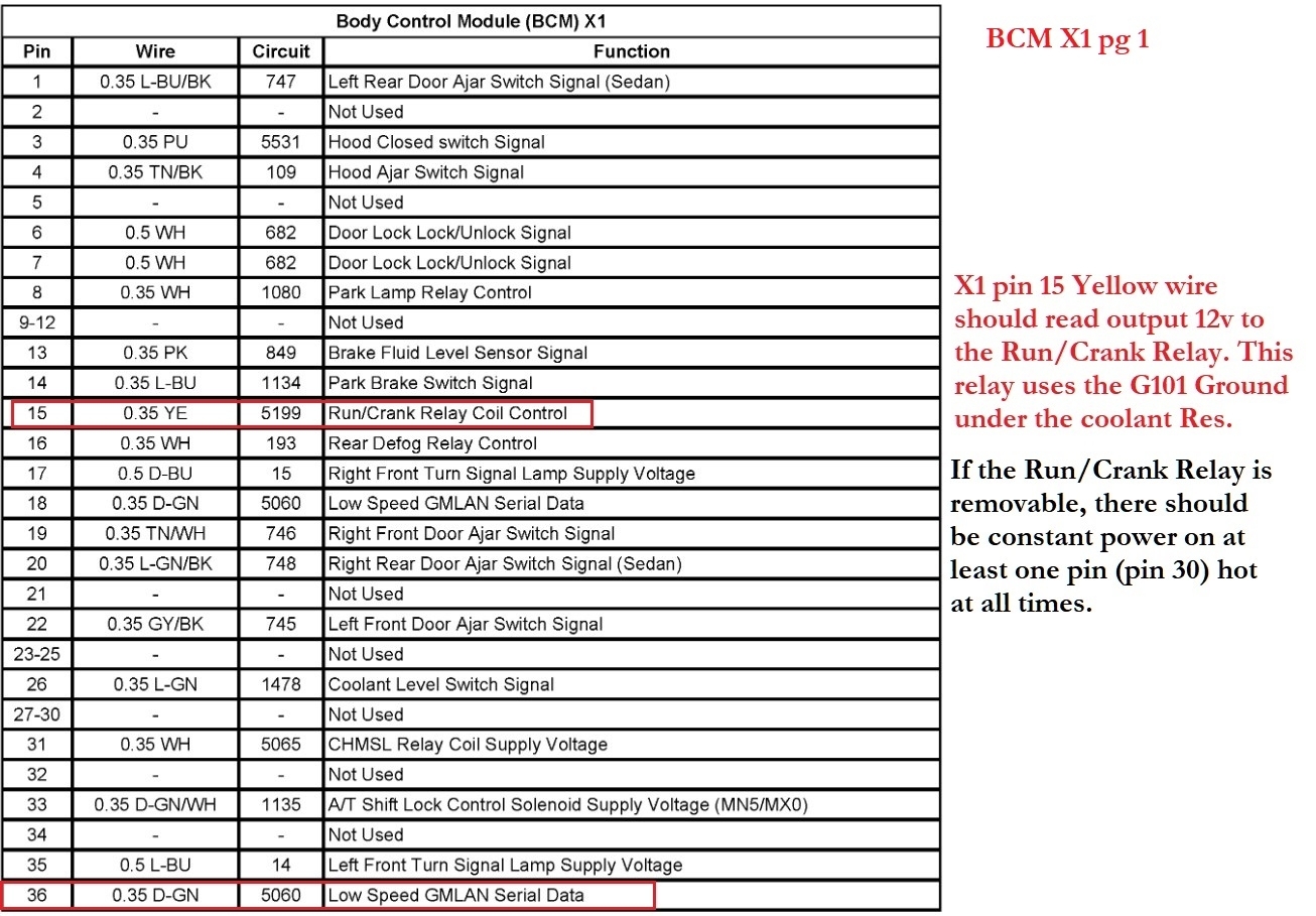

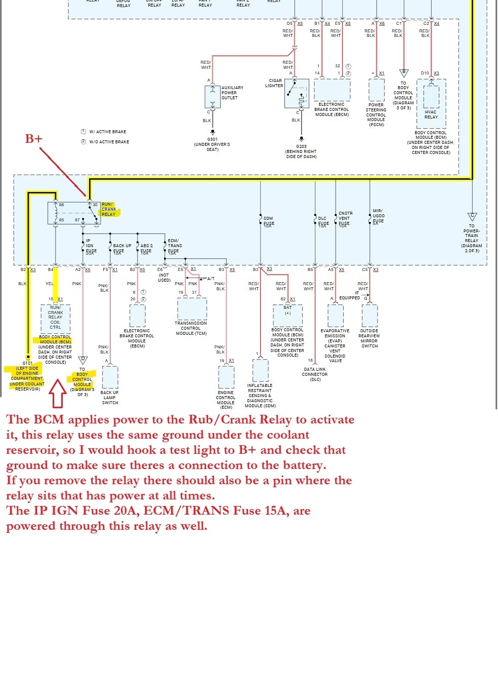

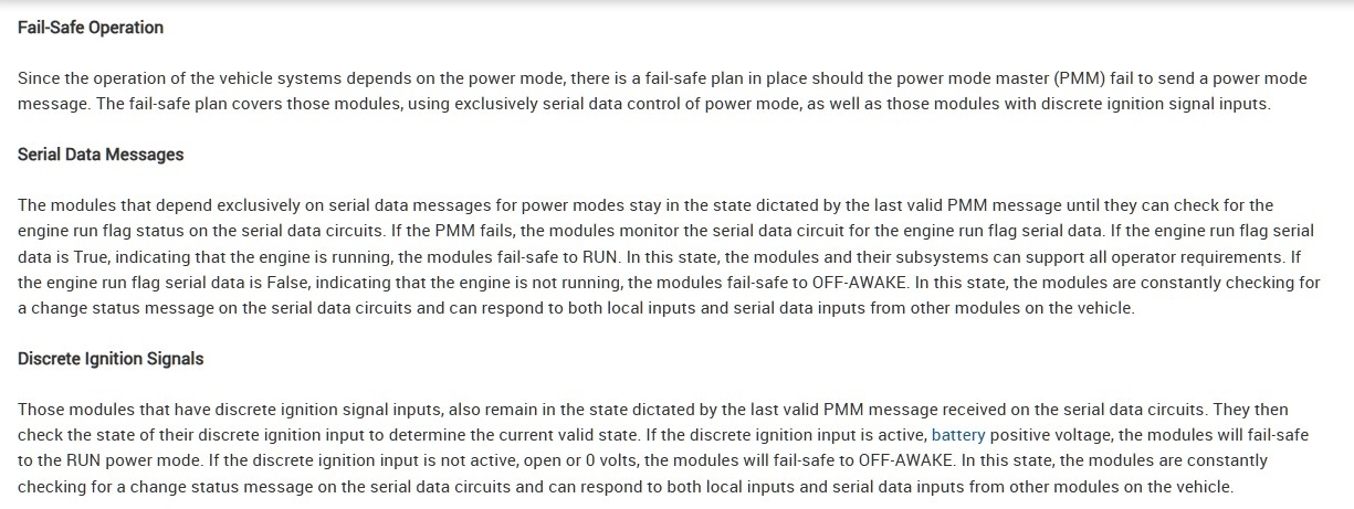

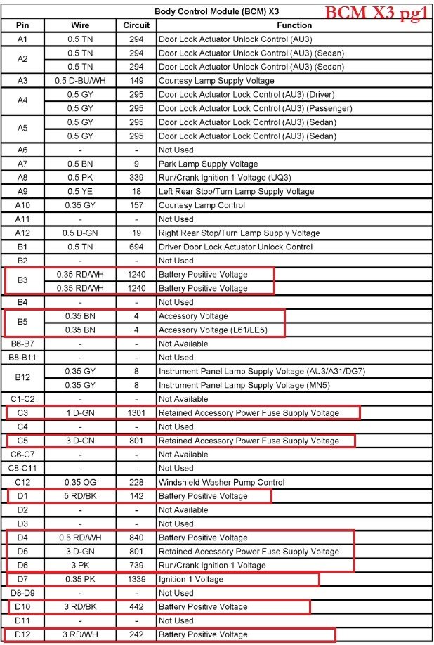

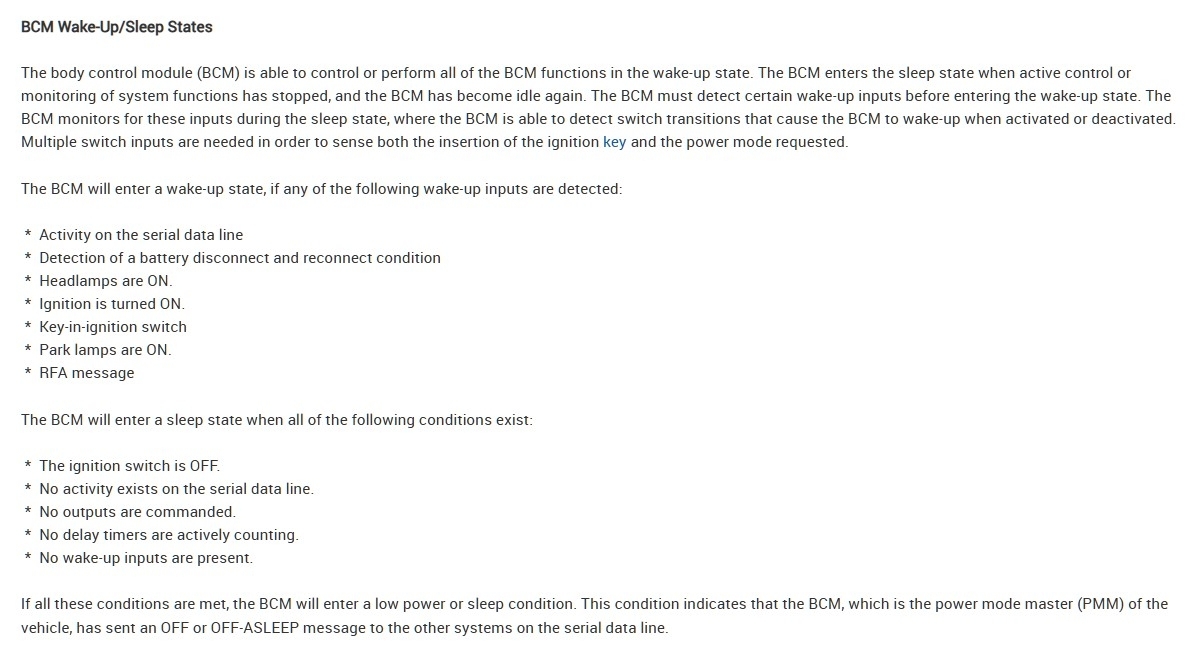

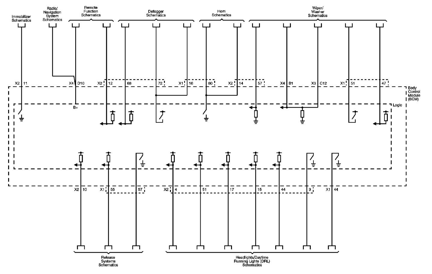

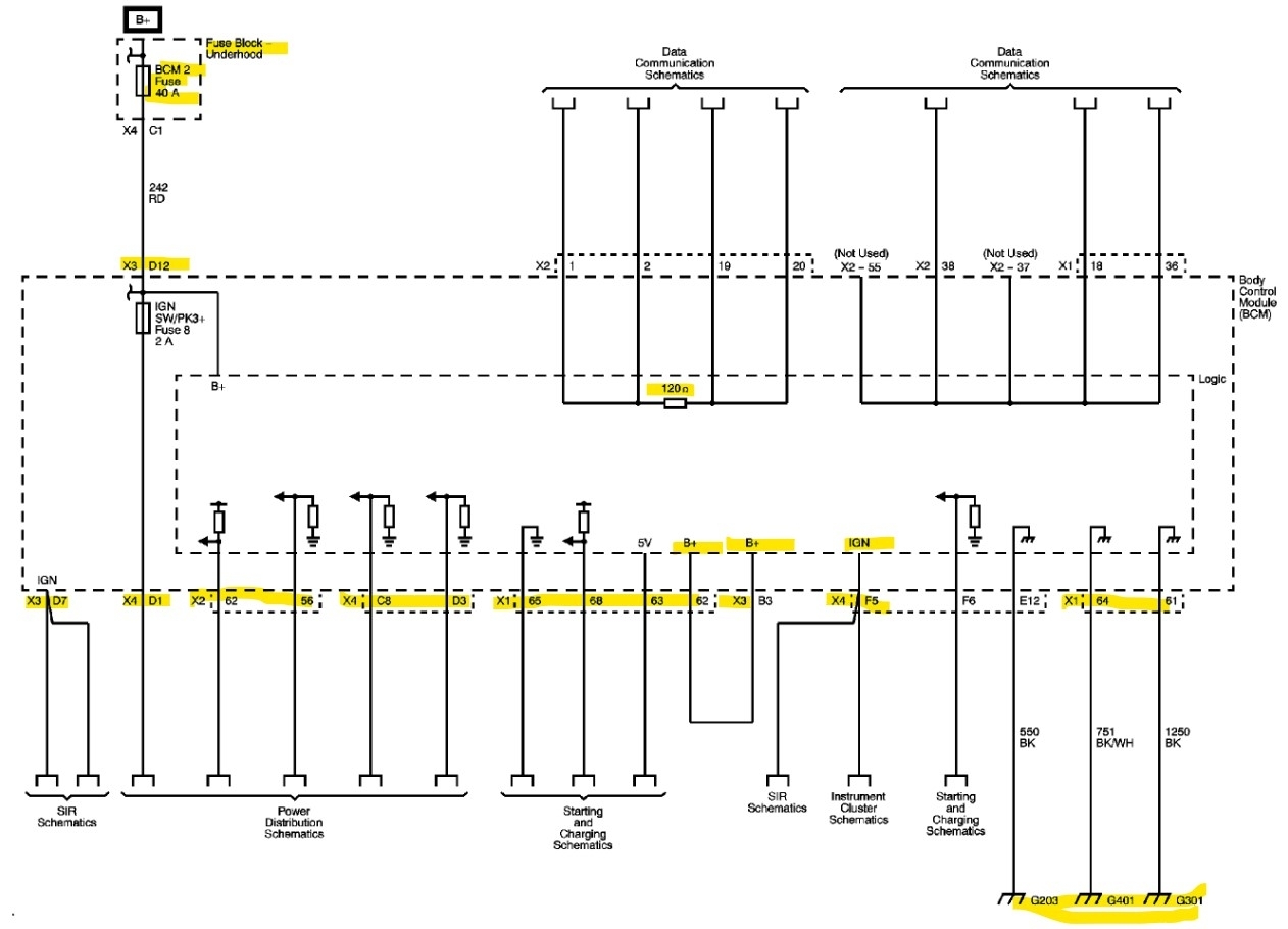

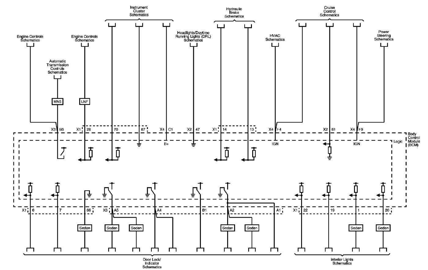

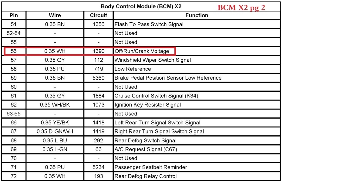

Okay, there's a lot of service information here, there are 4 BCM connectors and I have marked all the B+ power and ground wires that should be powered up and outputting power. There are also some BCM operations diagrams at the beginning there, so go through those and see how it operates in different modes; I would start by rechecking the areas where you worked, any wires and sections of harness that may have been moved around. It's very possible there are some loose pins in some connectors not making good contact, I don't see why the BCM would need to be replaced if it wasn't the original fault. The dealership is just trying to do that with hopes that replacing the module resolves the issue, but there are many power wires having to do with this module, I think you'll find power or a ground missing somewhere. The dealership shouldn't have charged almost a thousand dollars and not resolving anything. You may want to try a smaller shop that has a good reputation to take a look at it and give an honest diagnosis.

So sorry for the delay, it has been an extremely busy week, regarding these chassis and body grounds, make sure the actual ground wire's connection, so the connector crimped onto the wire itself is not over a painted section of the body, if the bolt used to hold that ground on does not conduct well the ground will make contact with the body but it may not carry current well. On body grounds I will grind off the paint in the small section where the connector washer is making contact. And when it comes to situations where there might only be one or two grounds that run to the body and engine block, those grounds need to be solid, most ECM/PCMs are grounded to the body, and the engine block to the body as well, so one ground that looks okay, but can't carry current will cause issues that can be misleading. If you think about how much current flow a starter pulls and see how large the main power wire to it is, all that current needs a ground just as large to make it back to the battery.
Something else that I see overlooked all the time is the battery terminals themselves. The cheap painted, wire bolt on terminals are only supposed to be used as a temporary fix. There is high voltage drop across those types of terminals when the electrical load is high.
You can do a voltage drop test when trying to crank the engine by going from B-(Batt Neg) to the engine block and B- to the body with a meter set on DC volts, you may be surprised to see a few volts on either the positive or negative side of the electrical system. But I see bad battery terminals quite often, even causing the wires going to the battery to overheat when the engine is running.

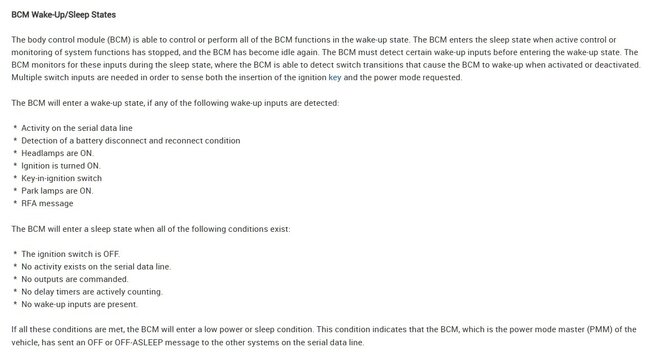

The theft light coming on a few seconds is okay, as long as it goes out. Same with the Check engine light, I think you're going to find that correcting all these grounds might take care of any power issues with the BCM, the GM BCMs do so much in these vehicles, with sending out wake up signals to other modules on the networks, they actually have the most functions of any module. So bad grounds are going to affect everything it powers up. Once you get done with cleaning and repairing the grounds, clear all the codes out, turn the key off for 30seconds or so, and see if any codes come back. If not and it cranks and starts, then you don't really need to check any BCM powers. This might all just be due to taking things apart and the grounds not making good contact afterwards.

You neighbor is correct, main power and grounds usually have a larger gauge wire as well as a larger pin inside the connector. But this all started when you were replacing the shift cables, and you noticed a corroded ground connection correct? There wasnt any other issues prior to this? And the problems started when the grounds were unbolted, cleaned and bolted back on. If thats the case, you may be over thinking all this, the BCM will set power codes if certain grounds are not making good contact, remember that a module needs good grounds just as much as it needs good power connections for current to flow back to its source. Pulling BCM connectors apart or even just disconnecting them can cause more issues that were not present before. When these connectors are plugged in at the factory for the first time, they make a solid contact, and the more they are unplugged and plugged back in, affects the pin tension. I have read service information on other vehicles which stated that module connectors (for the specific vehicle I was checking information on) were designed to only be disconnected once during the vehicle's life. Granted this is not the same vehicle, but the principle still applies. The more the harness or connectors are pulled on, the more the pin tension will be affected.
What point exactly are you at right now? Does the vehicle crank over and what codes are stored? If you have not tried starting the vehicle, and have the grounds cleaned and taken care of, try starting it. If it doesn't start or doesn't crank, then we know what you are currently dealing with.

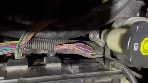

Another item a neighbor across from me had suggested. He had asked me where my battery was? I told him it was in the trunk. He asked if there were any additional wires other than the positive and negative terminals. I said there’s a 50 fuse that is connected and another device that is plastic and is circulating around the negative wire. There was only one video on YouTube that the guy mentioned if your cobalt doesn’t want to start. Check the wiring to that and said he found a short or corroded wire and got another one from a junk yard and his car started. I did take a look at and moved it but didn’t take off any tape. Perhaps I may have done something by moving that or the ecm plugs or the grounds I replaced and cleaned? Or all of the above. I think that device is the battery voltage? It sends out voltage and power to other parts of the vehicle?

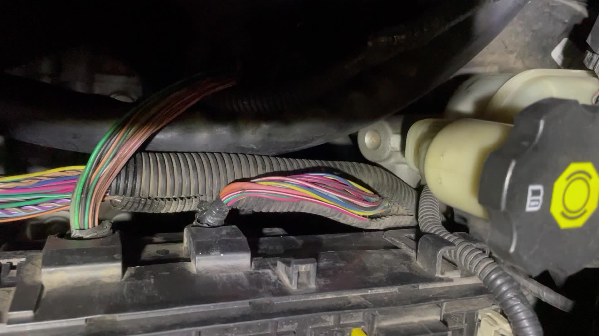

So I checked the wires and got the car to start but as I was driving luckily, I was close to the house when this happened, it had stalled/died. I turned the key and nothing on the instrument panel, so I got out move the wires around for the ECM, checked the ground wire on the chassis. That one seemed weird so I going to fix that and moved the harness by the starter. Did that two times and got the car to start. So, I have three places that I narrowed it down to. I tried looking up about the Battery Current Sensor that's in the trunk. The Red fuse is good and the scraped ends just to make sure. The wire and harness that I think either goes to the starter or the crankshaft positioning sensor. I know there was a wire i would move and that's when I heard the clicking noise but that doesn’t make that sound any more. Apparently, the wires come from the alternator and starter and positive battery in that area. That could be loose?
Mar 22, 2025 at 9:08 AM
AL514
  • 5,662 POSTS
The plastic device around the negative battery cable is the current sensor, thats how it reads current flow, the older ones look like an amp clamp around the cable, and they can be on a Lin bus network sending out data on the charging system. Its difficult to say which is possibly loose at this point, not knowing what has been moved around. Really the voltage needs to be measured at certain points, such as the starter if its not cranking right now, or if its cranking but not starting, it may be the wiring to the crank sensor if that has been messed with. But a visual inspection may not have any results, especially since the battery is in the trunk and all the cable has to run the length of the vehicle to get to the starter motor and engine/fuse boxes, etc. Getting a multimeter and testing the voltage levels will tell you if there are faulty connections between the battery and engine compartment.

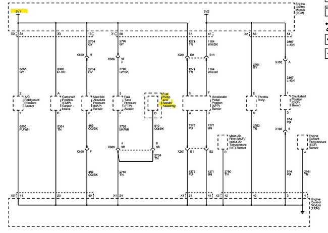

Still don’t have my speedometer or my gas gauge. But I still need to replace the gas tank vent sensor on the charcoal canister. Found underneath the fuse box where the wires have their own boxes they go into. The center of each of those boxes have a hole for the screw tightens on top and the bottom portion snaps into the bottom portion of the fuse box. When I didn’t find any broken wires and underneath where the wires go into nothing was broken or off. As I was putting it back together. I noticed the box that I found the short in wasn’t clicking into place. I took out the bottom portion of the box and saw that the wires were getting in the way for it to sit properly in the fuse box. Made sure the wires were out of the way and clicked in. Placed all boxes in and snapped it. Fuse portion box back on top and snugged the 7mm screws and the vehicle started. Was able to drive around and no stalling or shutting off on me. I at least got it to start. I noticed when I first drove it before the last time. My passenger side turn signal was rapid. The bulb was light just didn’t blink. Replaced fuse on #10 BCM fuse area. Still rapid blinker on instrument panel but front blinker remained on while rear blinked and hazards worked. After straightening out the fuse box situation. The front pass blinker wouldn’t blink and of course instrument panel blinked rapidly. Till later the same evening instrument panel blinked normally.

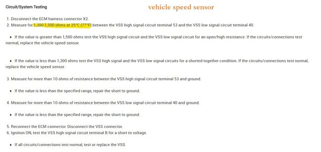

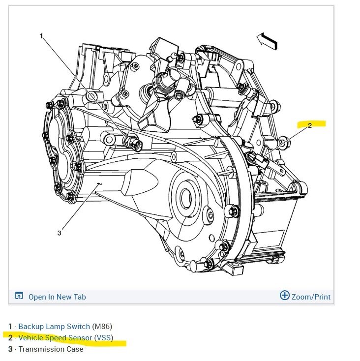

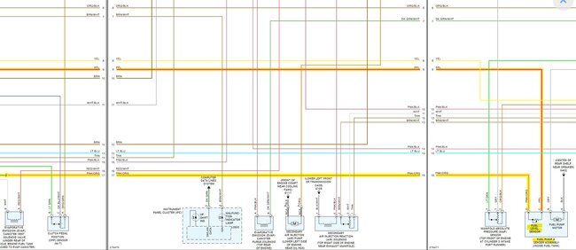

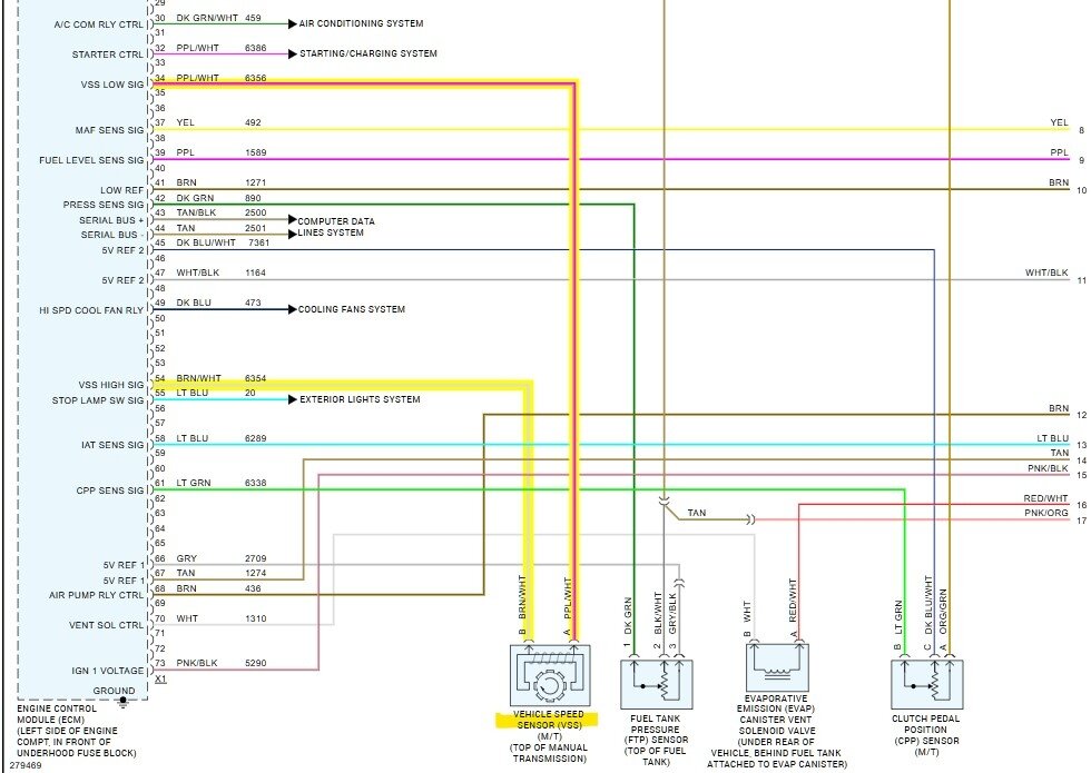

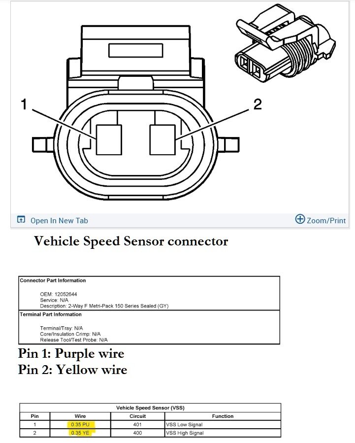

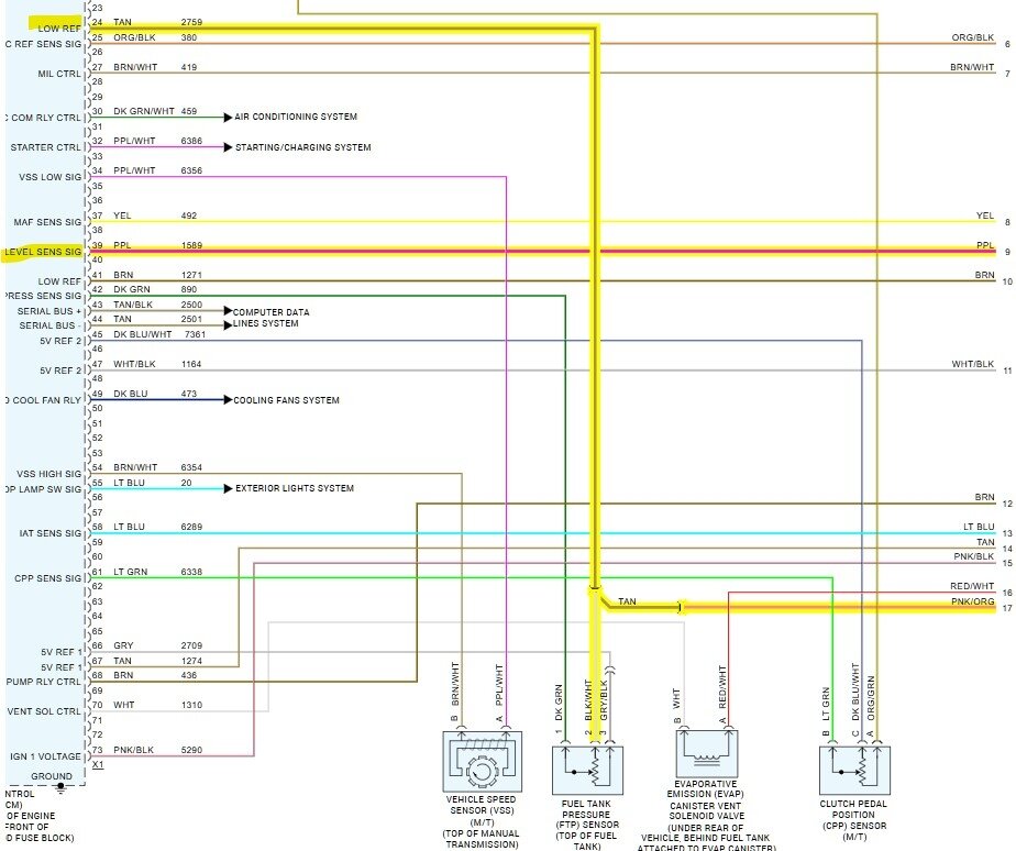

Sorry I had to read your posts again to catch up, been through a lot of vehicles lately, So, the dealership is returning most of what they previously charged you. But still no Speedometer and gas gauge? The fuel gauge code P0463 (Fuel Level Sensor circuit High Voltage) on the OEM wiring diagram shows the fuel level sensor is fed a 5volt reference and when the float on the sensor moves up and down as the fuel level does, the float is on an arm which changes the resistance in the circuit, and therefore changes the 5volts to a different level to indicate the fuel level. So, if the sensor is missing/open its ground (low reference) or the sensor is shorted to a power wire, it will read a high voltage level at the PCM.
As for the vehicle speed sensor code, there are some specs for checking the resistance of the speed sensor for the manual transmission, but the PCM pins they have listed for testing are not the same as what is shown in the aftermarket wiring diagram.
But it's possible the vehicle speed sensors wiring may have been affected when changing the shift cables, since the speed sensor is located on the transmission housing. With all the wiring harness movement you had posted about, it's difficult to say exactly where these wiring issues could be, but again going back to any areas where the harness was moved around and worked on, including the PCM connectors if they were disconnected, would be the first areas to check.
