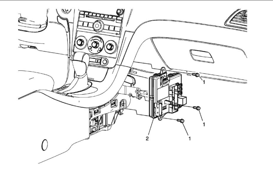

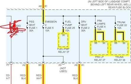

I have a BCM on the car listed above LT 2.4L that someone tried splicing a wire into fuse 19 (HVAC blower switch) and melted the plastic and blew the fuse which was the wrong size, 30A. It was supposed to have a 20A fuse.
Fuse 23 (HVAC ctl Batt) keeps blowing immediately after adding new fuse.
I don't get any power at fuse 19.
I want to know if I can remove the BCM without disconnecting the battery, so that I can remove the melted plastic and see if the circuit board has any blown components or shorts.
Do I have to disconnect the battery before remove the BCM?
If I disconnect the BCM, will it need reprogramming or code for radio?
Thanks in advance, Blake
Oct 15, 2020 at 8:48 PM
Good morning,

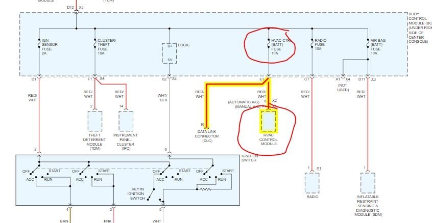

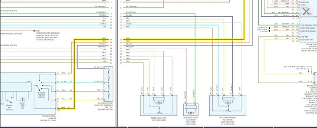

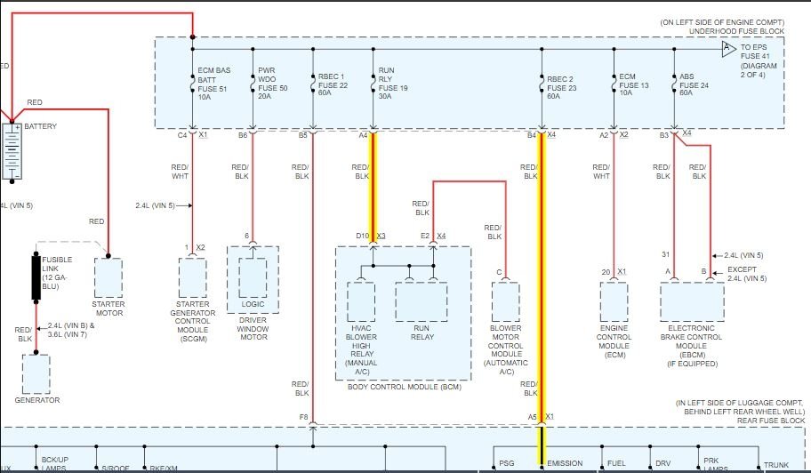

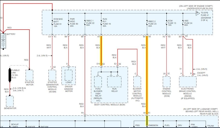

Fuse 19 should be 30 amps. I attached the diagram for you to view for the fuse and the control.
If you have no power to fuse 19, most likely the buss bar in the fuse box has failed. That will require replacing the fuse block.

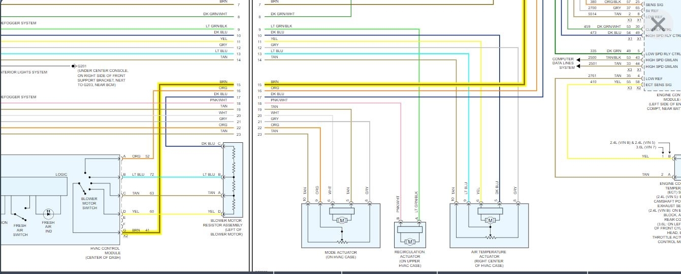

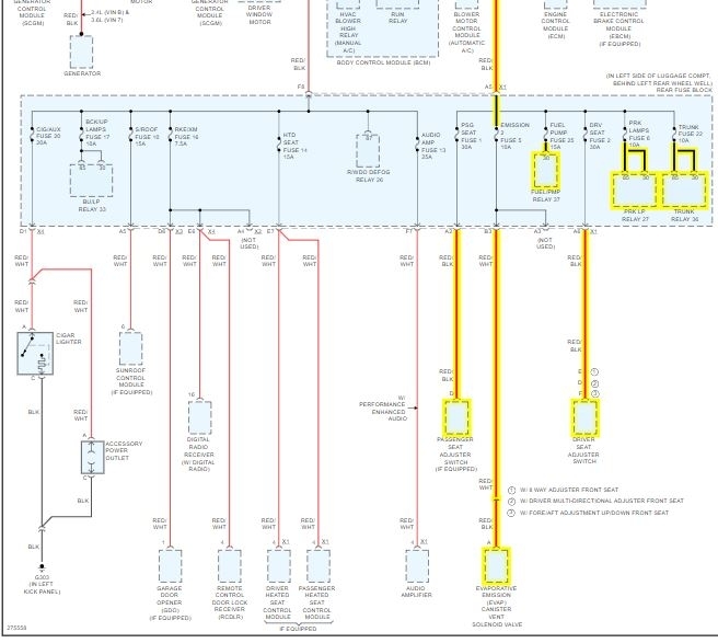

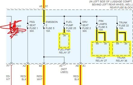

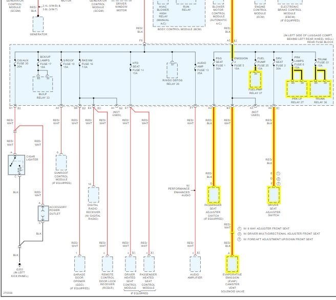

Fuse 23 sends power to many things in another fuse block. I attached those components as well. You will need to remove all the fuses controlled by the 23 and then install a new fuse and see if it still fails.

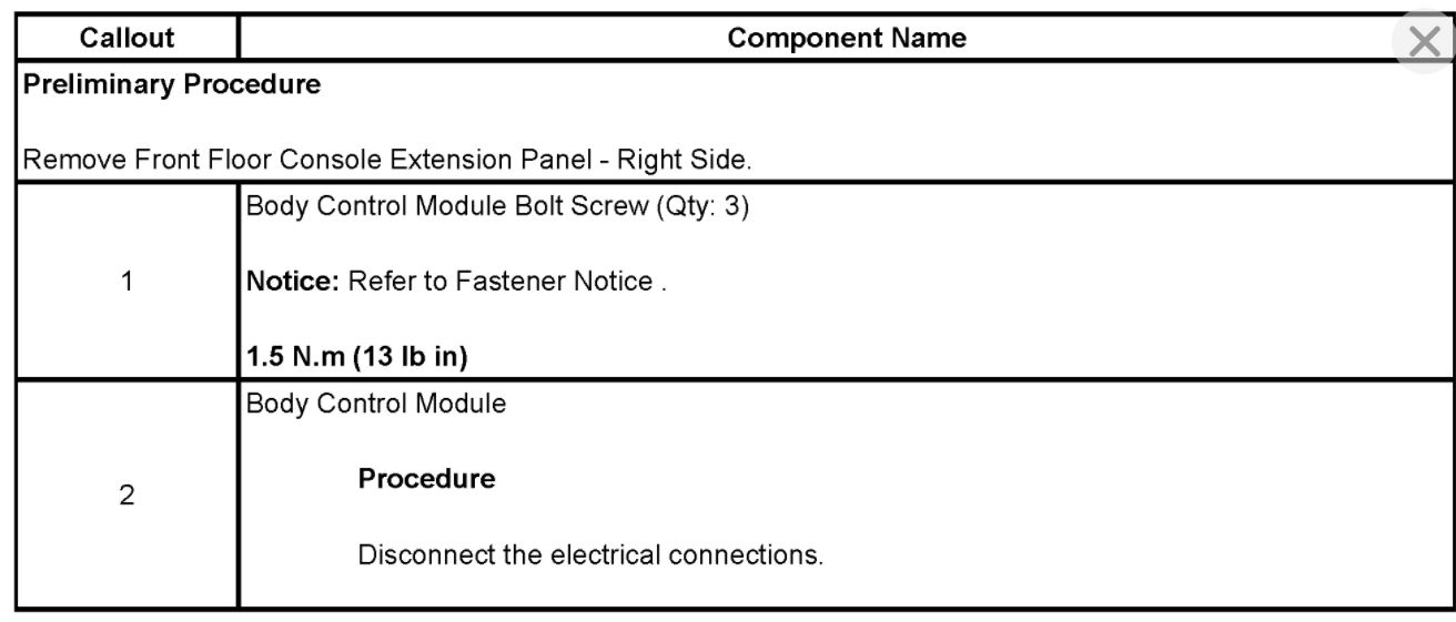

As far as the BCM, yes the cable has to be removed to remove it. I would just replace it and have it programmed. Yes, you will lose the radio and will have to enter the unlock code as well.

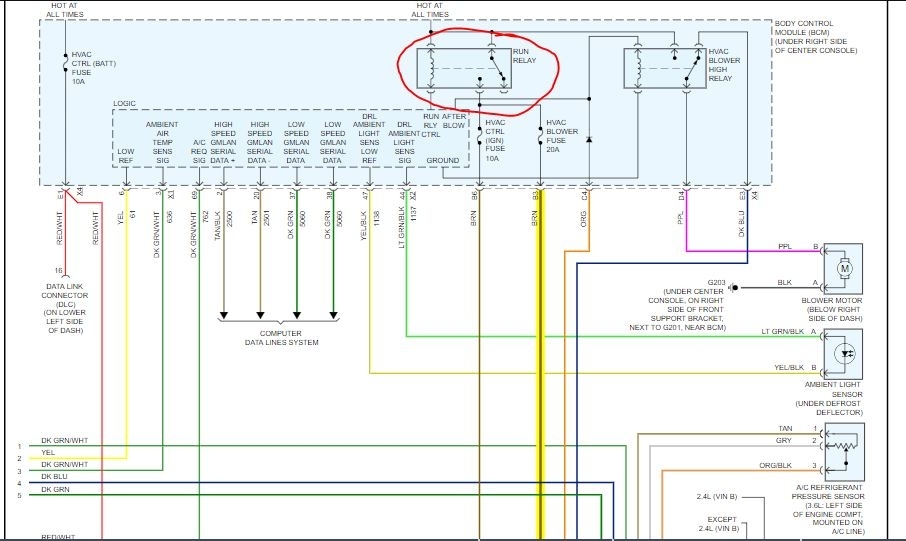

Okay, try disconnecting the HVAC module and see if the fuse still fails. All that should control is that module and power to pin 16 of the data link connector. If it does, you have a wiring issue between the fuse and the BCM.

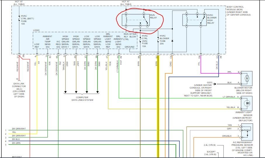

As far as power to 19, there is a run relay that supplies power to the fuse. I attached a diagram for you of that circuit. The run relay is part of the BCM itself and is not accessible for replacement. The BCM will have to be replaced.

I printed off all your wiring diagrams because they are slightly different than the ones I am using.
I will test all the connections you have high lighted and report back with my findings.
