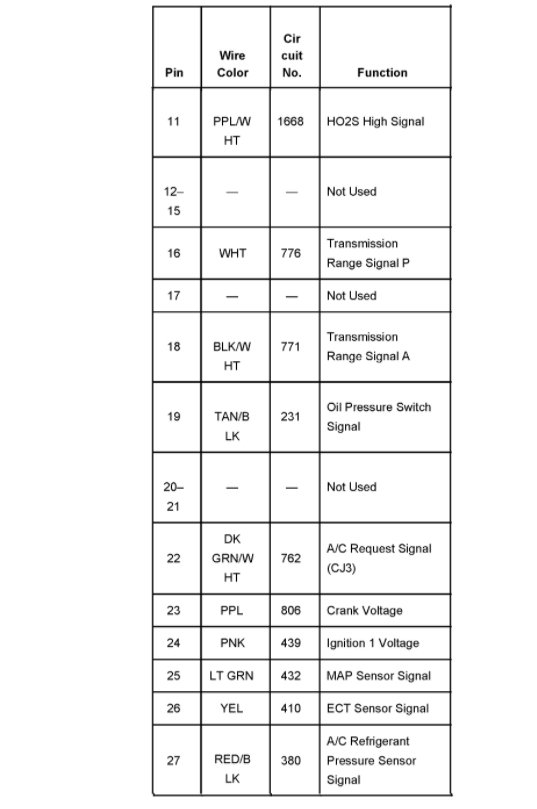

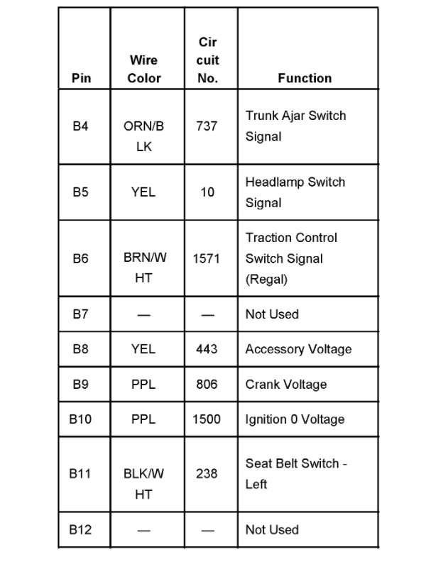

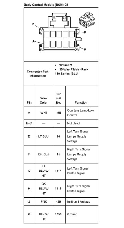

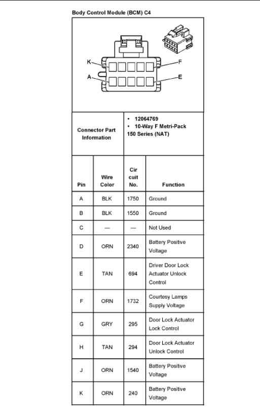

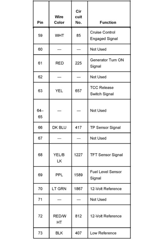

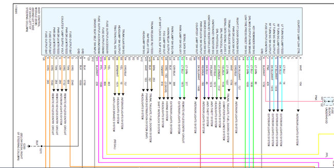

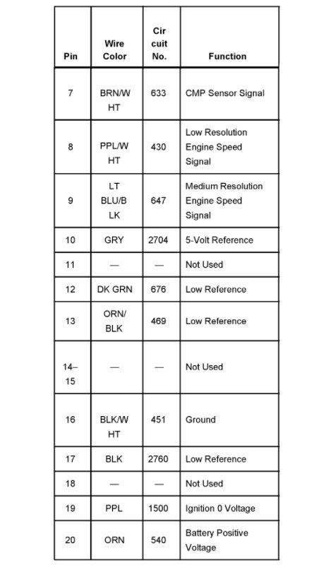

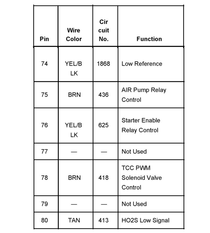

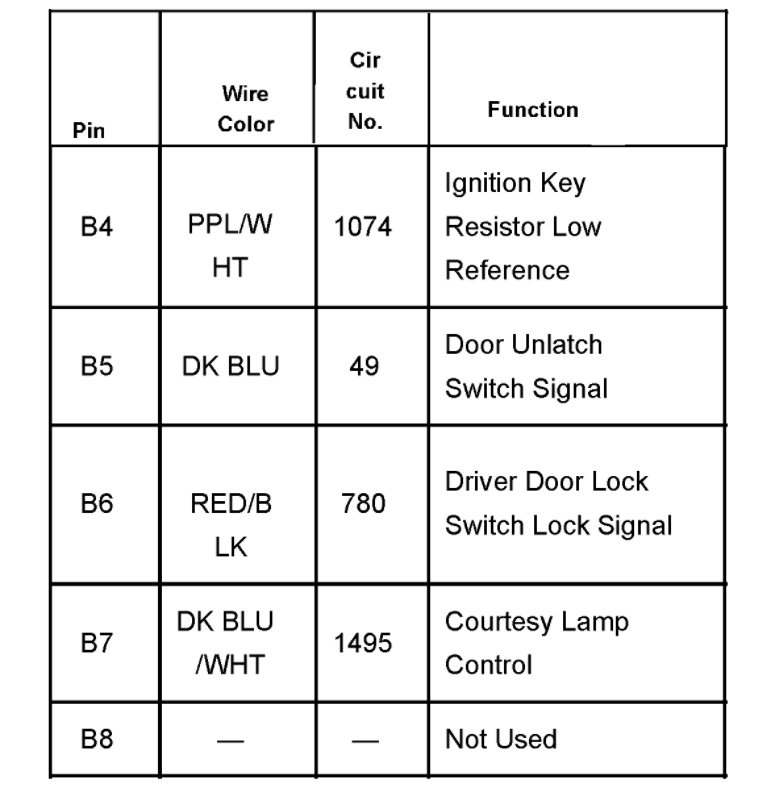

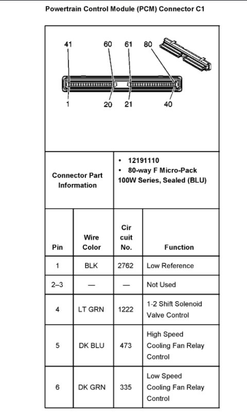

I’m looking for a wiring diagram/pinout of the BCM and PCM for the car listed above.
Dec 2, 2020 at 3:59 AM
Good evening,
I attached the pin outs for you of the ECM and the BCM as well.

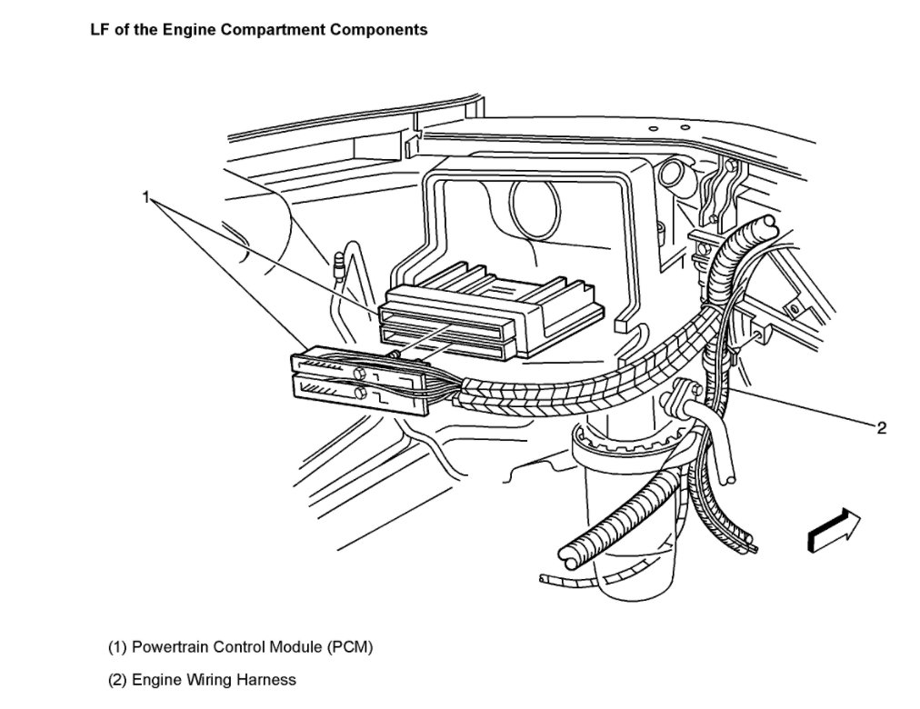

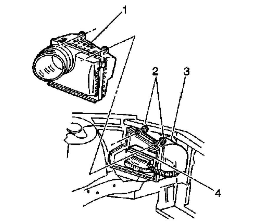

Removal Procedure
1. Disconnect the negative battery cable.
2. Remove the air cleaner housing cover assembly.
3. Without disconnecting the PCM connectors, remove the PCM (4) and the harness from the air cleaner housing.
4. Disconnect the PCM connectors and remove the PCM from the connectors.
Installation Procedure
NOTE: Refer to Fastener Notice in Service Precautions.
1. Install the PCM to the connectors.
Tighten
Tighten the connectors to 8 N.m (71 lb in).
2. Install the PCM (4) and the harness into the air cleaner housing.
3. Install the air cleaner housing cover assembly.
4. Connect the negative battery cable.
5. The new PCM must be programmed. Refer to Service Programming System (SPS) (Remote Procedure)Service Programming System (SPS) (Pass-Thru Procedure)Service Programming System (SPS) (Off Board Remote Procedure)Service Programming System (SPS) (Off Board Pass-Thru Procedure) in Programming. See: Vehicle > Programming and Relearning

Ignore the image, not sure what or where it came from.
