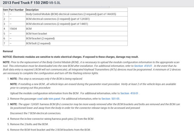

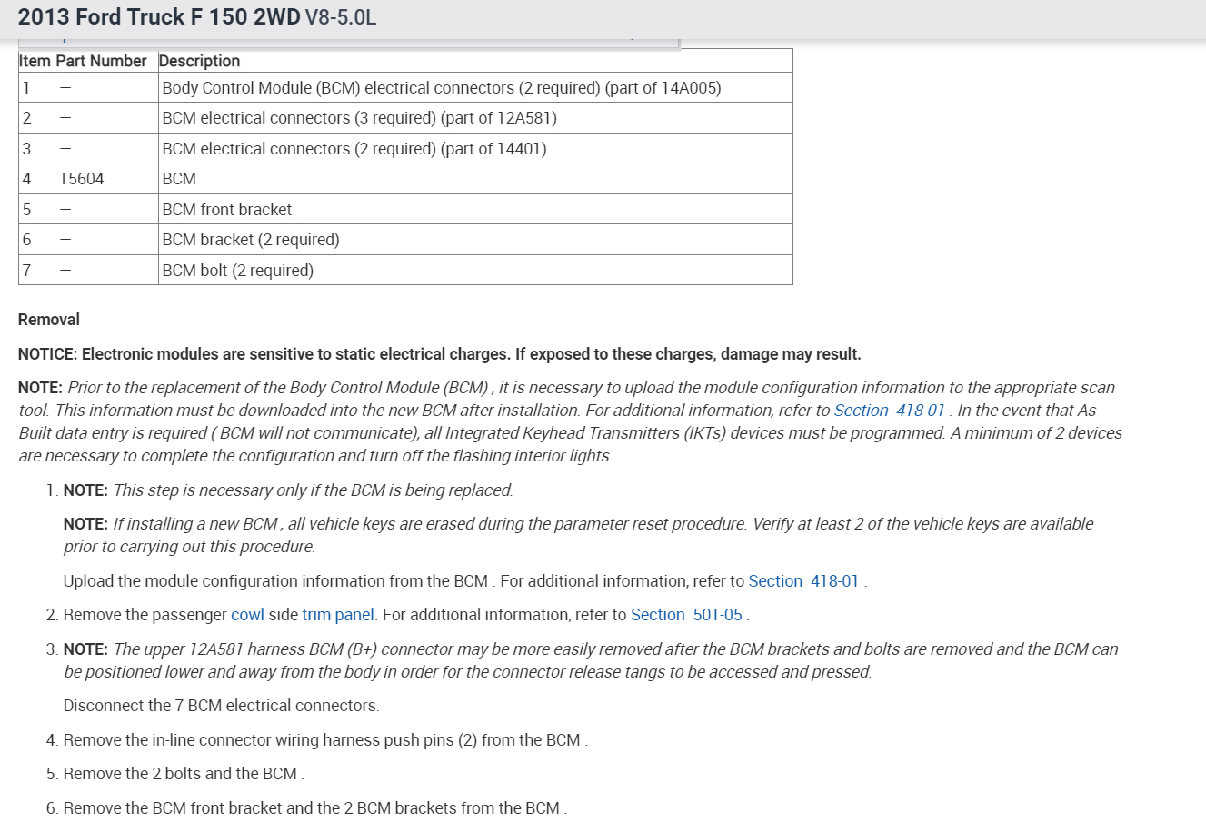

How do i find out the part number for the BCM without removing it?

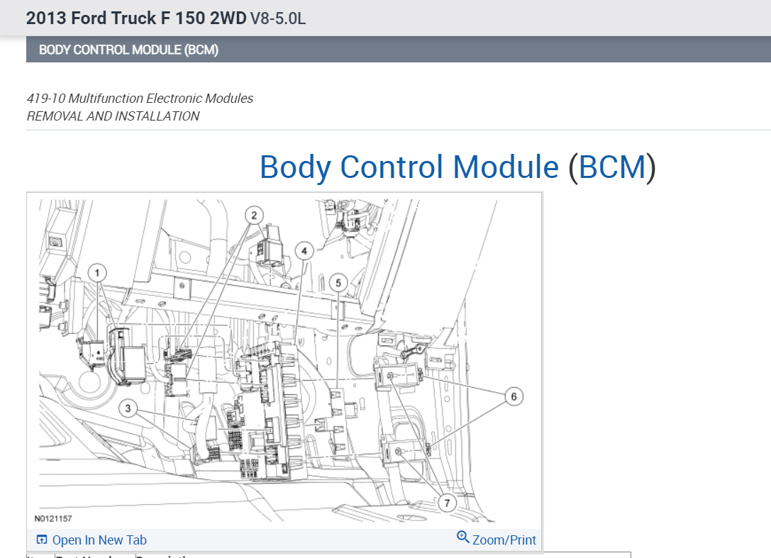

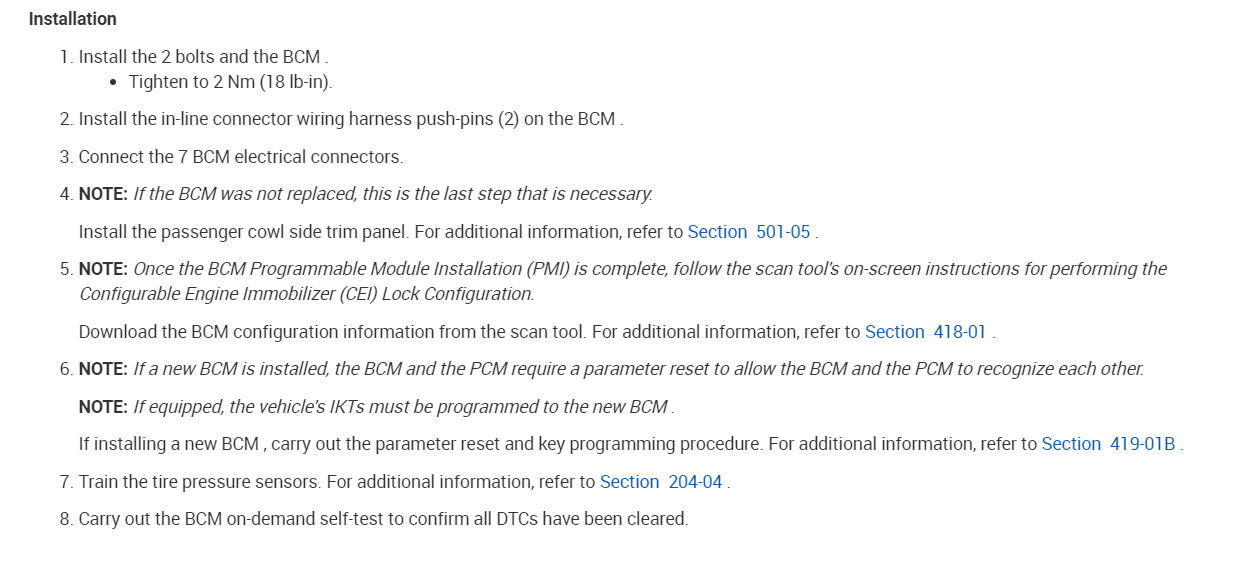

Here is the location and how to replace the BCM along with the part numbers. Check out the images (below). Please let us know if you need anything else to get the problem fixed.
