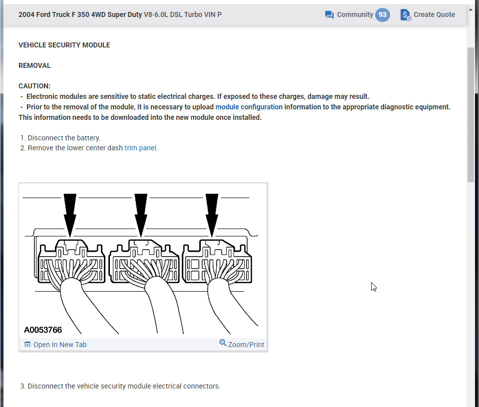

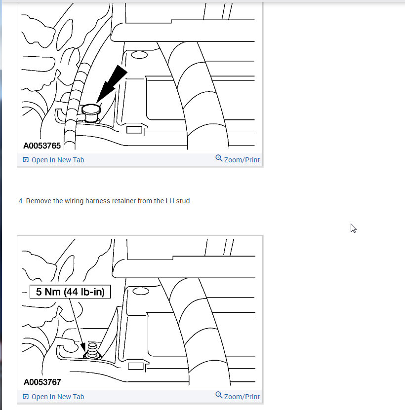

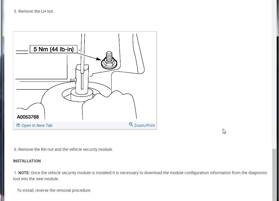

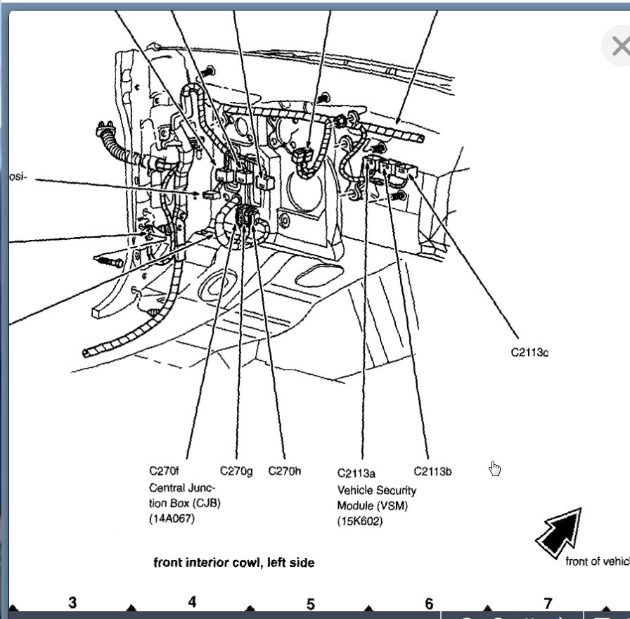

Where is the BCM located at in my truck listed above.
Saturday, May 22nd, 2021 AT 3:37 PM
MECHANIC
18,907 POSTS
On this vehicle it is called the Vehicle Security Module and is behind the glove box.
I attached the info below on how to replace it from the manual and its location.
Please let us know if you have other questions. Thanks
