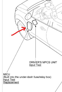

Bcm need to be replaced?
2011 ACURA MDX
191,000 MILES
GHOLSTON
Good morning I am having issues with my car continuing to give power to my Acura long after it has been turned off. I believe the BCM need to be replaced. I saw your your YouTube video about BCM and was hoping you could send me a diagram of it's location so I can replace it. Thank you.

This car does not have a BCM it has a MICU which does the same thing, it is located at the driver side front by the kick panel. I would try a hard system reboot first though they can fix problems by a simple reboot.
https://www.youtube.com/watch?v=INiDRO5A5MY
Check out the images (below). What problems are you having? Ken
