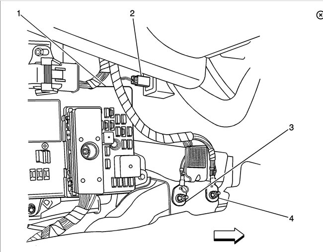

When I try to start car it won't do anything and error will pop up where it reads the milage.would that be the bcm
Aug 6, 2017 at 12:14 PM
  • 55,433 POSTS
It sure sounds like the BCM is bad, here is the location so you can get it fixed.
Here is its location (below).
