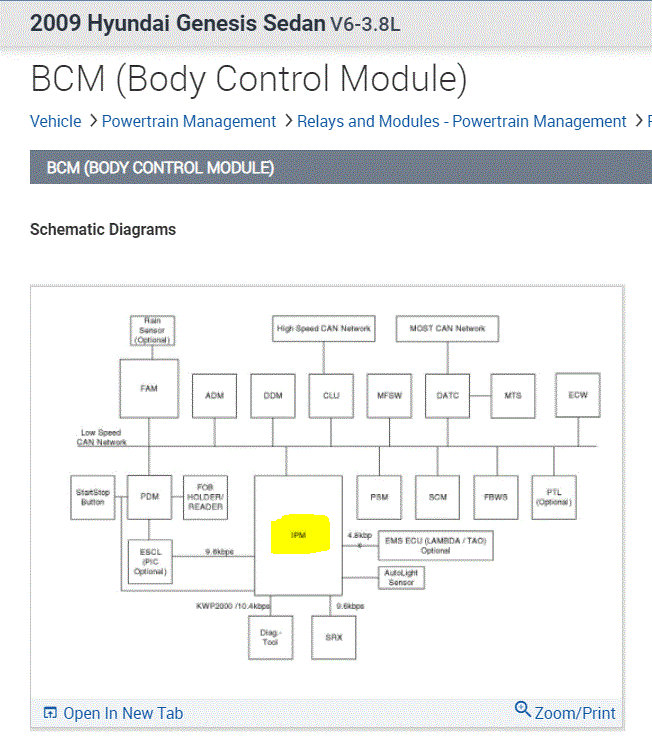

Hello, I need help finding BCM number on the car listed above. The VIN is KMHGC46E89U046824.

Based on the VIN, you have the V6. Is that correct? If so, the reason you are likely having trouble is that they refer to the BCM as the instrument panel module. See pic 1 below.
I suspect you are looking for part number 954003M022. However, I would like that confirmed with a dealer.
Let me know if that helps.
See pic below.

Thanks. I'm actually having trouble finding that part online. do I exactly need that part number, or can I use something close to it and they can program it?

VLONEXOZ
Could I use 954003M202?

I wouldn't recommend it. The parts are different internally and likely you won't be able to program it to your vehicle.
Take a look at this link:
https://www.wholesalehyundaiparts.com/p/Hyundai_2009_GENESIS/UNIT-ASSEMBLY---IPM/8621209/954003M022.html
