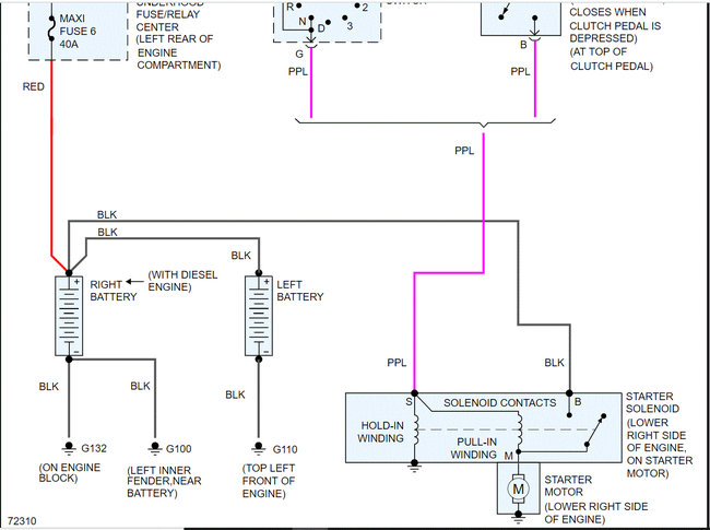

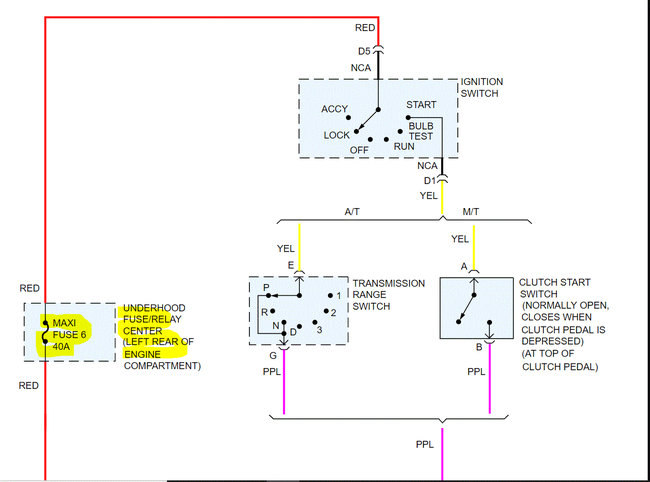

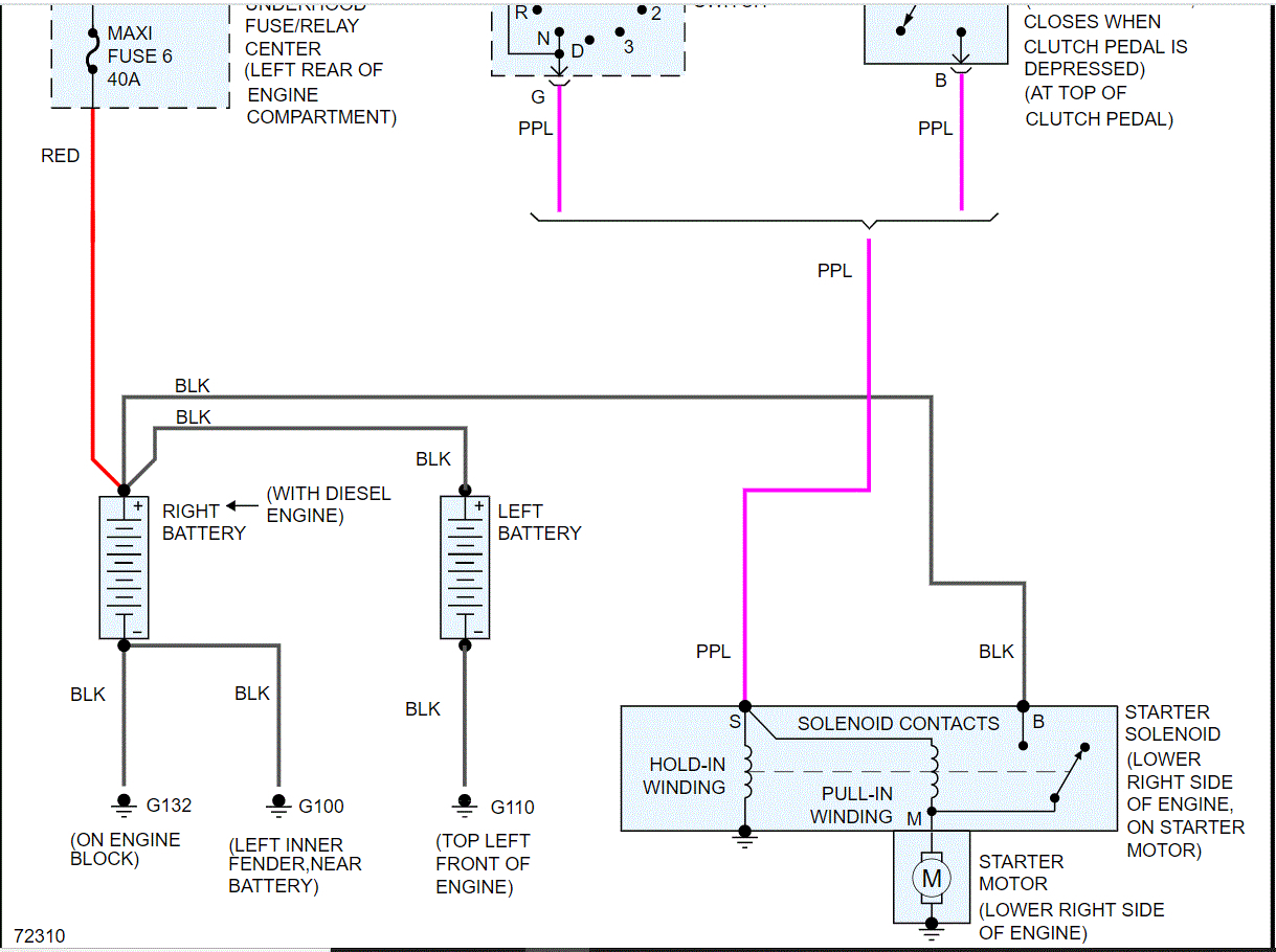

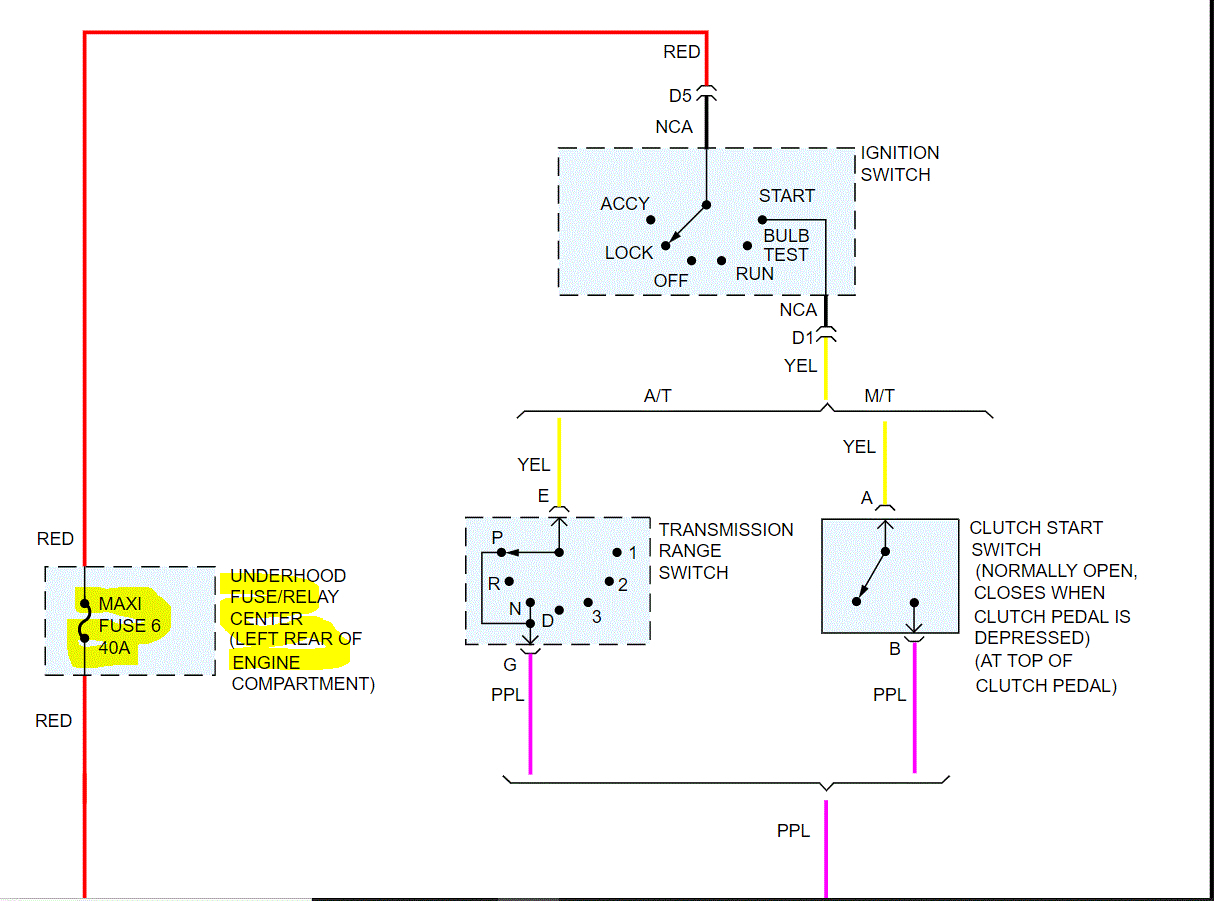

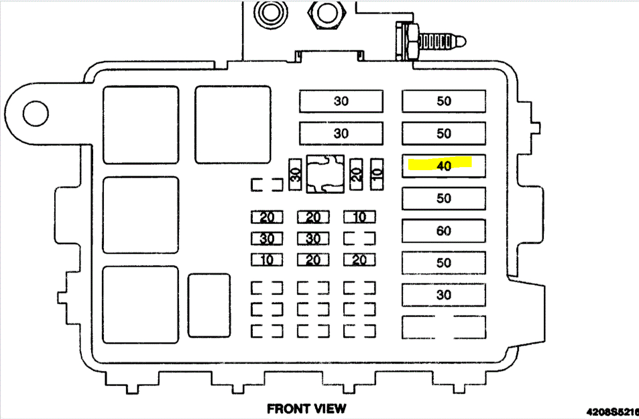

Since the starter won't engage, I need you to start by checking mega fuse 6 in the under hood power box. See pic 3 below.
Also, pics 1 and 2 show the entire wiring schematic for the starting system. You can use this as a reference.
When checking the fuse, confirm there is both power to it and from it. Here is a link you may find helpful:
