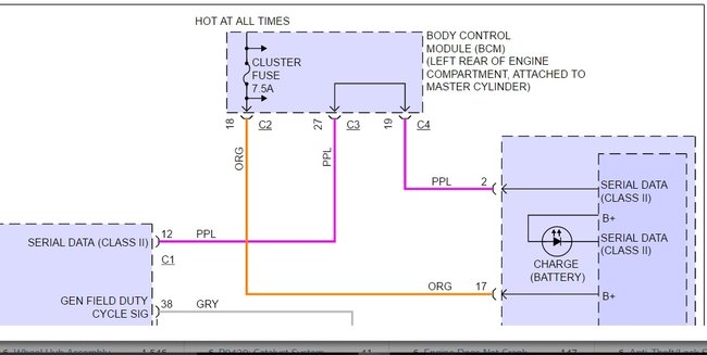

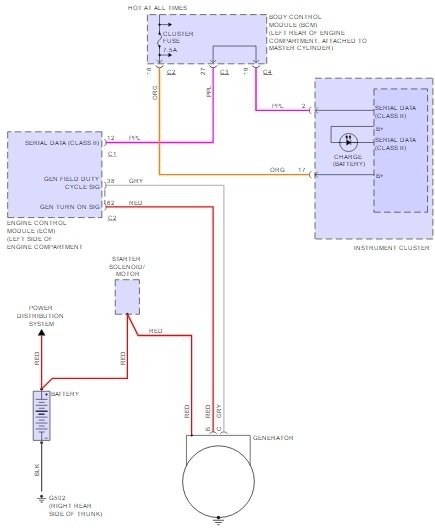

CJ MEDEVAC
  • 11,000 POSTS
Hate to do this to you SATURNTECH9
I found a diagram (without more information, I punched in "Ion 1" during my search- It may be the same one for the 2-3-4-5-6-7 LOL! It may not be the right diagram)
I will try again if it is wrong.
Two pictures below:
1) full diagram
2) same diagram with top portion enlarged
Even with a good battery and alternator, if somewhere in between them is open or broken, the battery will not get a charge.
I was looking to find a fusible link in the diagram, but none are shown, I guess Saturn does not use them.
There is a fuse up top in the diagram (check it!)
Other than that, follow the wires in Mr. Diagram and look for something disconnected, loose corroded, etc.
SATURNTECH9, I figured, once again, that the better looking of our bunch should present the diagram information.
Keep us posted
The Medic

SATURNTECH9
  • 30,868 POSTS
I have seen the cluster go bad and cause this issue. I would try a used unit.
Aug 20, 2016 at 6:36 AM
VARREY
  • 0 POST
Get a rebuilt cluster cost me $143.00. fixed the car,
