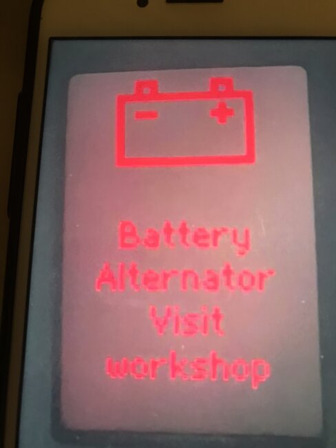

Hi dear,
I had battery alternator warning light, and it was voltage regulator problem. I couldn’t find one, so I bought a new alternator. Two weeks after installing the new one the warning light comes on for seconds and sometime for minutes and goes off. It does it three or four times daily.
I hope I was clear thank you.

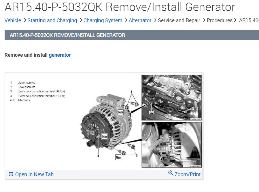

Yep, it sounds like you have a defective alternator. Can I ask which brand it is? To help confirm the issue of when the warning light is on let's use a voltmeter is see if it charging or not?
This guide can help:

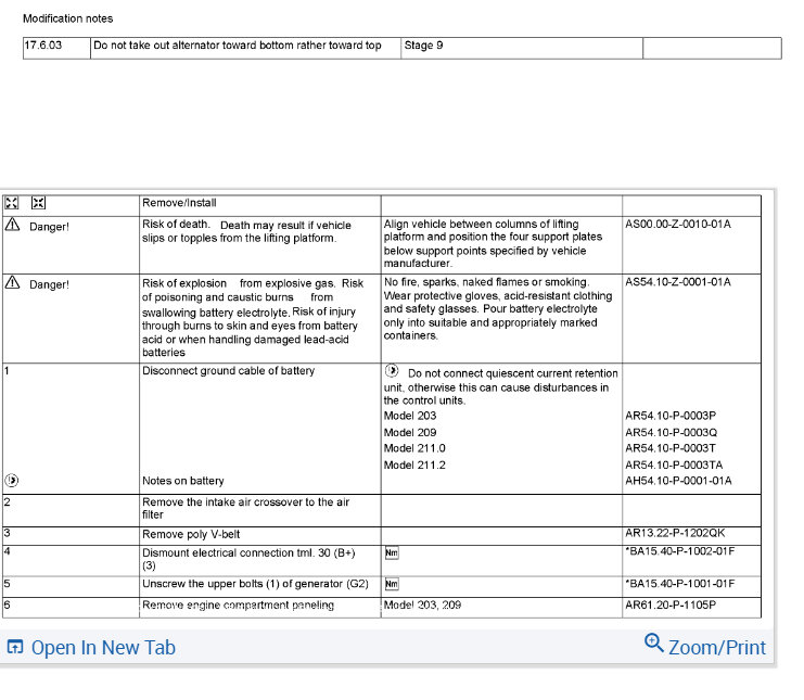

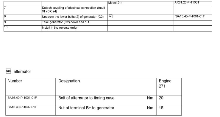

Here is the correct way to replace the alternator in case you need it. Check out the images (below). Please let us know how it goes.
