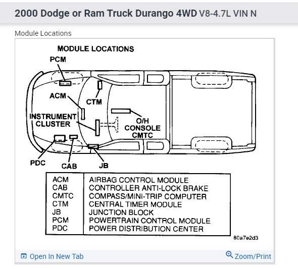

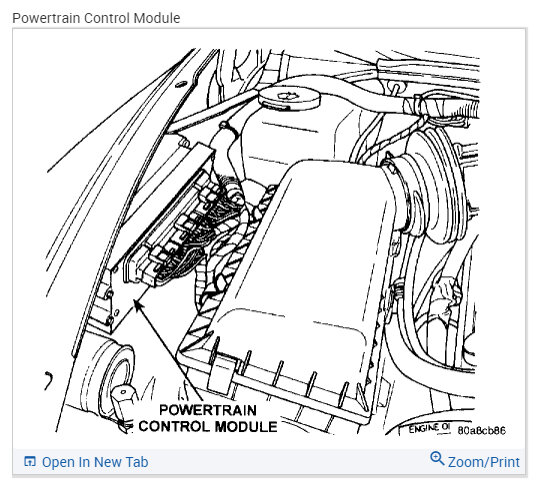

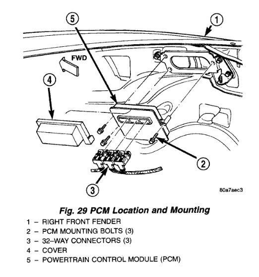

  • 110,240 POSTS
If the alternator isn't charging, the PCM is the likely problem. On most vehicles, the voltage regulator that controls the alternator is integral. On this vehicle, the voltage is regulated by the powertrain control module (PCM).
I mentioned above that either it would be the alternator or the PCM. If you want to confirm that, remove the alternator and have it bench-tested by the parts store. If it is good, the PCM is the likely cause.

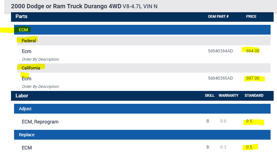

So, we have two ways you can repair this. First, you can have a shop or dealer sell you a new PCM and then charge you to program it to your vehicle. That will be somewhat expensive to have done. Or you can purchase a remanufactured PCM online that is plug-and-play. They will need your VIN number and when you install the new PCM, you will need to send back the old one. As I mentioned, I've gone this way and have been very happy with the results. Simply, disconnect the negative battery terminal, remove and install the new PCM and it's done. Just make sure you are getting one that is already programmed.
I have done this on my personal vehicles simply due to the cost. The last one I did was on a Dakota and the remanufactured part was 129.00. I know that's a lot, but to go the other way would likely be close to 1000.00.
If you look at the pics below, it shows the location and removal procedure for the PCM. The very last pic shows the parts and labor if you go with a new one.
Let me know your thoughts. Also, when I read back through the thread, I noticed that when I indicated it could be the alt or PCM, you took it to a parts store, and they scanned the computer. They needed to test the charging system. That's why you were unaware.
Let me know what you decide and what I can do to help.
