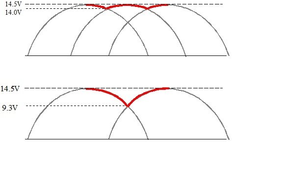

I made this drawing to show ripple voltage. On the top waveform, each of the three phases takes a turn at producing some output voltage and current. The voltage is shown here. The difference between the highest and the lowest voltage developed is only 0.5 volts. With one dead phase in the lower waveform, ripple voltage is 5.2 volts, along with the full-load output current test only being able to develop one third of the generator's rated current. Besides not meeting the needs of the entire electrical system, a clue to this condition is an irritating whine on AM radio that changes pitch with changes in engine speed.
With the missing phase, and the generator's inability to keep up with demand, system voltage will drop, and be much more noticeable at idle. You'll see that as the head lights changing brightness along with the gauge reading going up and down as you change engine speed. This will show up on the voltmeter too if you measure battery voltage while a helper changes engine speed.
