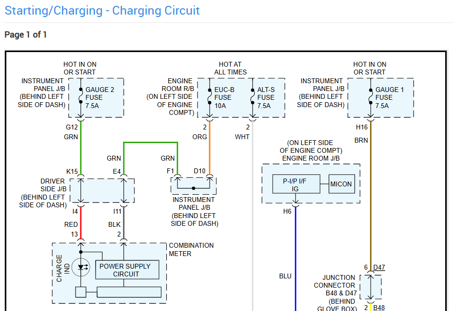

Battery light came on so I suspected it was a connector shortly after that the terminal started turning black, so I went on to recharge the battery, replace 5 grounding points, got a new alternator, and the battery light continues to stay on, what could this be?

Lets see if the alternator is charging, also, when you say 5 new grounds what do you mean? Can you send an image? Also, make sure the battery ground to the chassis and the engine block are good.
Here is a guide to help:

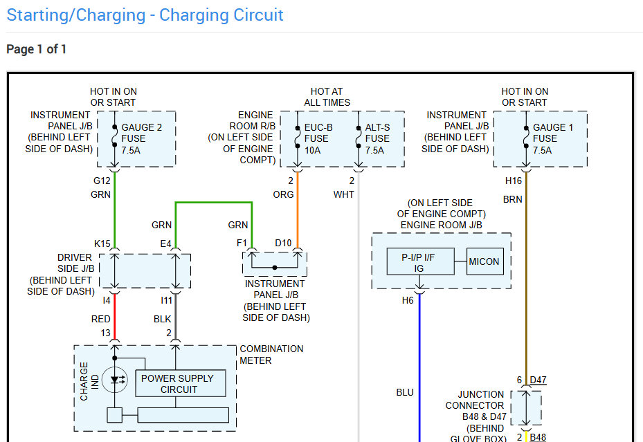

Also, check these fuses, check out the images (below). Please let us know what happens.
