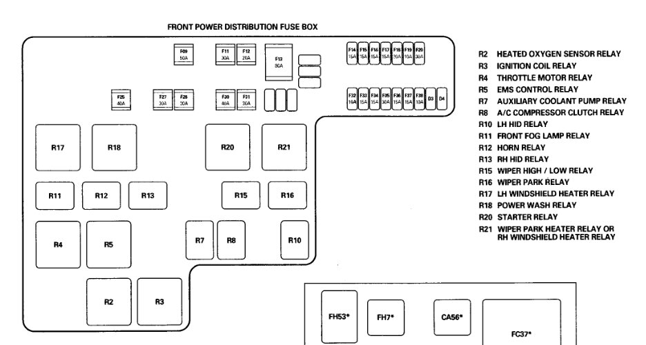

Good day,
The car battery was dead and I was jump starting it, but I made a mistake and put the negative on the positive and that caused a spark to happen. Do you think that this can cause any damage to the vehicle and prevent it from moving?
The emergency park brake is not working as well.
Do you know where torque converter clutch solenoid /stuck off is located?
Thank you for a speedy response.
Jul 28, 2024 at 5:35 PM
  • 54,840 POSTS

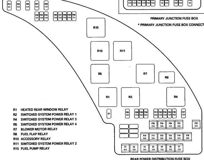

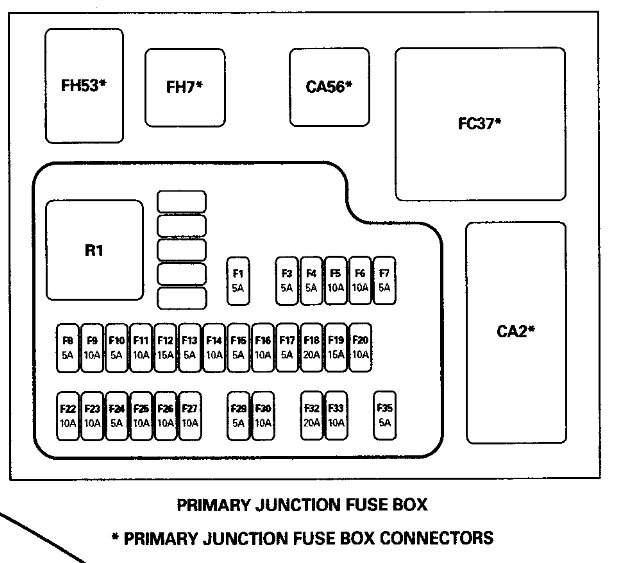

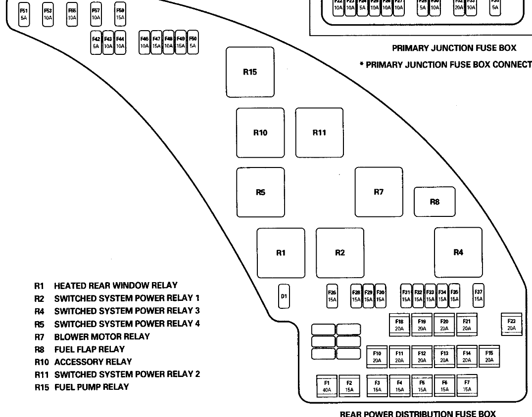

Oh ya, the reverse polarity connection will cause problems, the first thing I would do is check all fuses. here is a guide to help and the fuse location in the diagrams below:
Also, this guide can help go over additional problems you can help when the polarity is reversed:
https://www.2carpros.com/articles/resolving-reverse-battery-connection-in-cars-a-step-by-step-repair-guide
Check out the images (below). Let us know how it goes.
