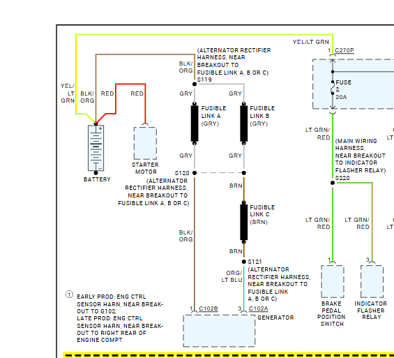

Battery cable harness replacement I replaced battery cable harness and don't remember where the fuse on battery are connected to also I just subscribed to your channel and having trouble logging in so I uses the free question on your app

I can help you, the site is new so can I ask how you tried to login, through facebook? Here is the wiring diagram for the positive side f the battery so you can see which wires connect to it. Please upload a short video in your response of the problem, so I can see what's going on. Check out the images (below).
