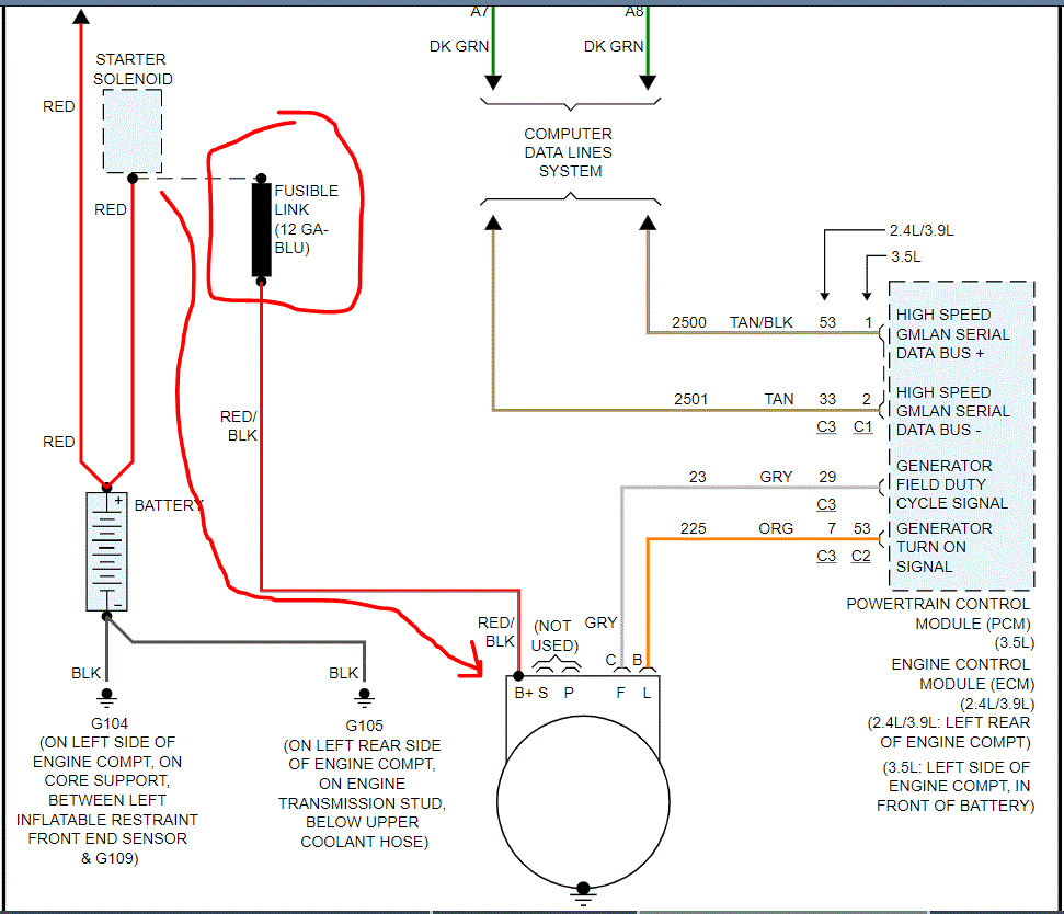

I realize the subject heading is a bit too long, but that's the gist of the issue with this car. It appears the Alternator-Voltage Regulator on this car has its way to the battery through the B (Hot) Terminal on the Starter. The F-Generator seems to have the biggest saying in whether the Run/Start/Ignition process takes place. There were problems in the Junction Block (which I have replaced). The Battery is fully charged. The Computer Modules are all functional (BCM/PCM/ECM). The Alternator is new. The Starter is operable. The B Stud on the Starter Solenoid felt unstable as I was replacing the Battery Cable. This is a junction at which the Generator connects to the Battery. If I am not mistaken, this junction is causing intermittent and starting problem (I no longer want to jump start the starter. I know it will start). I tired to understand the sequence of how the F-Generator okays the initial process along with the rest of the starting and charging system (including the role of the relays, fuses and the Modules), If this Nut-Stud (which holds the Battery Cable and the Generator's Cable to the Solenoid ) is compromised, the entire system will malfunction. I have the diagrams explaining how the system circuitry works. The question I have can you elaborate on the role of the F-Generator as it relates to this circuitry taking care to explain the exact sequence of events around this component. Can the Modules pick up on this kind of a problem when the B stud-nut is compromised but only causing intermittent issues?

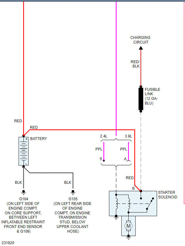

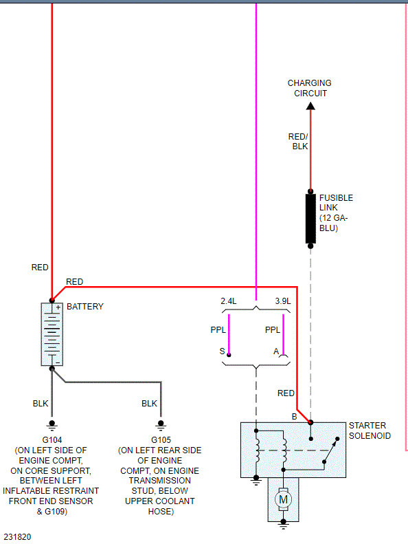

I think I understand what you are asking, so please bear with me.
The B terminal on the starter receives 12v constantly from the battery, but is an open circuit until the smaller (purple wire) receives 12v when the key is in the start position. In other words, there is no connection until the key is turned to start and then the circuit is closed and the starter is engaged.
Now, I am not sure what you meant by the B post on the starter feeling unstable. It should be tight. If it is loose, that is the problem. It may only be making contact randomly.
As far as the alternator is concerned, power from the B terminal on the starter is jumped to the alternator. If is done via a fusible link. A fusible link looks like a regular wire, but it functions as a fuse. You should have 12v all the time at the alternator via that wire. If you don't, you need to check the fusible link for continuity. If may need replaced.
I attached a couple pics below. The first one shows the starter and wiring from it. If you look at pic 2, it shows the alternator and wiring from the starter B terminal.
Please explain specifically what is happening. I should be able to point you in the right directions. Also, if the B terminal on the starter is loose, disconnect the battery and remove and replace the starter. Something isn't right.

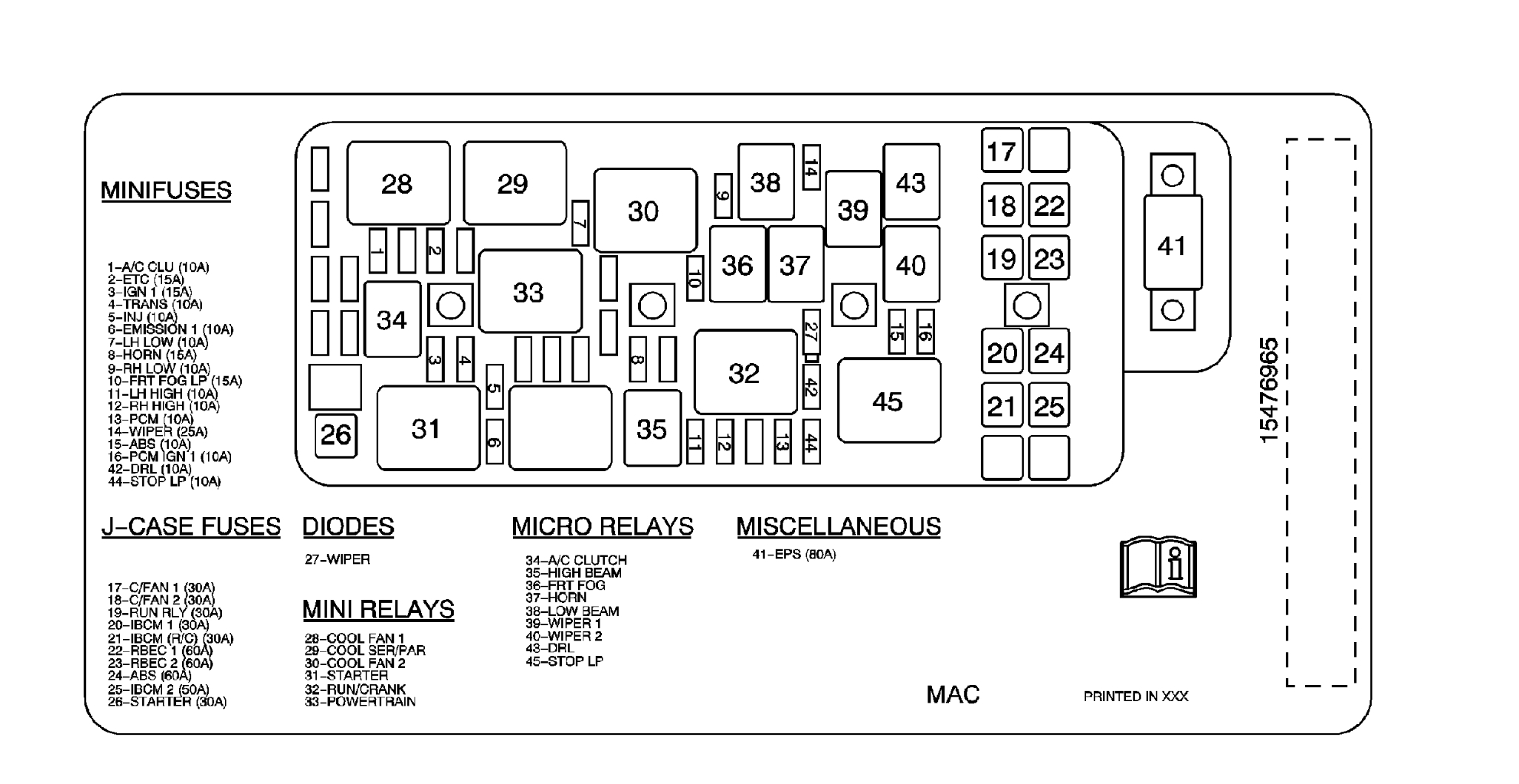

Have you replaced the starter relay?
For an intermittent problem i would advise replacing this as is inexpensive and easily replaced.
The starter relay is in the under hood fuse box. I have attached a diagram for the location.

Yes, all the components are functional. I noticed the b terminal on the solenoid is kind of loose (it has 2 wires attached to it: the battery positive and the wire going to the voltage regulator-alternator (what i asked about) which is the only path the alternator has to the battery in the GTP g6 2006 3.9 4-door model). It is as if everything is fine but the starter solenoid b terminal stud is partly broken inside the solenoid..possible...weird? When i test the voltage on it, i get 12.7 but the battery cable is sitting on it and it does not tell me anything about its condition inside the solenoid. I am also getting 12.7 at the trigger terminal which is a switch-connector purple line that goes up to the 87 pin on the stater relay). I hear a click coming from the starter solenoid when my sister attempts to start the car. What i have not been able to do is jump the starter- this g6 3.9 starter has its s trigger terminal housed inside a switch-connector, not to mention i do see how people jump the b solenoid terminal (a 10 gauge wire with several hundred amps) to the s terminal (almost 18 or 20 gauge wire that can't handle the amperage). I see people doing dangerous stuff with solenoid-starter. i am not wanting to do that. But maybe there is a safe way to test the connection between the solenoid b and the solenoid s (and then there is the m that is very large and exposed connecting the solenoid to the starter itself).
Feb 12, 2020 at 7:45 PM
  • 110,194 POSTS
If the B post is loose, that is what is causing the starter issues. If you have voltage to the smaller (s terminal) purple wire when the key is in the start position and 12v to the B terminal and the starter fails, the starter is bad. In this case, it sounds like it's caused by a faulty B terminal.

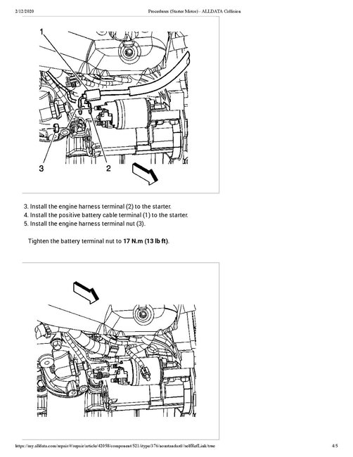

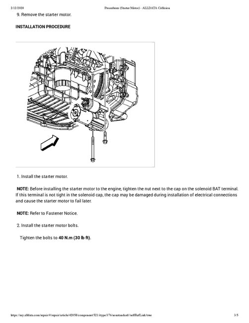

I would second what JACOBANDNICKOLAS said previously and replace the starter if you have power at the solenoid feed, it clicks and does not start generally the motor is bad.
I would also advise testing the starter ground circuit.
When the non start occurs test for voltage between the body of the starter motor and the negative battery post whilst attempting to start. Ideally you should have no more than 0.2V drop here.
If the ground checks out okay then replace the motor and retest.

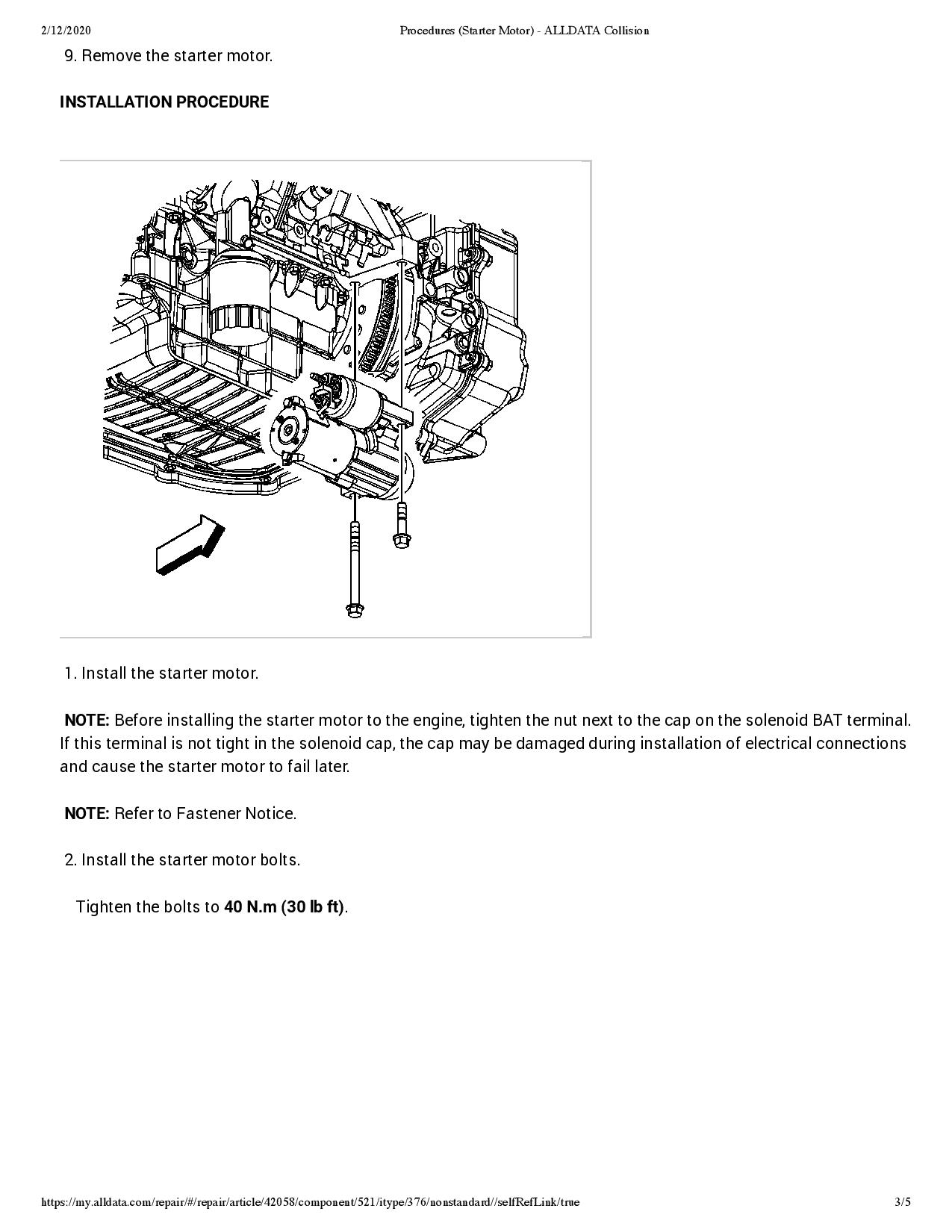

Be careful when installing the new starter and tightening down the terminals.

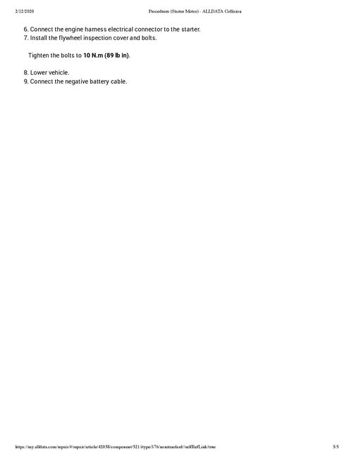

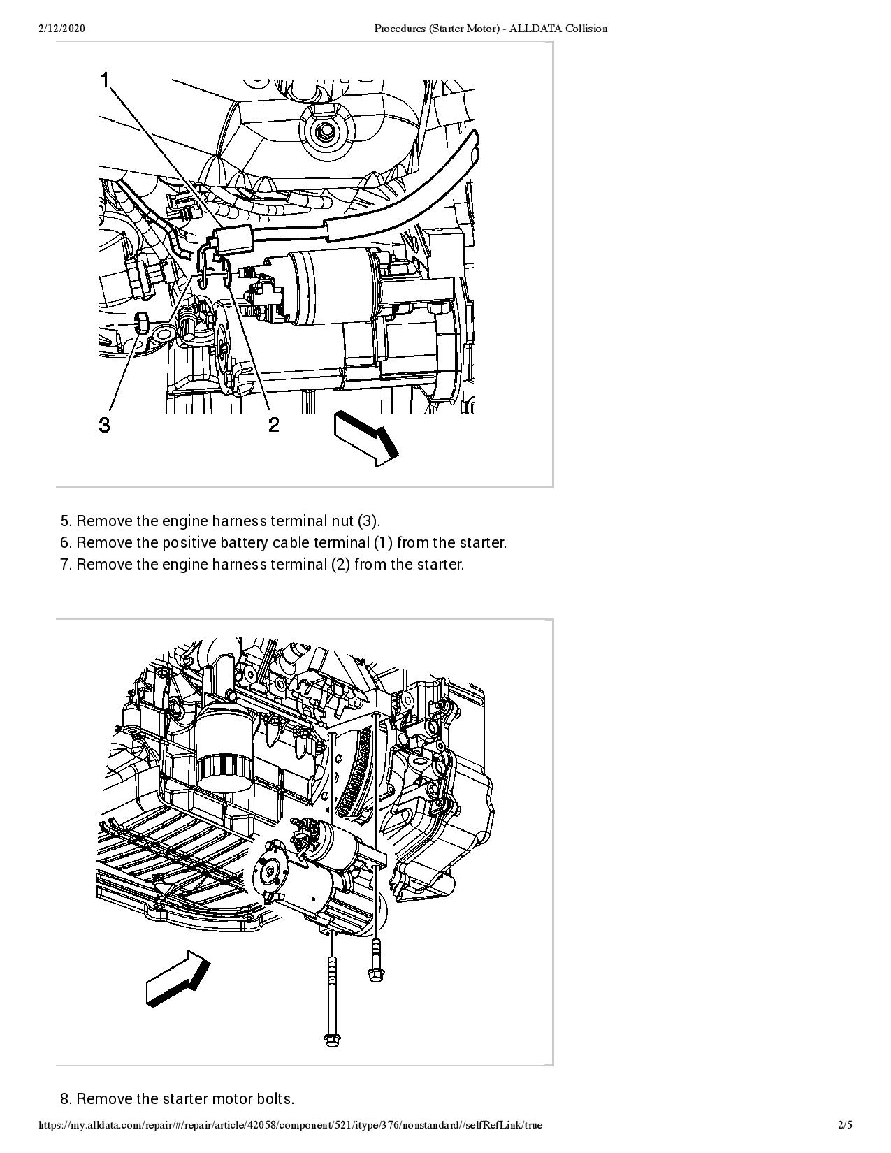

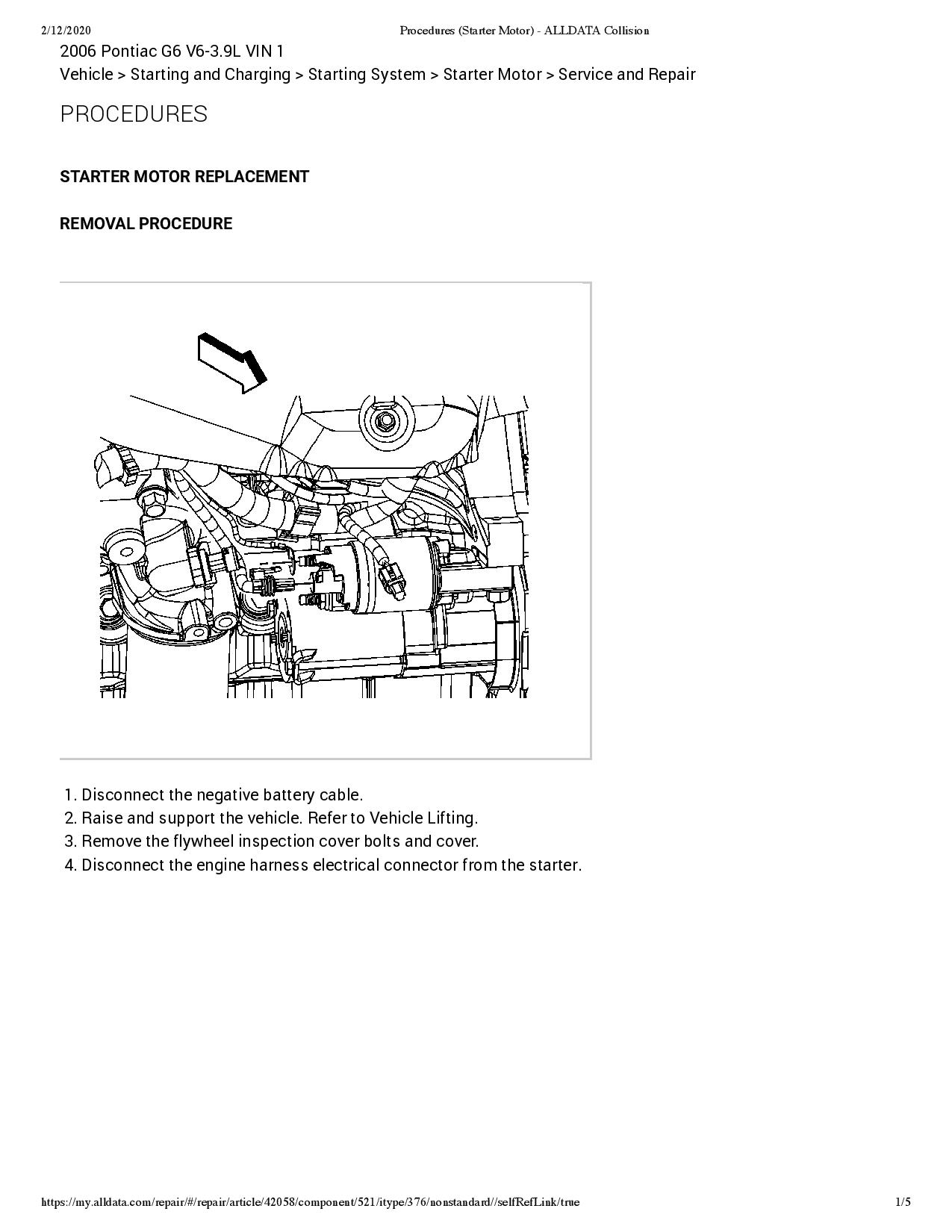

I have attached the instructions for replacing the starter motor.

When i say be careful when installing the new starter i was referencing not over-tightening the wiring connections.
It is a relatively simple repair, you don't need to worry about the meshing of the starter gear as long as the starter is installed fully and tightened down evenly.
