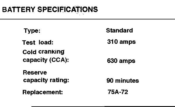

What is the recommended cold cranking amps for the car listed above?
Jan 26, 2019 at 11:31 AM
SCGRANTURISMO
  • 4,897 POSTS
Hi Blueeyes77, my name is Alex and I will be helping you today. The recommended group size battery for your car is Group size 78 with 770 minimum Cold Cranking Amps.

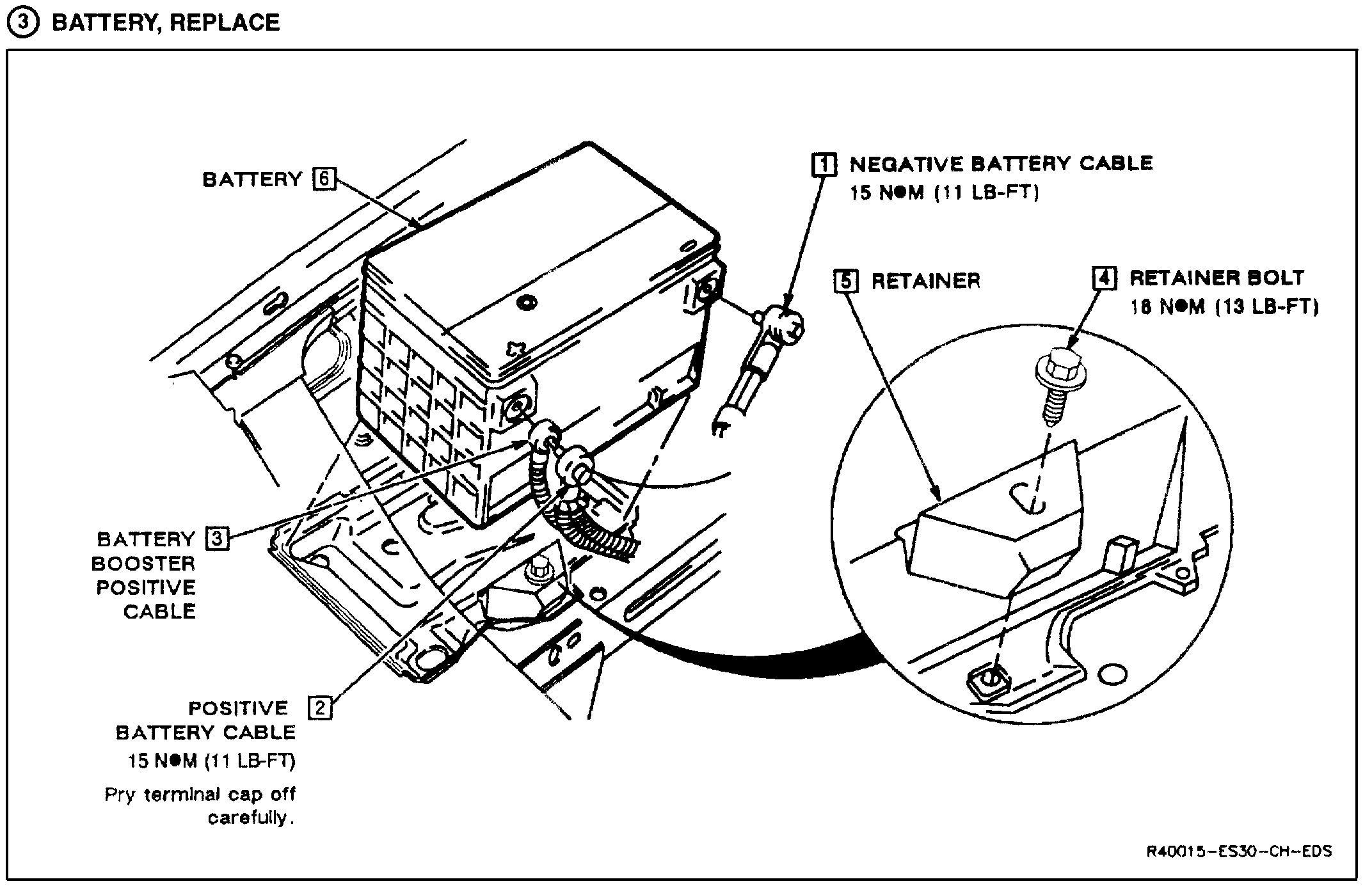

I attached the manufacturer's recommendations in picture 1. Picture 2 shows replacement procedure. The procedure is listed in numerical order, 1- 6
Here is a link that shows how it's done:
https://www.2carpros.com/articles/how-to-replace-a-car-battery
