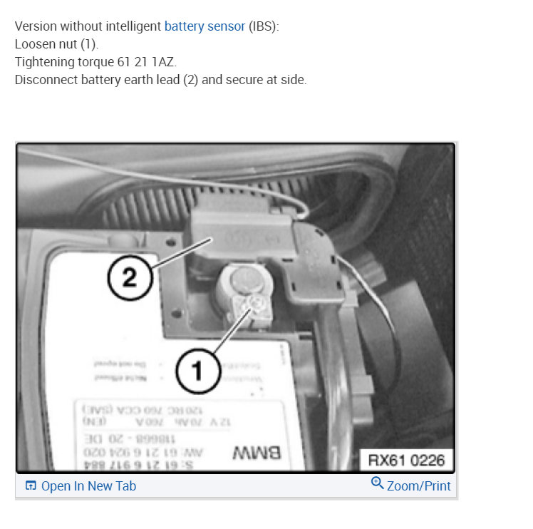

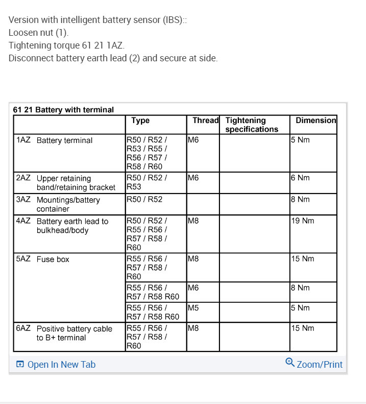

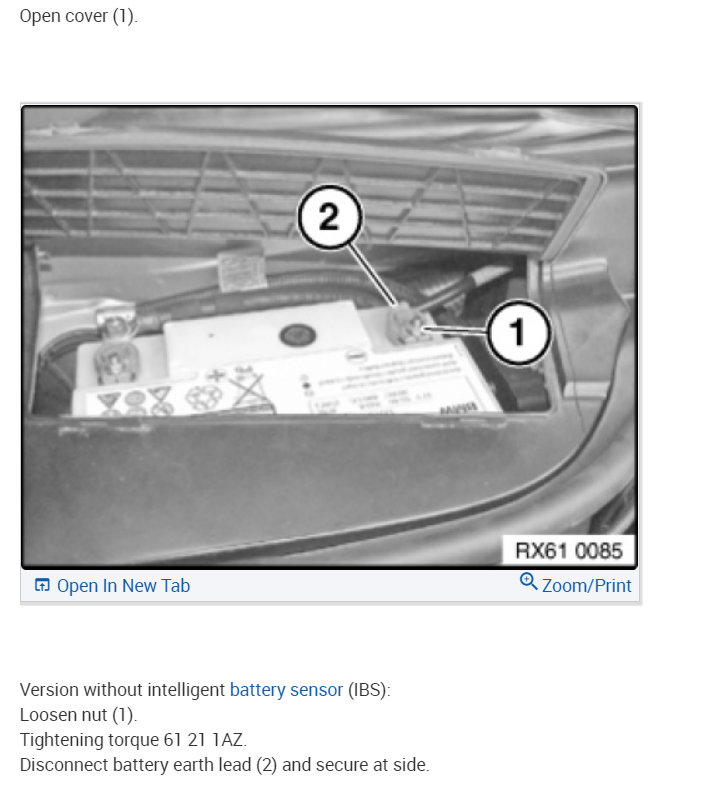

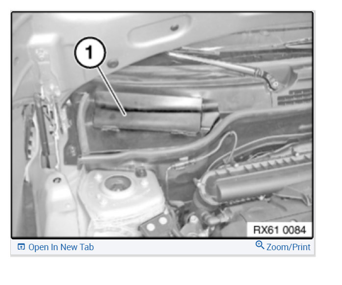

Here is a generic guide on how to change out the battery with specific information on your car in the diagrams below. I am not sure about the Japan model this is what they give us in the US. Let me know if you have any questions.

General notes on disconnecting battery:
- Do not disconnect battery leads and leads from alternator and starter motor while engine is running.
- Cars with IBS on battery negative terminal:
Do not under any circumstances pull/lever off pole shoes by force.
Do not under any circumstances release socket-head cap screw of IBS.
- Detach terminal of battery negative lead from car battery and second battery if fitted. Cover battery negative terminal(s) and secure.
- When work is carried out on the electrical system, faults may be caused in the fault memories of some control units when the battery is connected.
- When installing battery terminal: Tightening torque 61 21 1AZ.
