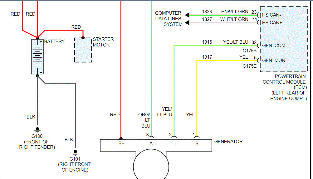

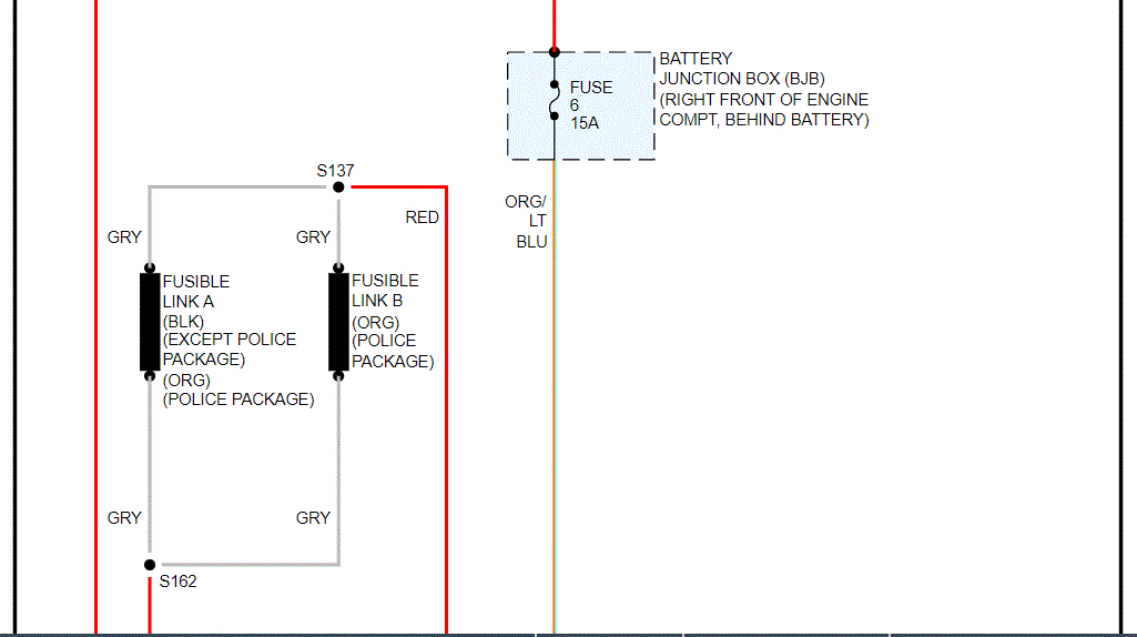

When I turn key over, there's fast clicking and car won't start. When I turn my key off my gauges are pulsing. What my problem?
Sep 12, 2020 at 11:51 PM
Good afternoon,
This has all the indications of a drained battery.
https://www.2carpros.com/articles/symptoms-of-a-bad-car-battery
You need to either charge the battery or replace it.
https://www.2carpros.com/articles/how-to-charge-your-car-battery
https://www.2carpros.com/articles/how-to-replace-a-car-battery
Then once it starts, check the charging system to be sure the alternator is working.
