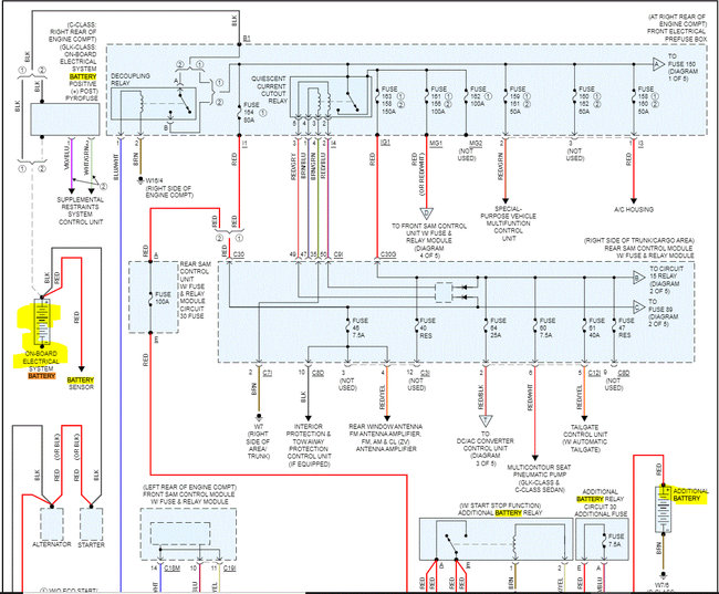

I am trying to solve an issue with sunroof, seTs and windows not working, trying to see if there is an aux battery in these models.
May 3, 2022 at 5:07 AM
  • 110,248 POSTS

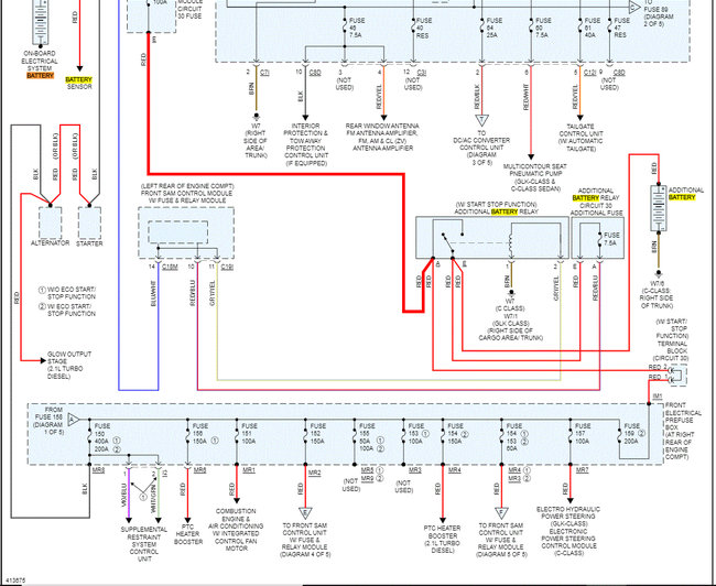

I looked up the power distribution system for the vehicle, and it shows two batteries. One is for the onboard electrical components and the other indicates it as "additional" located in the trunk.
I attached two pics below showing the schematic. Let me know if this is what you needed. Note, I had to cut the pic in two, so it was readable for you. I did overlap them so you can follow from one to the next.

Nothing in trunk. Have one up front. didn't see any in the back.
May 3, 2022 at 1:30 PM
  • 110,248 POSTS
That is an additional battery according to the schematic. If I had to guess, it was optional.
