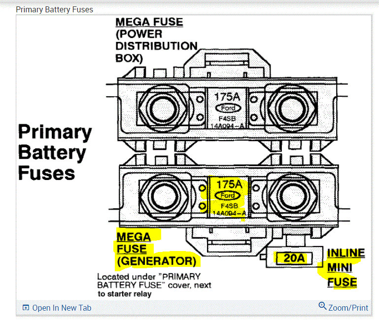

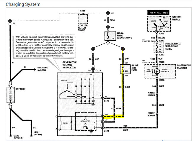

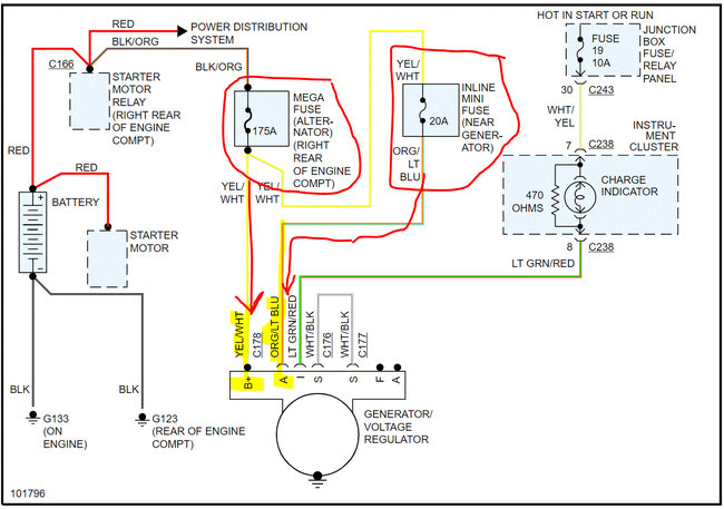

For the alternator to produce a charge, it needs power. There are two fuses I need you to check. First, there is a mega fuse (175 amp) under the hood on the driver's side near the rear of the engine compartment.
Next, there is a 20 amp inline fuse that is near the alternator that needs to be checked.
I attached the wiring schematic for the charging system. I highlighted the fuses to check. When you check the fuses, confirm there is power to and from it.

Are you getting power to the orange/light blue and the yellow/white wire at the alternator? If you are, something is wrong with the alternator. If you are not getting power, go back to the fuses and confirm there is power to and from them. Here is a link showing how that is done:

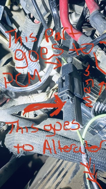

The colors on mine r Gn/r And o/w. O/w I believe is the dash and yes the Gn/r goes to the PCM. I did notice today the Gn/r From the alternator it goes to right behind the mega fuse and it’s a connector from the alternator to the mega fuse it ends at a male. I had continuity from there to there but from the female part to the PCM I wasn’t getting any kind of continuity so as of power on the green/red I don’t think so from the plug. so I cut the wire and connected them without the connector still nothing. which is weird because I had power from the alternator two the male end.

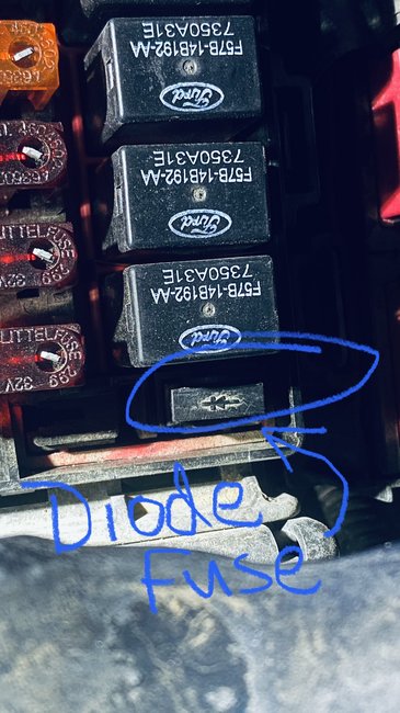

Joe, fuses are good, double checked every fuse except for relays and diodes. not sure how to check them other than switching them with like relay/diode.

Which wire are you not getting power to? The orange/light blue and the yellow/white must have power at the alternator. Are those wires a different color on your vehicle?
As far as the starter relay, power doesn't go through the relay for the alternator. It is a splice location, so the condition of the relay doesn't play a role.
As far as a diode, it is internal and is used to change an AC current into a DC current and it limits the direction of power flow in one direction. I don't think that is an issue either.

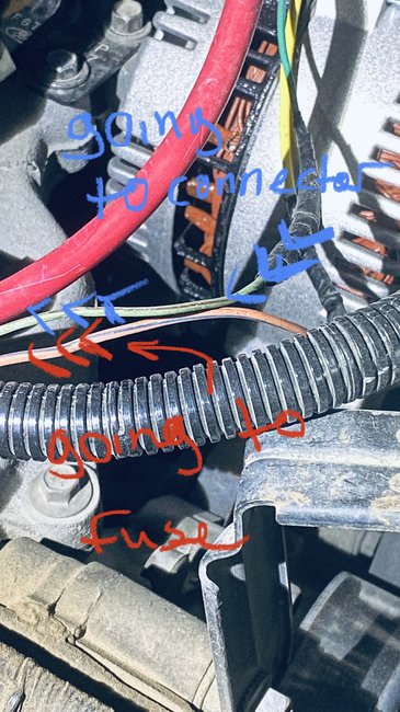

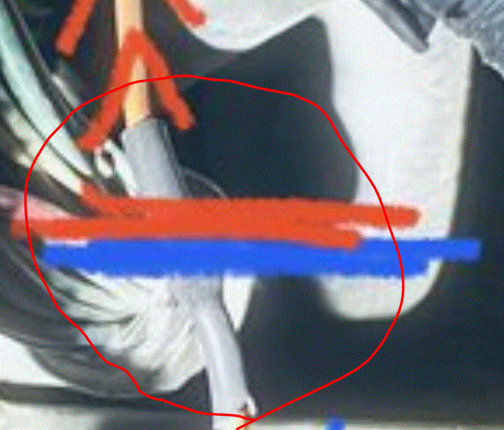

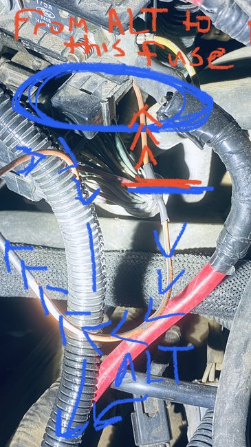

I posted some pictures (I hope you can see and understand them ) it is an o/blk from alternator to a fuse right under the mega fuse and g/y from alternator to connector and connector to the power control module. Connector to PCM no continuity but (not power) from connector to alternator have continuity (not power) could it be from the connector to the PCM I may have a break in the line where it’s not sending or receiving power through it? But I do have power to the alternator it’s only pushing 12.5 V with the truck on… I want to just thank you for taking the time and trying to help me figure this out I am very grateful and appreciative!!!

Is there power at this wire? See pic below. Also, there appears to be a connector (something black) on the wire. Check for power on both sides. Also, the light green which should have a red tracer goes to the instrument panel for an indication of a no charge.
I'm not sure why the wire colors are different on your vehicle. Do me a favor. If you open the driver's door, there should be a label with a manufactured date. Let me know what that date is. I may have to go back or ahead a year if it is an early or late production vehicle.

Let me know what you find. Also, if you look at the schematic I sent, I need to confirm there is power to the yellow wire with a white tracer.
One last thing, the last pic you attached has a green wire with electrical tape on it. Make sure there isn't a problem at that point.

I'm wondering if something was changed. The inline fuse is in the yellow/white wire. It should be there.
If you look below, I attached the wiring schematic from the manufacturer. It shows it.

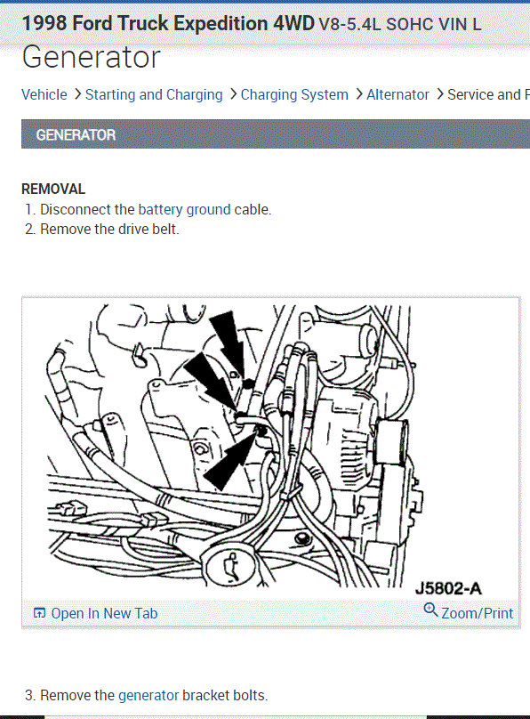

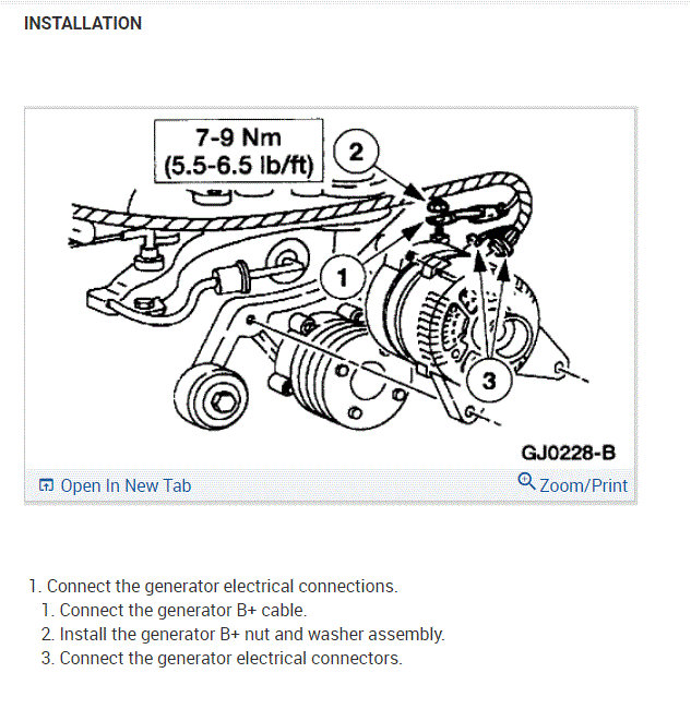

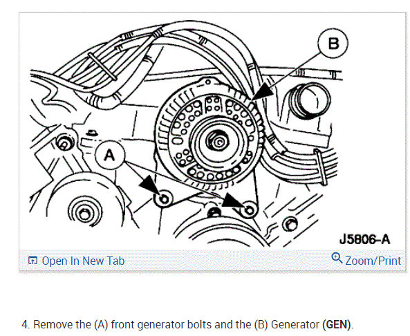

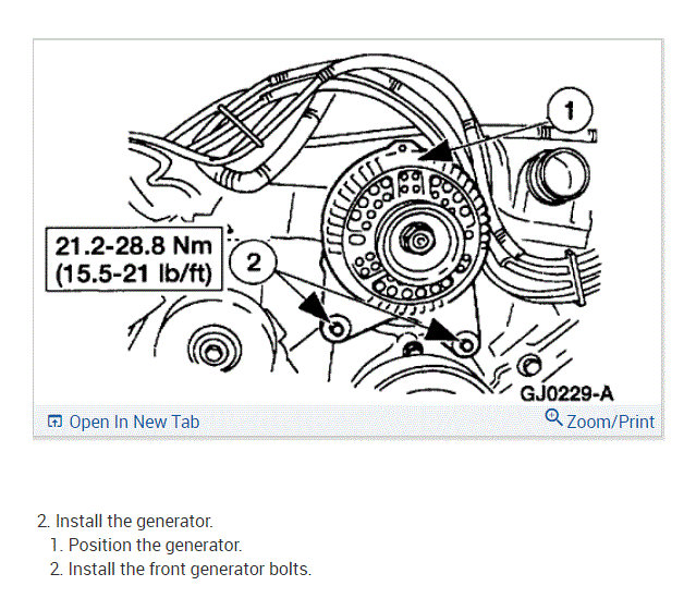

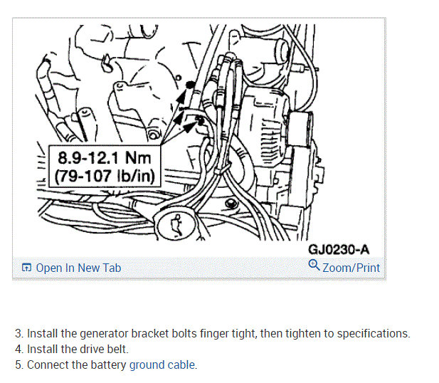

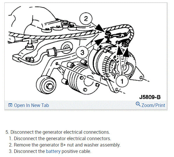

If there is power to the alternator and it's only producing 9-10v, it sounds like it's bad. At this point, I would remove it and have it bench tested at a parts store.
Here is a link that shows in general how it's done:
https://www.2carpros.com/articles/how-to-replace-an-alternator
If you look at the attached pics below, they are the directions specific to your vehicle.
