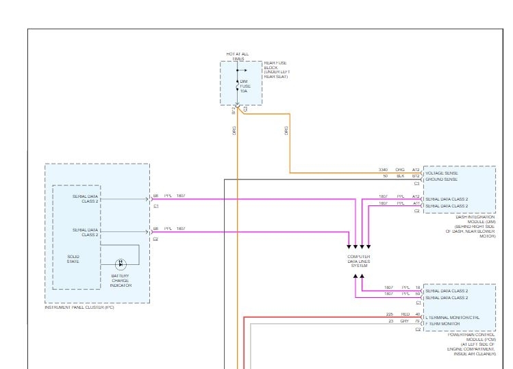

Battery not charging and service charging system message
2003 CADILLAC DEVILLE
14,000 MILES • V8 • 2WD • AUTOMATIC
CLARENCEBANKS
  • 7 POSTS
"Battery not charging, and Service charging system" displayed on IP.
Replaced battery.
Replaced alternator.
Same message displayed.
What's next?
Jan 17, 2021 at 1:52 PM
MOTOR MASTER
  • 279 POSTS

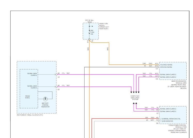

Hello my name is Dave.
The most likely issue is a blown fuse, If you you look under the left rear seat there is a 10 amp fuse for the charging indicator/alternator. I have attached a diagram of your charging system wiring so you can see where everything is. I am also including a link to our tutorial on testing your charging system so you can be sure if it is charging. Here is that link:
If you can follow these steps and keep us up to date on your progress we will be happy to assist you further. We look forward to hearing back from you and thank you for using 2CarPros!
Jan 18, 2021 at 8:08 PM
CLARENCEBANKS
  • 7 POSTS
1) Fuse panel not clearly labeled. Had to check every fuse.
2) No blown fuses found.
3) Condition persists, battery still not charging. Warning still displayed in cluster.

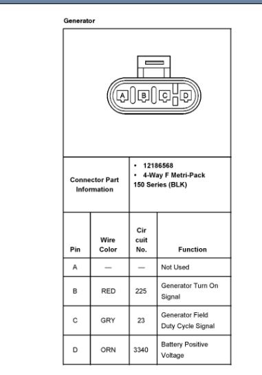

Jan 24, 2021 at 8:44 PM

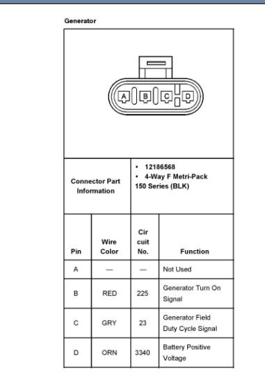

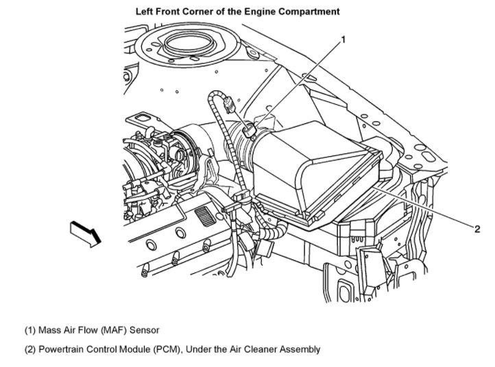

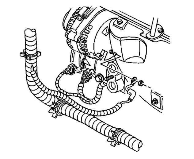

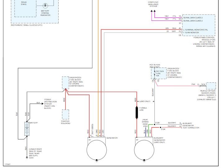

Good morning,
Go to the alternator and test for 2 wires that should have power with the key on.
One is directly from the battery and the other is fuse controlled. I attached a picture of the connector as well.
If you have the power, then there is a good chance the ECM is the issue as it controls turning the alternator on and off to maintain the battery.

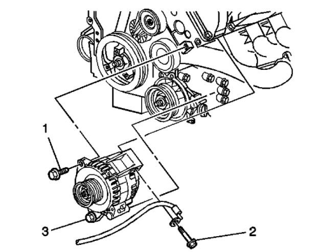

REMOVAL PROCEDURE
The Denso SC1 (KG9) generator is serviced as a complete unit only.
1. Disconnect the battery negative cable.
2. Remove the drive belt
3. Remove the radiator.
4. Disconnect the wiring harness connector from the generator.
5. Reposition the protective boot from the generator output BAT terminal for access.
6. Remove the generator output BAT terminal nut and disconnect the positive lead from the generator.
7. Loosen the lower generator bolt (3).
8. Remove the generator bolts (1, 2) from the generator.
9. Remove the generator from the vehicle.
