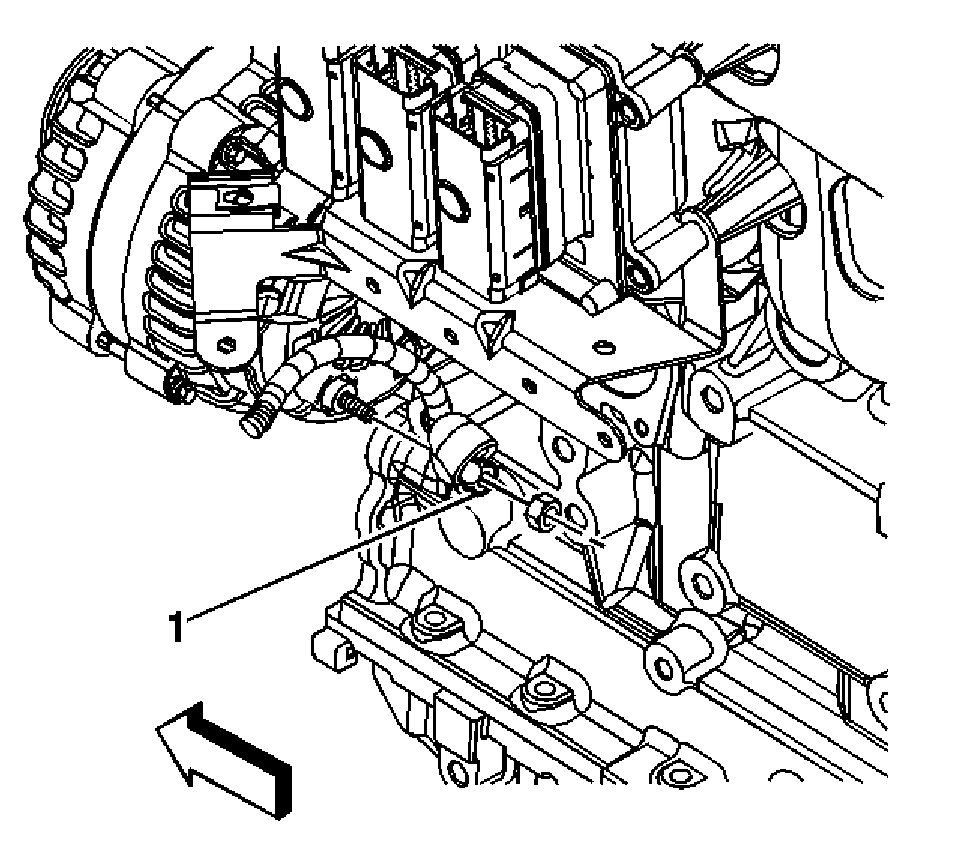

If the battery is getting 17 volts, the regulator is bad. Also, this can cause many electrical issues and even a fire.
The voltage regulator is part of the alternator. With that in mind, remove it and have it bench tested.

3. Disconnect the battery positive cable nut (1) on the generator.

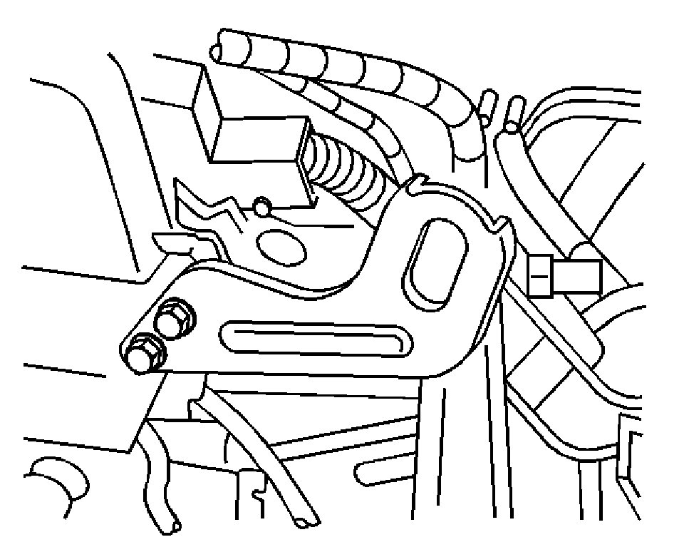

Picture 2
4. Remove the A/C line mounting bracket bolt at the engine life hook.

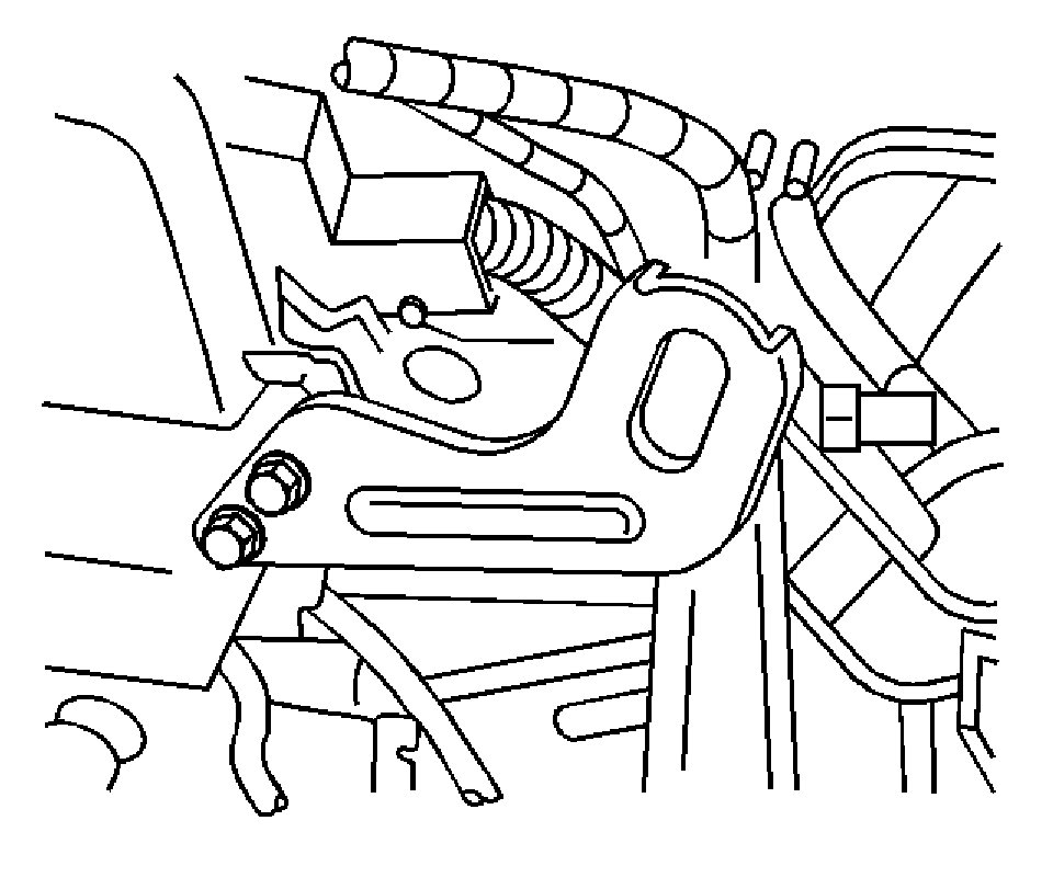

Picture 3
5. Remove the right engine lift hook bolts and remove the lift hook.

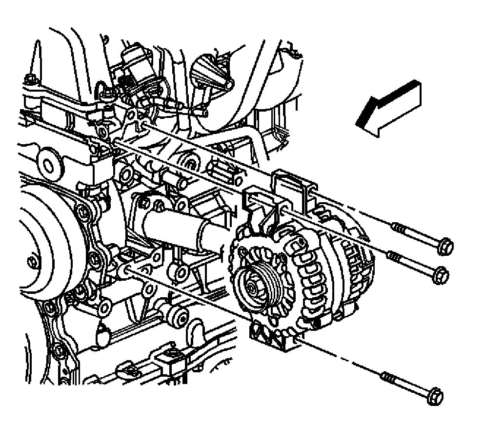

Picture 4
6. Remove the 3 generator mounting bolts and remove the generator.

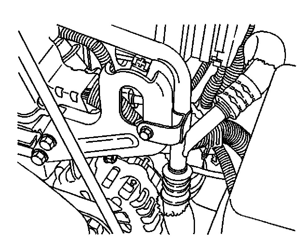

Picture 5
2. Connect the battery positive cable to the generator and secure the positive cable with the nut (1).

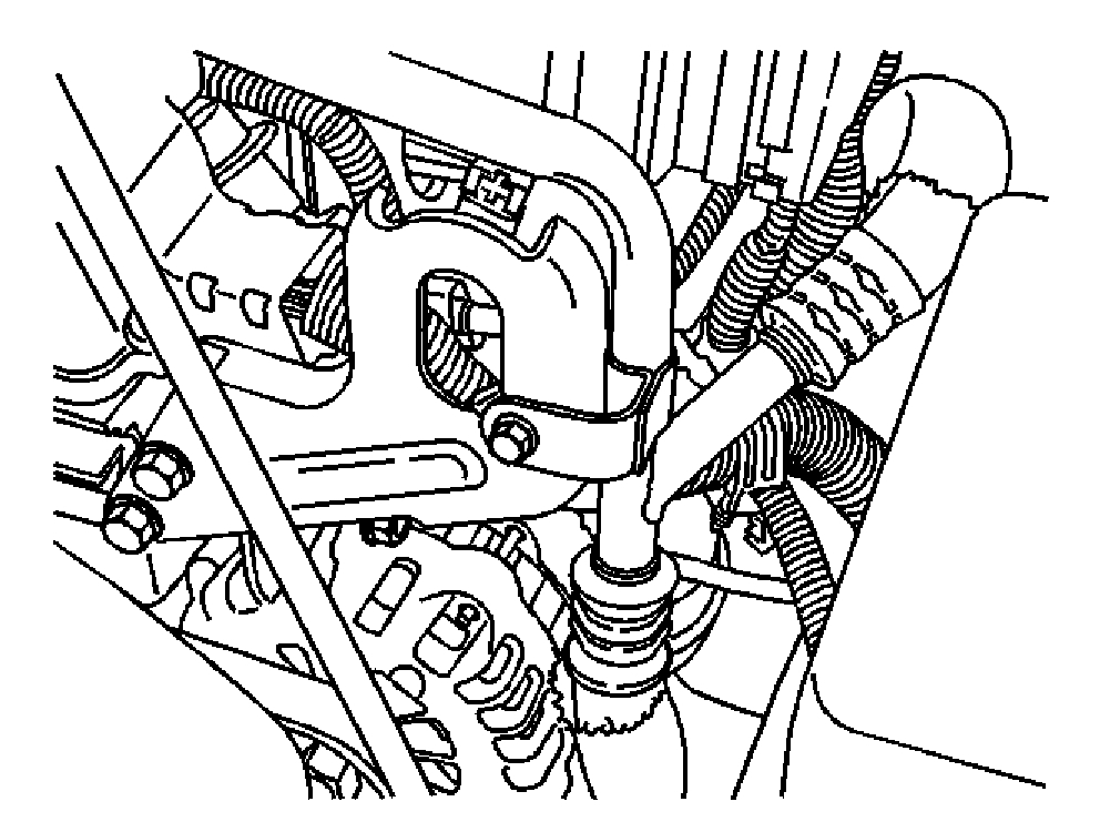

Picture 6
3. Install the engine lift hook and secure the lift hook with 2 bolts.
