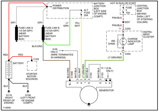

I just got a refurbished alternator, and my car still does not charge. so, I went back to the store and had them test my old alternator and it was good, so I returned the refurbished one and now I was thinking of the fuses that i would need to check. could you please let me know which ones I need to check or what I need to do now?

Please see the diagram below of the charging system.
Ensure that both fuses, alt fuse(20A) and charge indicator lamp fuse(5A) are good.
How to check fuse:
Next check that there is battery voltage at the B+ terminal, black/orange wire, at the alternator.
This can be done by using a voltmeter or test light.
How to:
and
Check that there is battery voltage at terminal A, yellow/white wire, at the alternator
With ignition on, engine not running, we should also have battery voltage at the I terminal, green/red wire, at the alternator.
If all these inputs are given and the alternator is still not charging, i.e. charging lamp does not extinguish, then next check voltage at the B+ terminal with engine running. Are you getting battery voltage or readings of around 14V?
Please also try and connect a battery jumper cable from the alternator to a good chassis ground, see if this makes a difference.
Hope this helps.
