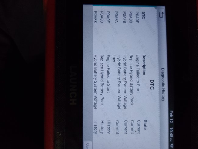

Good evening, the vehicle is starting but it is not shifting to the electric motor to power the vehicle, the vehicle was scanned, it was complaining of battery pack. The battery was removed, the voltage was checked individually, they were all reading 9.9-volts. how many volts is it supposed to have?
What would have be the best way to diagnose it?

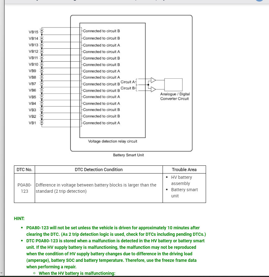

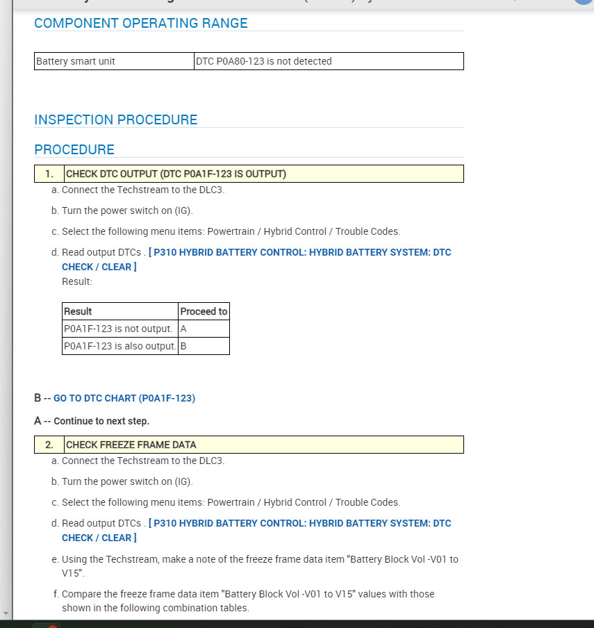

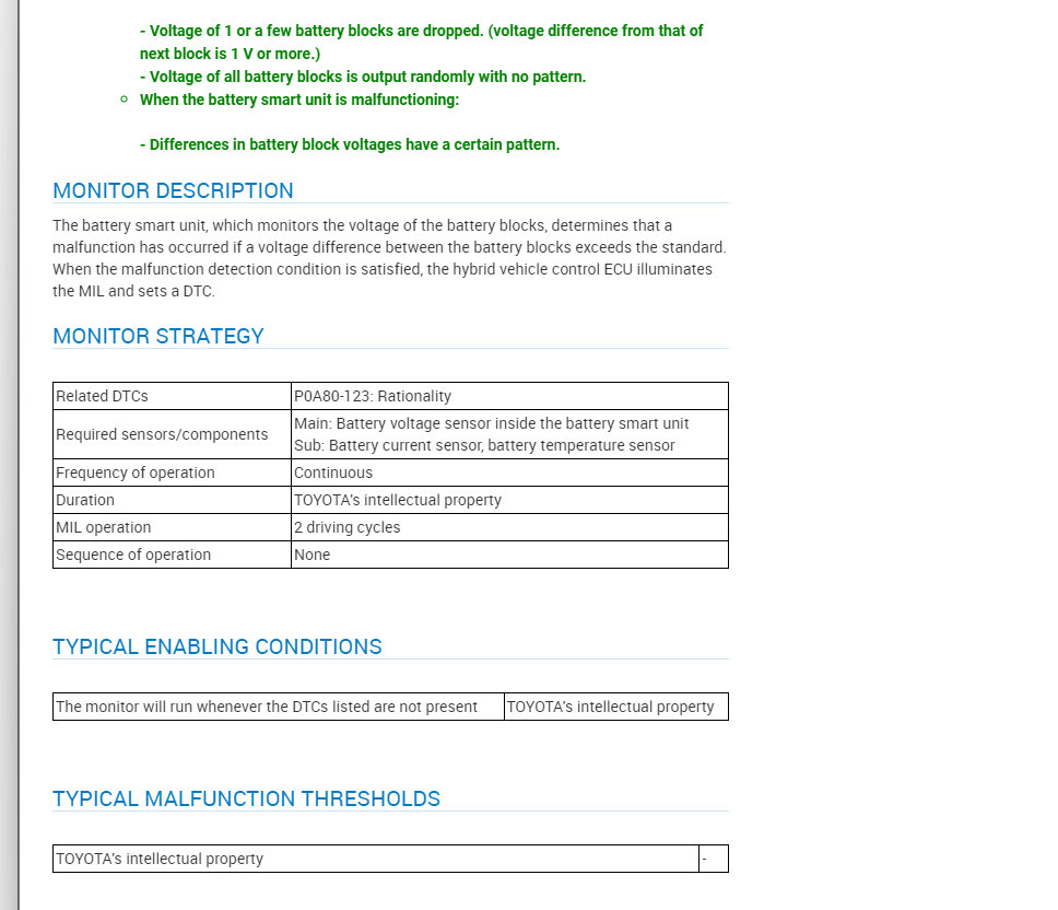

The voltage on the cells for the high voltage battery are going to vary depending on the state of charge when you are checking it, so we normally don't worry about the voltage of the battery but instead we want to run through this testing.
I am attaching it below but here is a guide that will help with using a meter, but I don't think you need it, but others may:
Below is the testing that we need to run through for this primary code of P0A80.
More than likely, you will need to replace the battery pack, but you can try and slow charge it and you may be able to recover it.
Just Google how to restore a hybrid battery and there are all sorts of videos showing how to do it. Usually, you can get back to 80% state of charge or more which will not only get the vehicle started but will get you more life out of the battery before you have to replace it.
Let us know what you find. Thanks

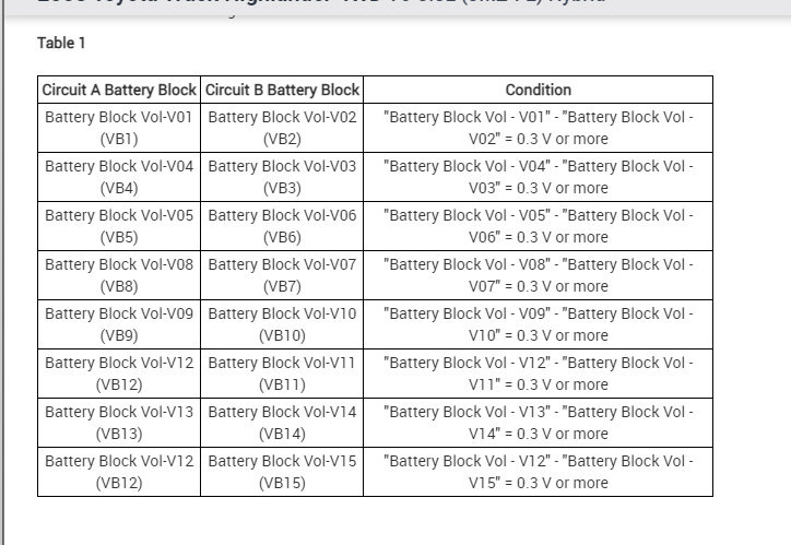

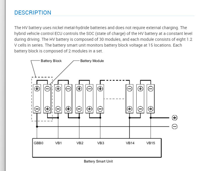

Good morning, sir, checking the stream data on the scanner, the vb1 voltage is ranging from 23v to zero continuously, while others range from 23-22 continuously. How would someone know the vb1 from the batteries?
Dec 9, 2021 at 12:17 PM

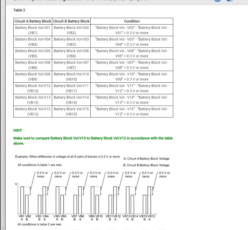

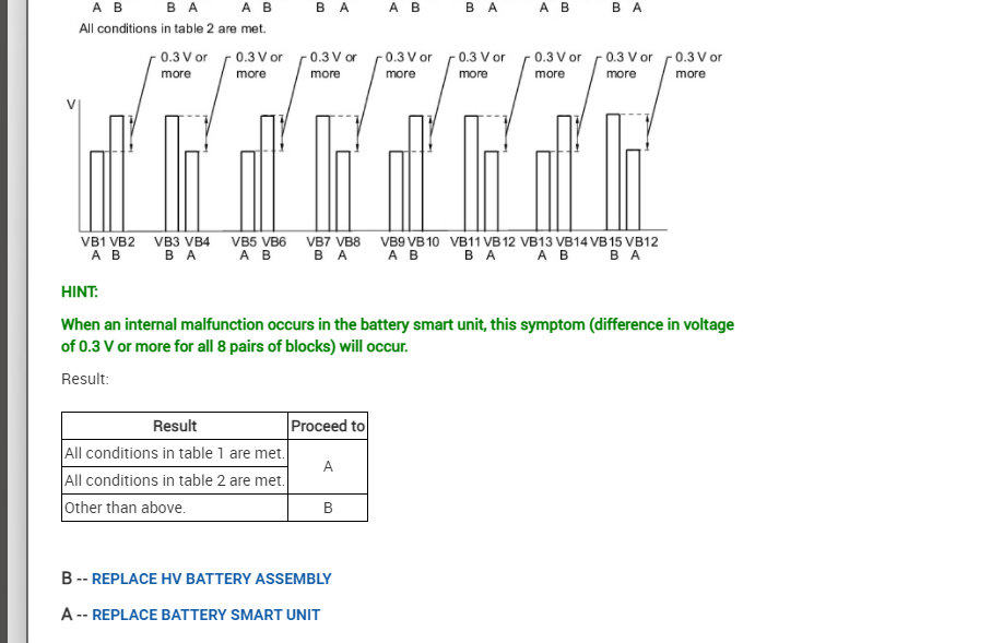

So, this is another way to tell that the voltage block is shorted if it is ranging that much.
The testing above wants you to monitor the neighboring block and compare them. If they are more then .3 volts different then there is an issue.
So, it is clear that you have a shorted cell in the battery pack which is causing this issue, so the instructions tell you to replace it based on this info.
However, I would suggest looking into a slow charger for attempting to repair these because usually you can get more life out of them.
Dec 10, 2021 at 2:25 AM

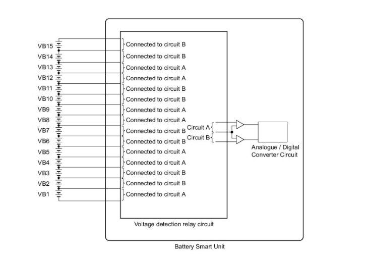

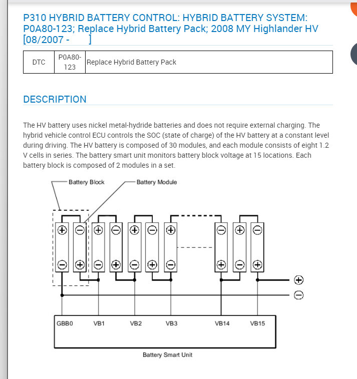

Okay. There are thirty total modules. Each module has 8 1.2-volt batteries. Each voltage block has two modules in it making 15 voltage blocks.
This means each voltage block has 16 1.2-volt batteries in it for a total voltage of 19.2 volts.
If each one you checked was about 10 volts, then the entire battery is drained.
So again, it looks like the battery is drained.
I am attaching the info below that will help with this and hopefully answer these questions for you.
Dec 10, 2021 at 10:53 AM

Good morning, sir, please I sincerely apologize for disturbing.

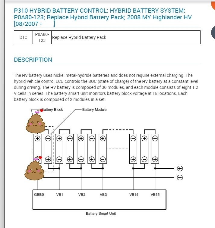

Sir, from the diagram sent earlier, first image show that a line or row of battery is called battery module, connecting two together is battery block. The battery module is what I am referring to that I measured the voltage.
Sincerely apologize sir, just trying to understand something.
Dec 10, 2021 at 11:07 AM
BLESSING EWOBOR
  • 753 POSTS
On the image below, just the line with sticker that I said it ranges from 9- 10v, each of them.
Dec 10, 2021 at 11:17 AM
No disturbance as this is what we are here for. So, if you have about 9.5 volts on each of these individual modules then when combined, that would be about right for what you should have.
So, thanks for clarifying that.
This means if the battery is not drained then we have an issue with the control module thinking that it is. This means if you follow that testing through and the battery is actually okay, then the battery smart unit is the issue and requires replacement.

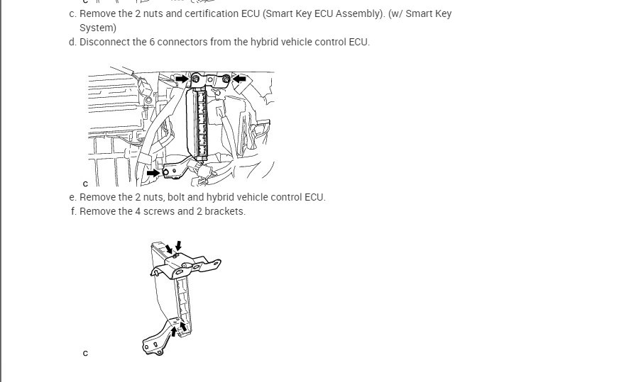

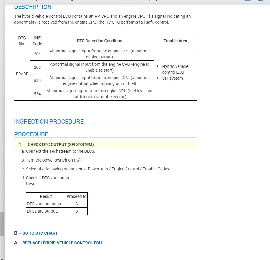

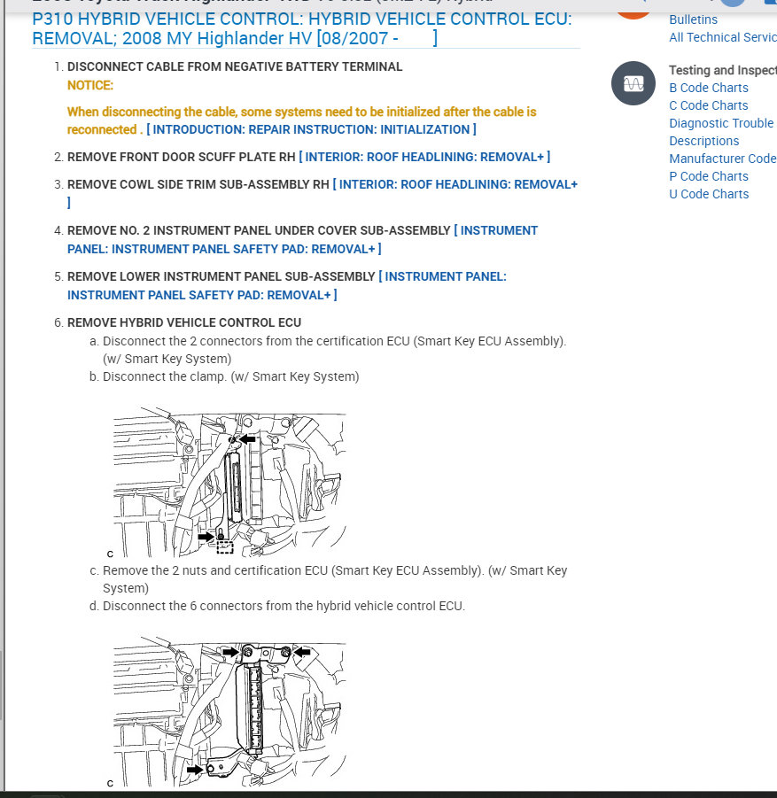

Sir, for the vehicle to start the engine, does it require the power from 12v battery at hood or the big battery? I am asking based on code P0A0F, from the history on the picture I uploaded earlier. The vehicle did not start initially, the hybrid battery was charged by another vehicle (not hybrid) by charging the module individual till each of them get to 11v.
Dec 11, 2021 at 12:00 PM
The 12-volt battery under the hood is used to start the engine like a conventional car but it is controlled by the same controller that controls the high voltage side.
So, this code is considered secondary to the other code that we were looking at.
However, based on the testing that you have no other gas engine codes that would cause a no start then it is telling you to replace this controller.
What is the history to this vehicle? Was it in an accident or anything out of the ordinary?
Was it just sitting, or did it just come in with these codes?
Just seems like we are missing that bit of information to help determine which direction to go. However, if it were me, I would address the codes for the hybrid battery first. That means it looks like the smart unit needs to be replaced. Then address any other codes that remain.
