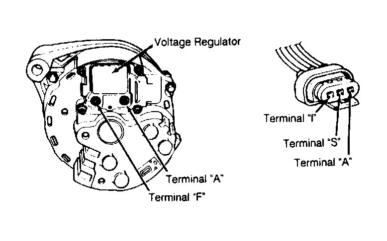

Battery not being charged
WILLIE BURKETT
  • 1992 FORD F-150
  • 4.9L
  • 6 CYL
  • 2WD
  • MANUAL
  • 330,000 MILES
The alternator in the picture is the correct one.
Monday, May 30th, 2016 AT 7:52 AM
5 Replies
SATURNTECH9
  • 30,869 POSTS
The alternative in the picture is the correct one? Did you post is picture? I do not see one? Also the one that was replaced you had tested and it tested bad?
Monday, May 30th, 2016 AT 8:37 AM
SATURNTECH9
  • 30,869 POSTS
Also do you have a internal or external voltage regulator?
Monday, May 30th, 2016 AT 8:43 AM
WILLIE BURKETT
  • 14 POSTS
Internal.
Monday, May 30th, 2016 AT 8:44 AM
WILLIE BURKETT
  • 14 POSTS
The picture was from another reply.
Monday, May 30th, 2016 AT 8:47 AM
SATURNTECH9
  • 30,869 POSTS
Use a voltmeter and put the negative lead to the case of the alternator and the positive lead to the terminal a at the back of the alternator you should have battery voltage?
