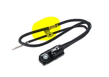

I installed a new battery control module which is located on the negative battery cable, in order to install it I had to cut the end of the negative cable to thread it through. I decided to install a new cable that I purchased at AutoZone, after installing it the car would crank but would not start. After about 2 hours of messing with it I found that the cable had another ground connection on the cable hidden see pic. I did not remove the old cable yet because I was in a hurry. I reconnected the old cable (old cable not connected to block) and the car started right up. So, my question is, why is there another ground connection on the cable?

Hello, was the old cable bolted to the body of the vehicle? Most likely it is the main body ground and is the ground that the computer uses. A 2007 year vehicle has a bunch of computers (modules) and all need to be grounded correctly or they will not function correctly.
