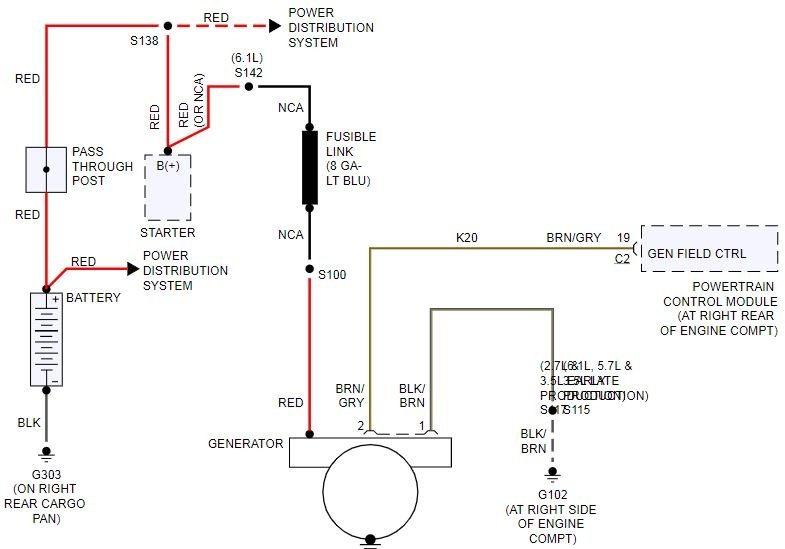

Replaced starter, battery light came on and will not go off. I’ve put in a brand new battery and alternator and checked all fuses! Battery light will not go off.

I have done this also and nothing is showing up on the reading! Could it be the car’s computer?

That seems odd. This particular vehicle should typically set codes for charging system issues. Let's move on using a multi-meter and see if we can narrow down the issue. Take a look at the articles below to get started. The first discusses the use of a multi-meter if you're not already familiar. The second walking you through the process of testing the charging system. I've also attached a wiring diagram of the charging system for your reference.
