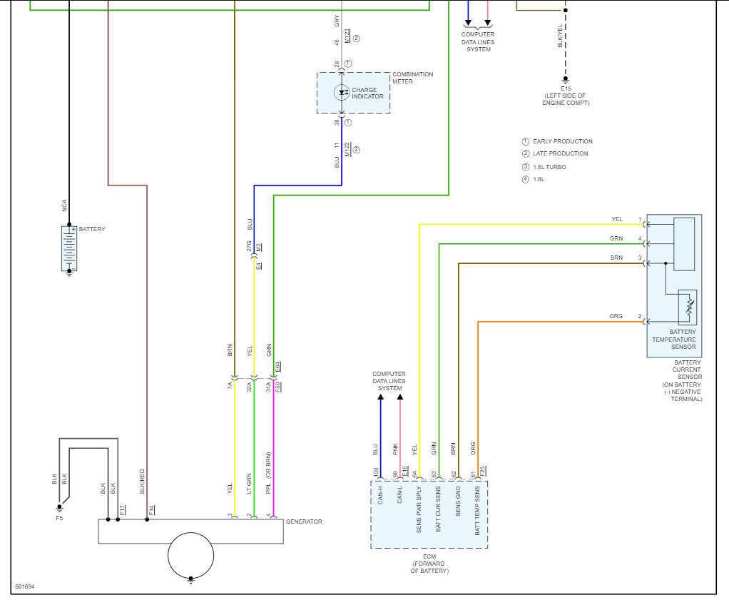

I was told my alternator was failing so I had it replaced. However, my battery light is still illuminated while the engine is running.
Jul 13, 2023 at 3:37 AM
  • 55,224 POSTS

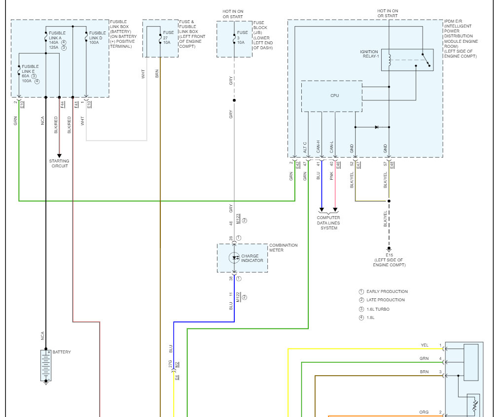

You may have a defective alternator but to be sure let's use this guide to see if it is charging:
If not let's check the fuses #27 in the left front of the engine compartment and fuse #3 in the lower left end of the dashboard. Here are the alternator wiring diagrams so you can see how the system works.
