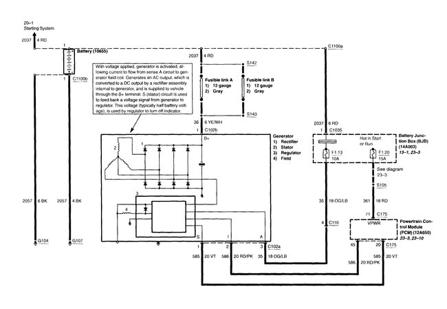

Battery light will not go off stays on all the time . Alternator checks out good. I was told it has an external diode, but cannot figure out where it is located. can you help?

What is the battery voltage when the engine is running? It sounds like the alternator is bad but to be sure lets test it by following these videos and guides.

No external diode in the system I can see. The charge indicator circuit feeds back system voltage to turn off the light. Check the fuses and the fusible links.

Alternator is new not a re-manufactured. but it was bad I got another unit worked perfect thanks for your time.
