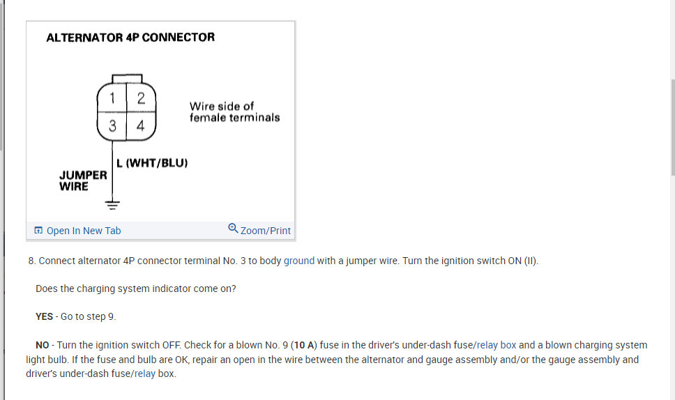

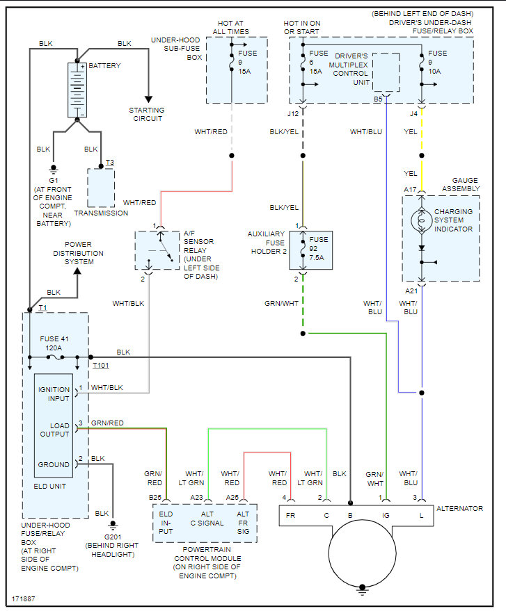

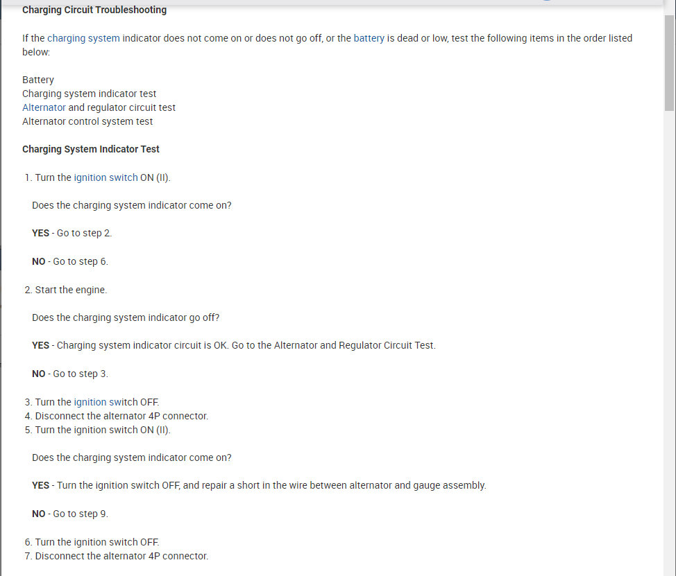

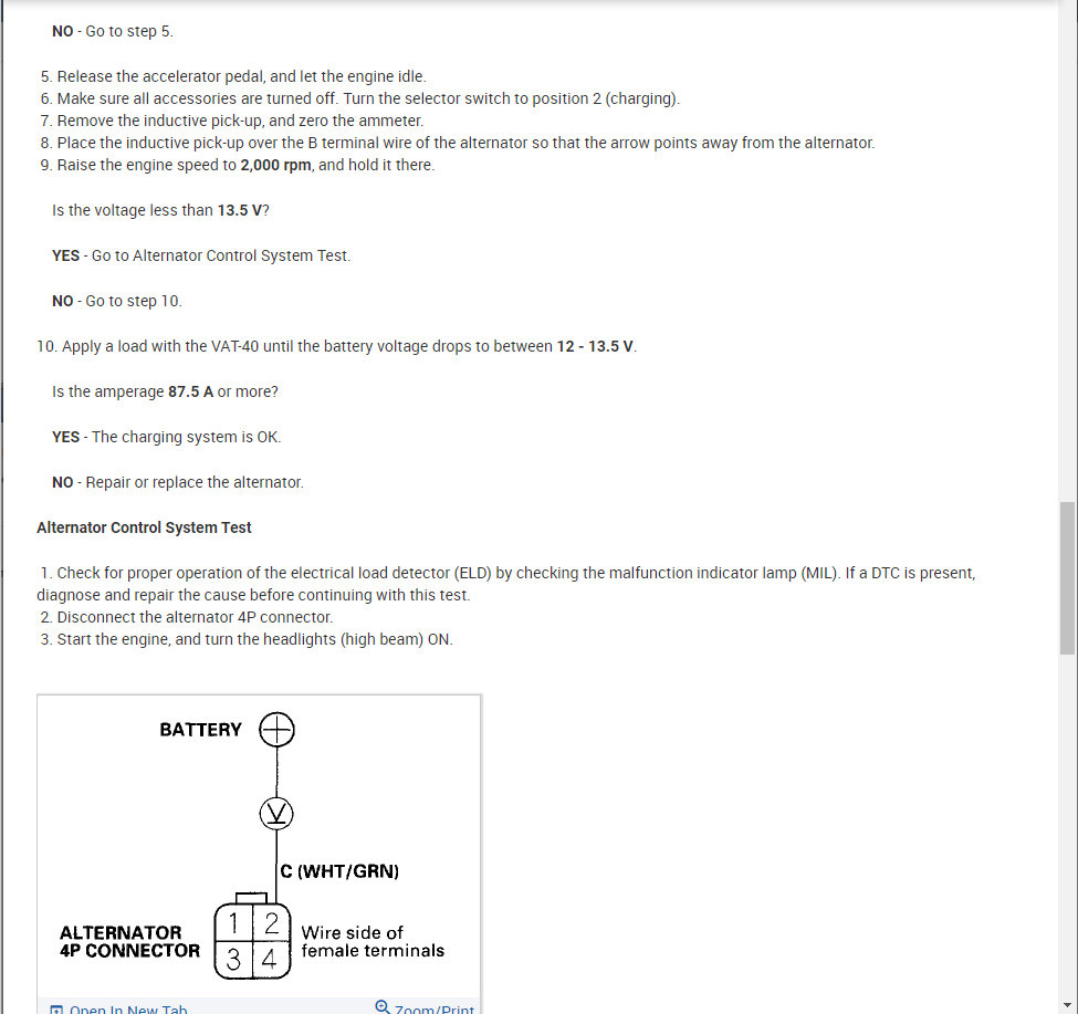

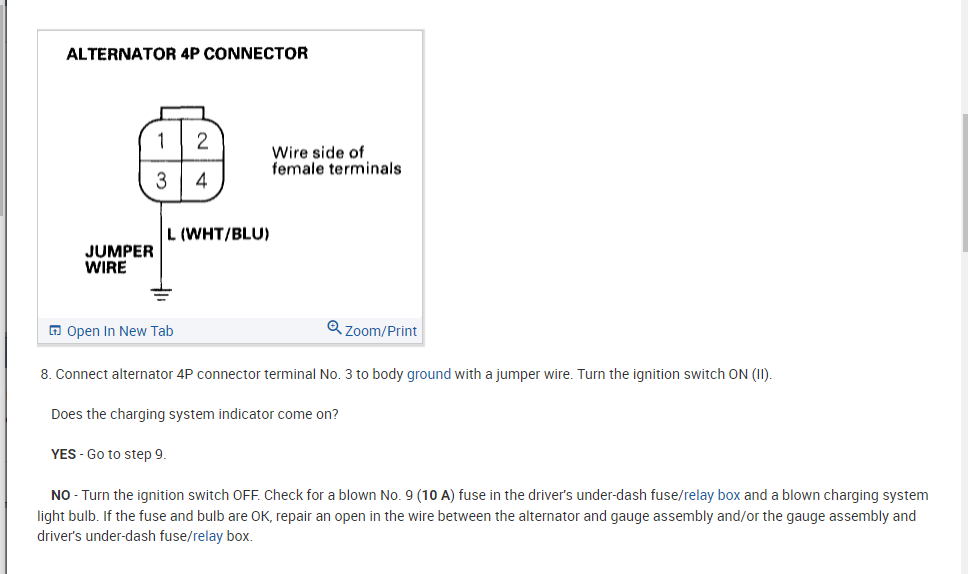

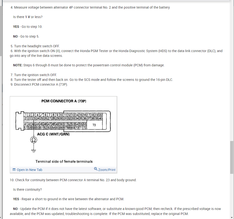

Replaced battery, then alternator and serpentine belt as the battery wouldn't charge and shut off. I replaced the battery again and the battery light stays on 30 minutes later idle, so new battery, new alternator, new belt. Not sure what else to check. Power steering and transmission need work too, but this is the main issue at the moment.
Jul 5, 2021 at 7:25 AM

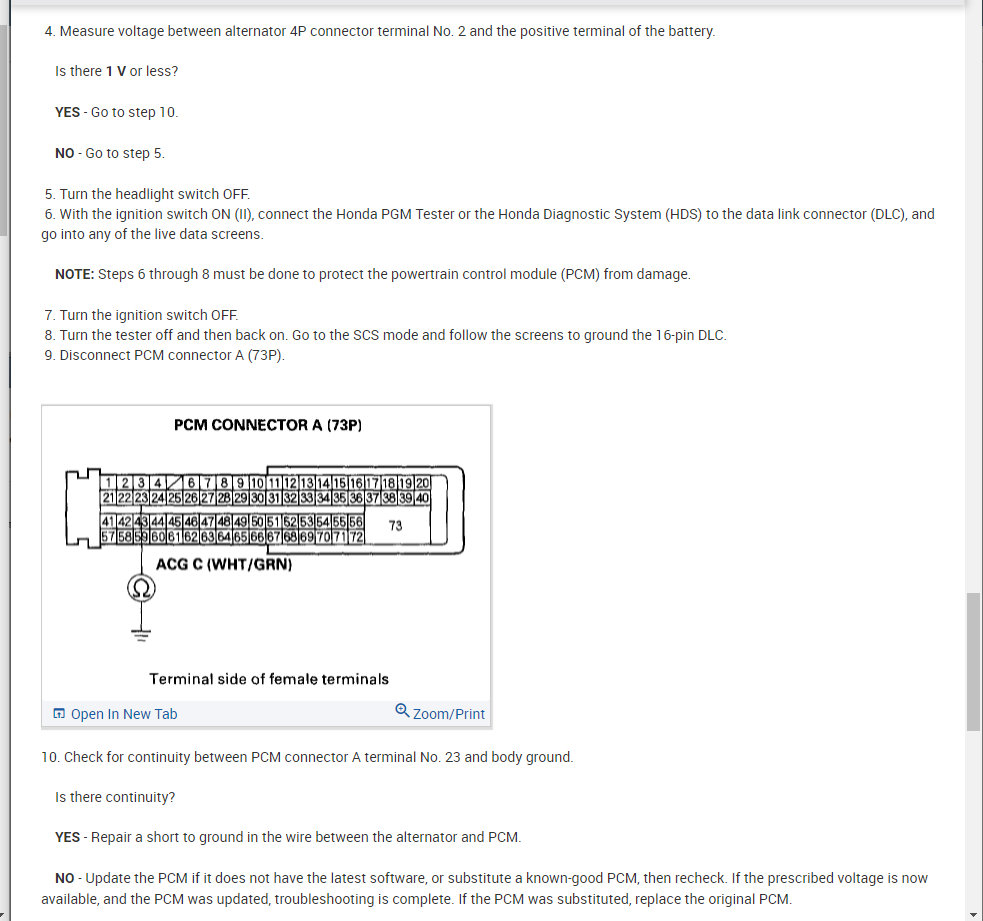

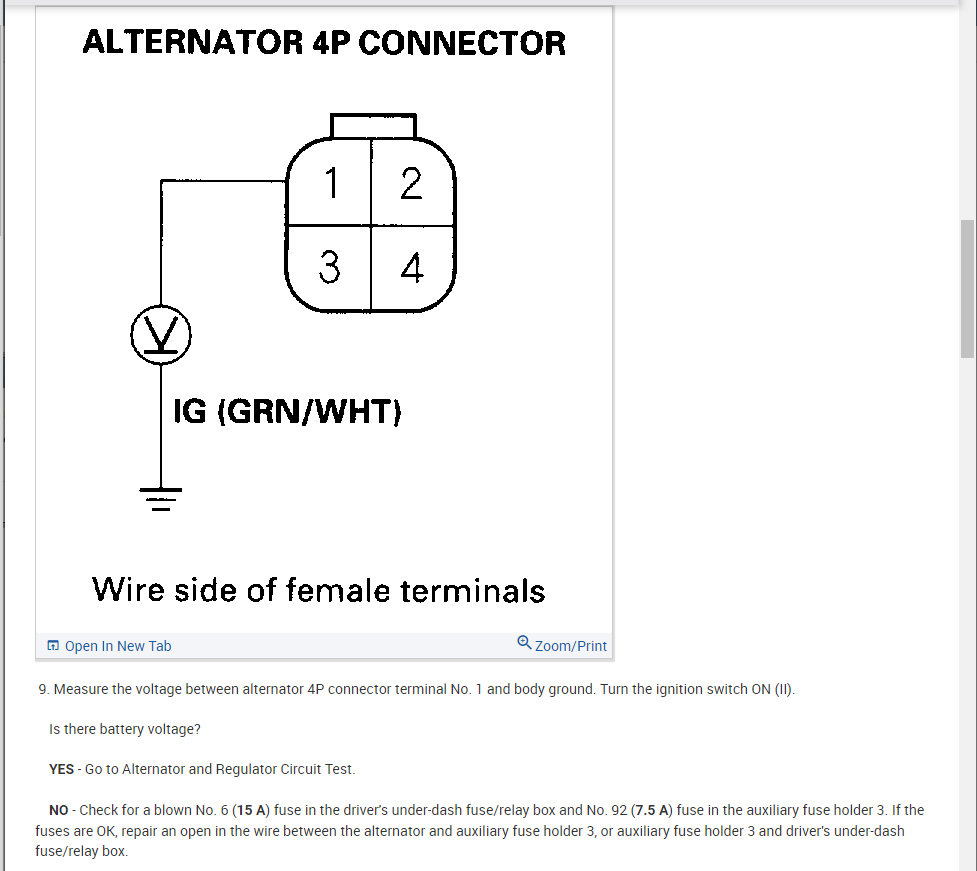

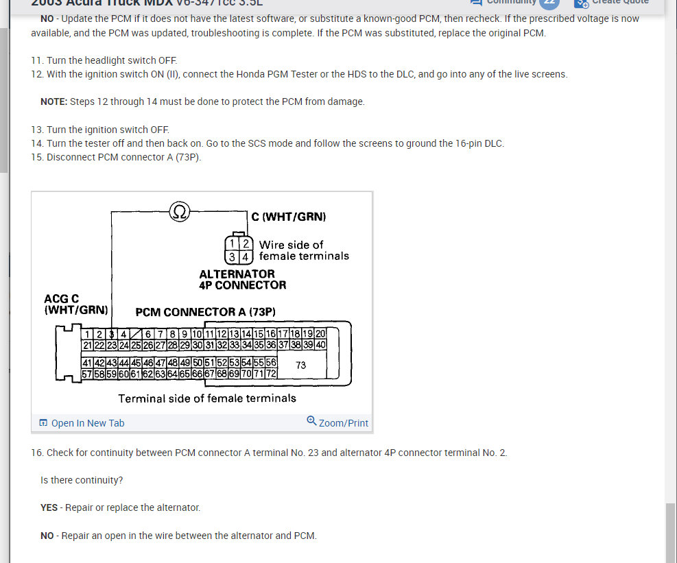

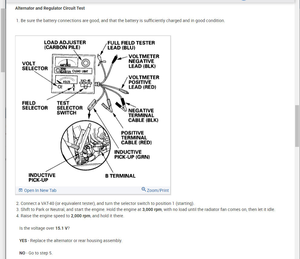

More than likely this is a PCM issue but we need to run through this testing to find out what the possible issue is.
Here is a guide that will help with this type of testing:
Below is the testing that we need to do for this issue. Please let me know if you have any questions on this and what you find.
Thanks
