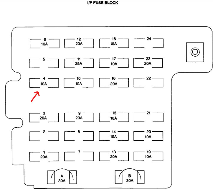

New battery, new alternator, new starter, new terminals new cables, new ignition switch.
Nov 18, 2024 at 3:18 AM
  • 55,694 POSTS
Is the alternator charging when the engine is running?
This guide can tell us:
If not, I would check the fuse # 4 gauges to see if it is good or not. Here is the alternator wiring diagrams so you can see how the system works and the fuse location as well. Check out the images (below). Please let us know what happens.
Nov 18, 2024 at 4:58 AM
ANNIMEDE44444
Thank you, we found out the problem, it was a frayed wire on the fusible link.
