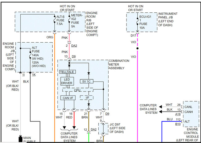

I began to notice that my Venza is draining battery and any time I start it in the morning, the battery light remains on and after a short period it off. What are the causes of this? I have check fuses and they tested okay, check relays and tested okay, check battery terminal for corruption, still okay. Could it be alternator itself or the belt that is the problem?
Sep 9, 2021 at 6:55 AM
  • 110,246 POSTS
Always check the belt first to make sure it is tight. However, if it is loose enough for the alternator not to turn, chances are you would hear it.

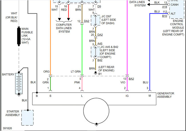

This sounds like it is related to the alternator itself. First, I attached the wiring schematic for the charging system below as a reference. Here is what I need you to do:
Before starting it in the morning is when we need to test the alternator. we need to check the voltage output from the alternator when first started. All you will need is a voltmeter or a multimeter.
Follow the directions in this link and let me know the results:
Let me know both the battery voltage with the engine off and then the voltage when the engine first starts with the alt-light on.
See pics below Note: The schematic was one page long. However, I had to cut it in half to make it readable for you. I did overlap them so you can follow from one to the next.
Sep 9, 2021 at 11:34 AM
