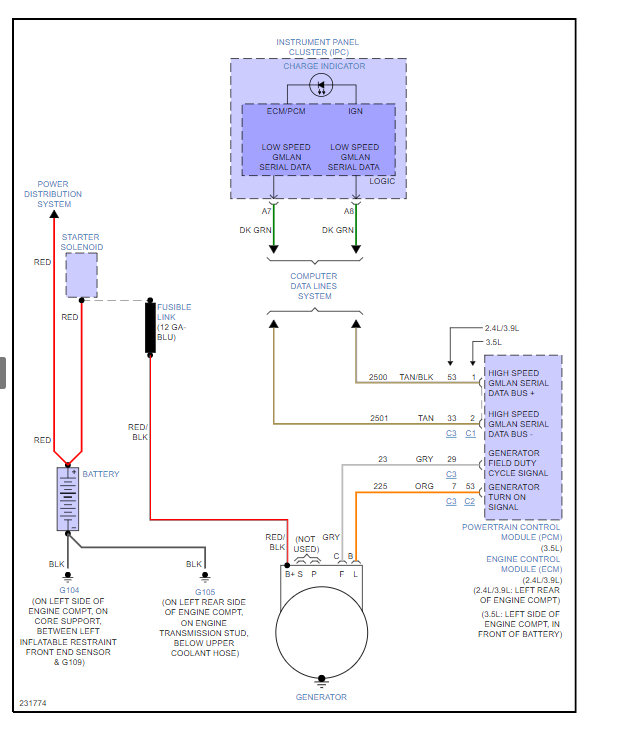

Battery light on, what is a M and B terminal and where are they located?
2006 PONTIAC G6
196,000 MILES • 2.4L • 4 CYL • 2WD • AUTOMATIC
CLARINDA MARTIN
I got a new alternator, changed out the starter and made sure 12-volts were running to my battery. After fixing all of this, when I turn my car the battery light comes on after it dings two times. I tried to drive it and my power steering locked up on me and I had a hard time getting it back home. I noticed some wiring had melted onto my engine block also a few weeks ago where the wire loom had broken around the wires, the wires that go between the starter and the battery. I didn't notice any damage but didn't look carefully either. I just wrapped it with electrical tape without acknowledging the extent that it could be damaged. Could this be the problem, or could I possibly have had a friend not connect the wiring from the alternator to the starter, right? What is a M and B terminal? Where are they?

Yes, the melted wiring can cause the issue, also is the drive belt still on the engine? Here is a guide to help you check the wiring and the alternator wiring diagrams that show the M and B wires and where they go:
