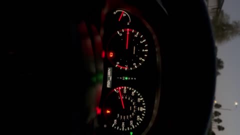

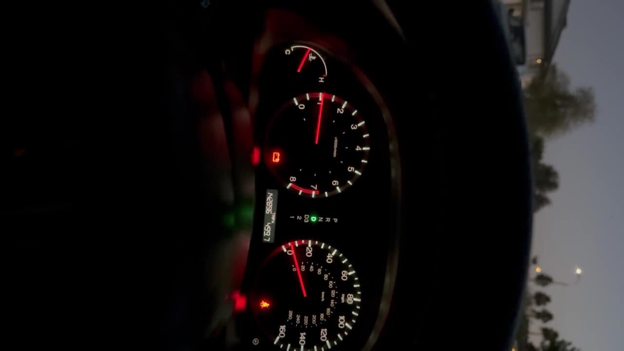

So, my car battery light came on earlier today while I was on the road. I noticed that my car started struggling to move forward when I hit the gas and the steering wheel started getting tight, so I pulled into an empty lot. After I jump started it, the battery would not hold a charge and just turn off. So, I went to AutoZone and got a new battery and dropped off my old one to charge. My concern right now is that the battery light will constantly turn on when I come to a stop but go away as soon as I hit the gas. One thing to keep in mind is that I replaced the alternator in April of last year and before that in October 2021 so I do not believe that should be the problem.

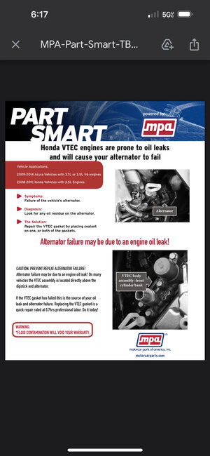

So, I just got a call back from my mechanic, he told me that the valve cover is leaking, right around the dipstick and it is positioned right above the alternator which is now covered in oil. He just replaced the valve cover gasket but needs an additional part. I found this online which I guess indicates a common issue.
Mar 27, 2023 at 11:21 AM
  • 110,240 POSTS
That could cause an alternator issue for sure. I'm glad you made me aware of this issue. I've seen them leak before, but I never got to a point of alternator failure.
Regardless, if you could, would you mind letting me know if this resolves the issue? I'm interested in knowing.
