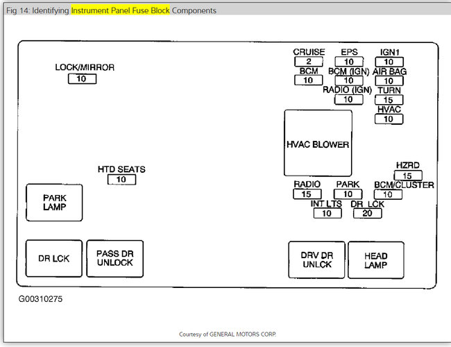

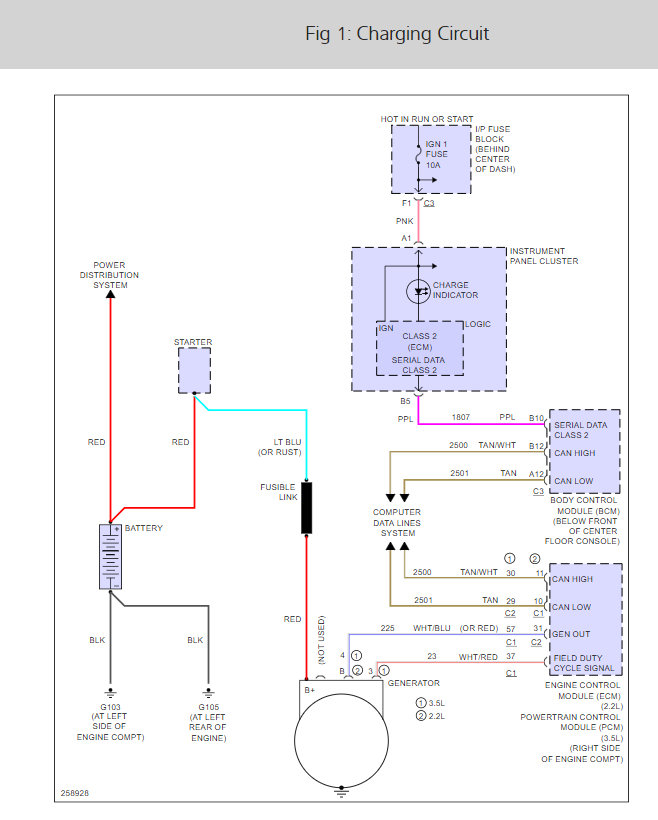

Battery light on
2007 SATURN VUE HYBRID
90,000 MILES • 2.4L • 4 CYL • 2WD • AUTOMATIC
WILLIAM GRAF
Battery light on generator tested good.
Sep 16, 2018 at 1:56 AM
  • 55,395 POSTS
There is an Ignition 1 fuse that needs to be checked. Here is a guide to help us get started and the alternator wiring diagrams so you can see how the system works with the fuse locations as well:
