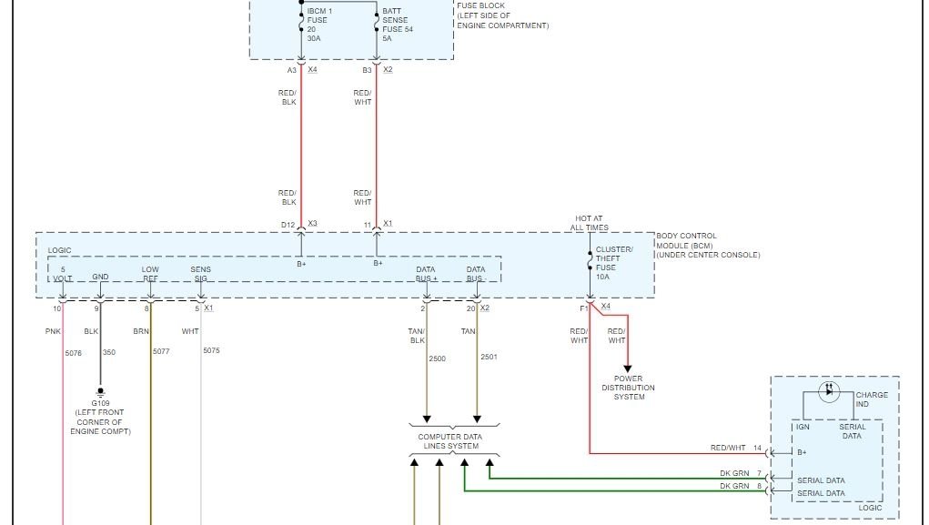

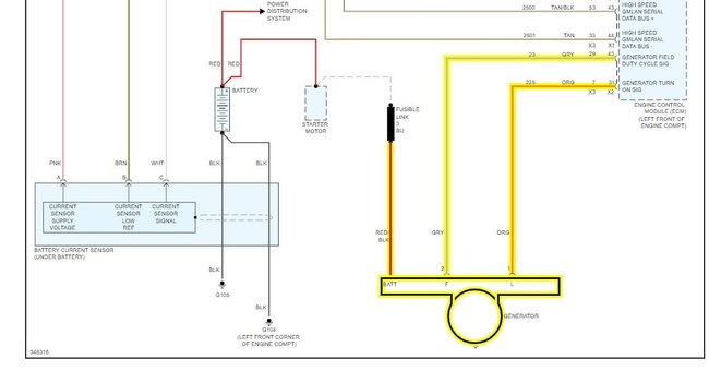

Battery was not charging. Changed battery and alternator. Battery light is still on and battery is not charging. Had the alternator checked and is working.

Good afternoon,
It sounds like the alternator is bad but to be sure lets test it by following these videos and guides.
https://youtu.be/Z-p4dMJUpUw
and
I have uploaded the alternator wiring diagrams so you can see how the system works.
Check out the diagrams (Below). Let us know what happens and please upload pictures or videos of the problem.
Mar 2, 2020 at 4:20 AM
WILLYANTONY77
Thank you so much for your help. The alternator seems to be working fine. grounds all seem to be okay, I changed out the generator fuse and it started working.
