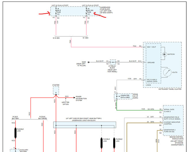

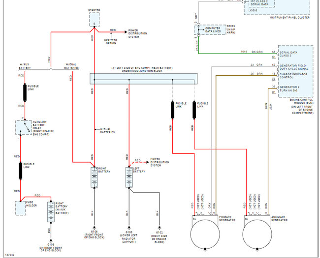

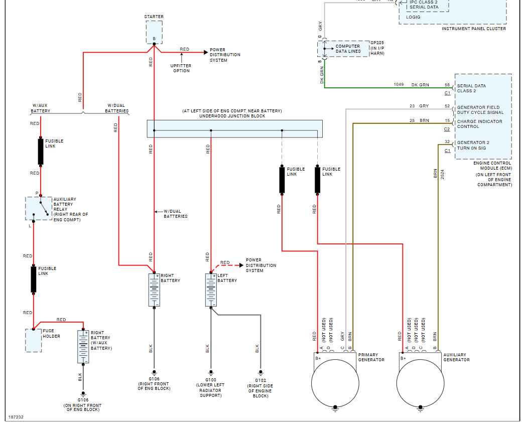

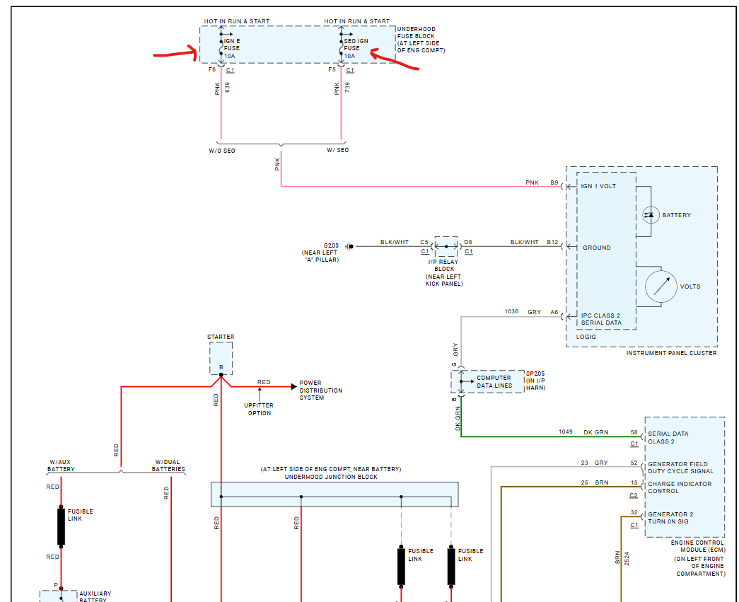

Lets check for power at the fuses with the key on, this guide can help you. Also, I have included the charging system wiring diagrams so you can see how the system works.
Check out the images (below). Let us know how it goes.

Okay, update. Voltages are for SEO-B2/IGN E/SEO IGN/SEO B1 in that order. At the fuse block KOEO 12.54/11.57/11.57/12.63, KOER 14.06/13.97/13.95/13.96. All fuses are good. Voltage at the Passenger Battery KOFF 12.28, KOER 14.13, Driver KOFF 12.29, KOER 13.97. Battery light still on.

As you can see by the wiring diagrams there are not that many wires or items for the system.

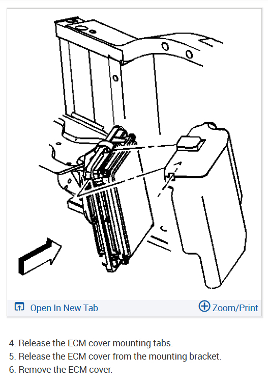

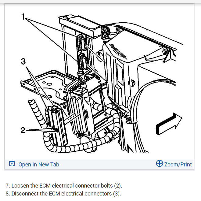

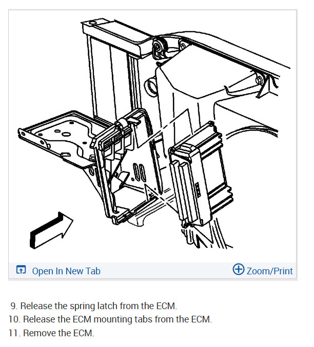

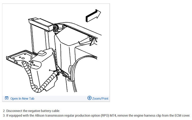

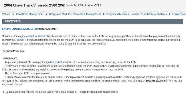

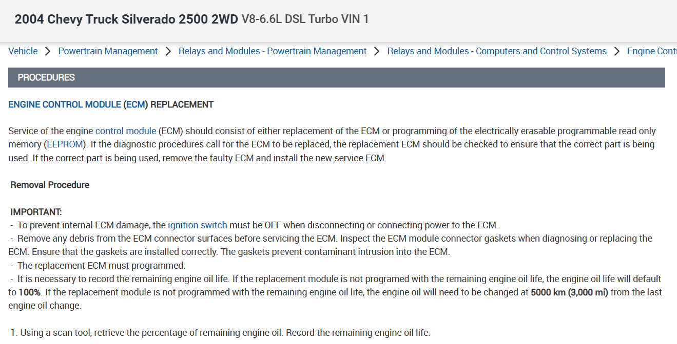

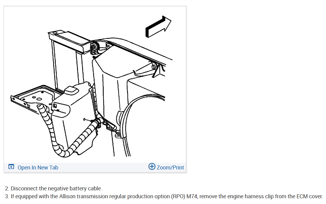

I think the alternator is okay it is common for the voltameter to flash voltage then give you the reading. It is starting to look like the PCM is bad, lets send it in for testing. Can I ask how old the batteries are? Sometimes a battery can test good but have a weird internal error fyi. You can find a place to test the PCM if you search google or ebay. Check out the images (below). Please let us know what happens.
