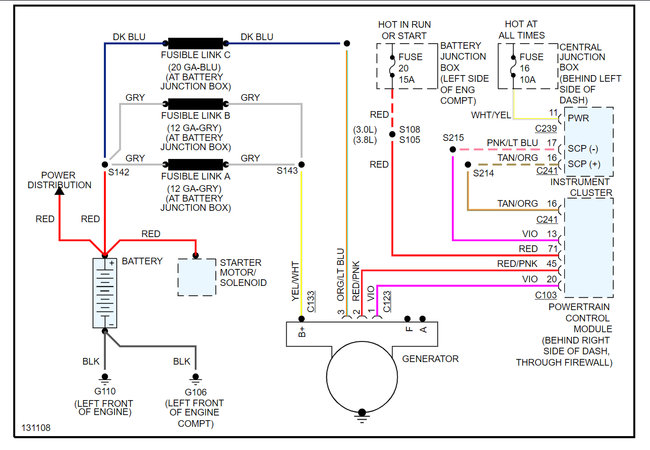

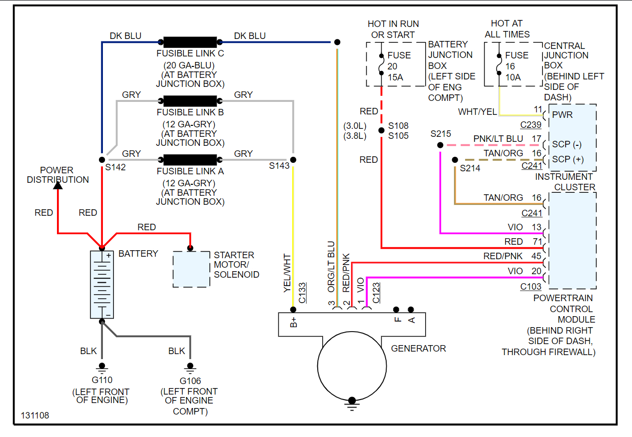

My alternator is making 13.6 volts DC. When I turn on all lights and A/C it goes to 13.5. I did this at idle without increasing rpm. Do I need another alternator?
Jul 4, 2021 at 5:57 PM
Good morning,

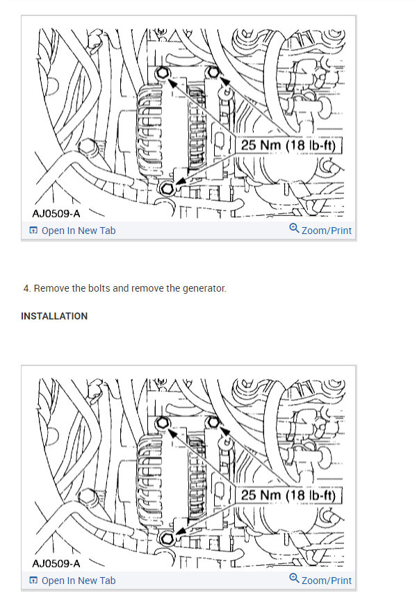

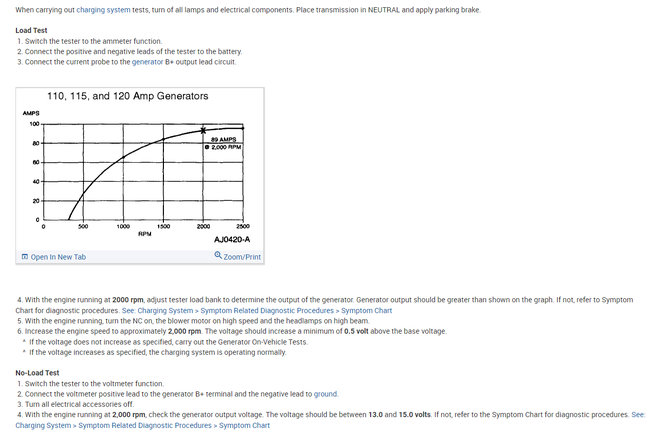

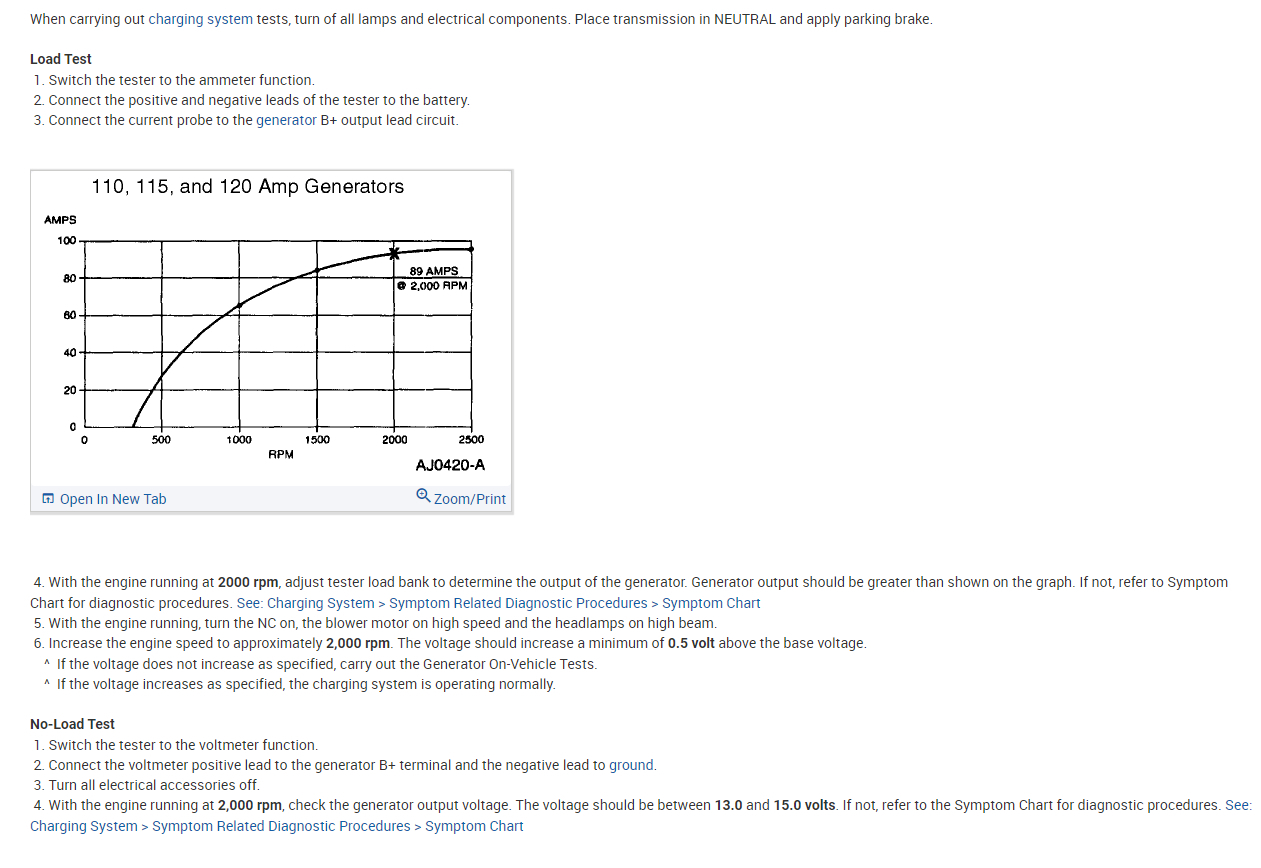

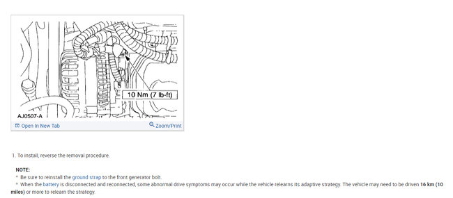

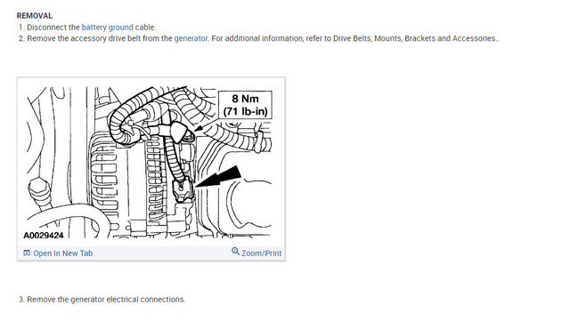

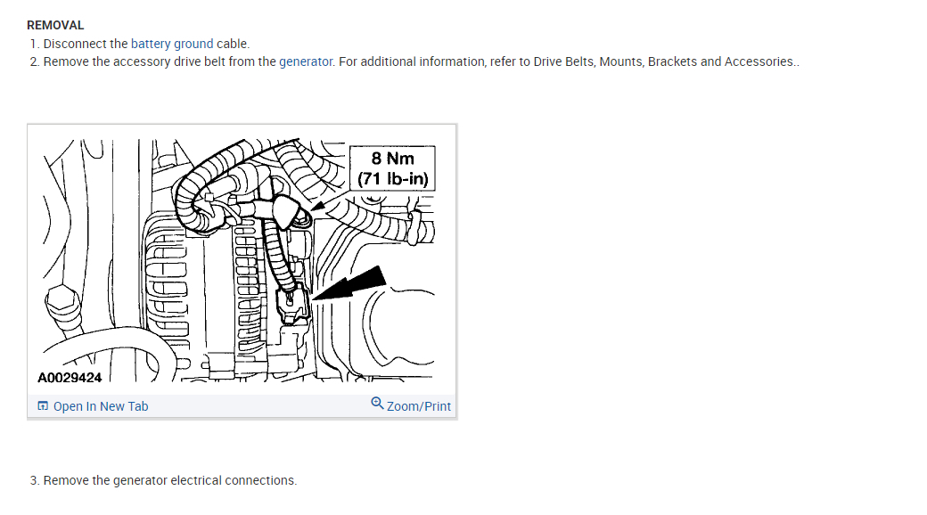

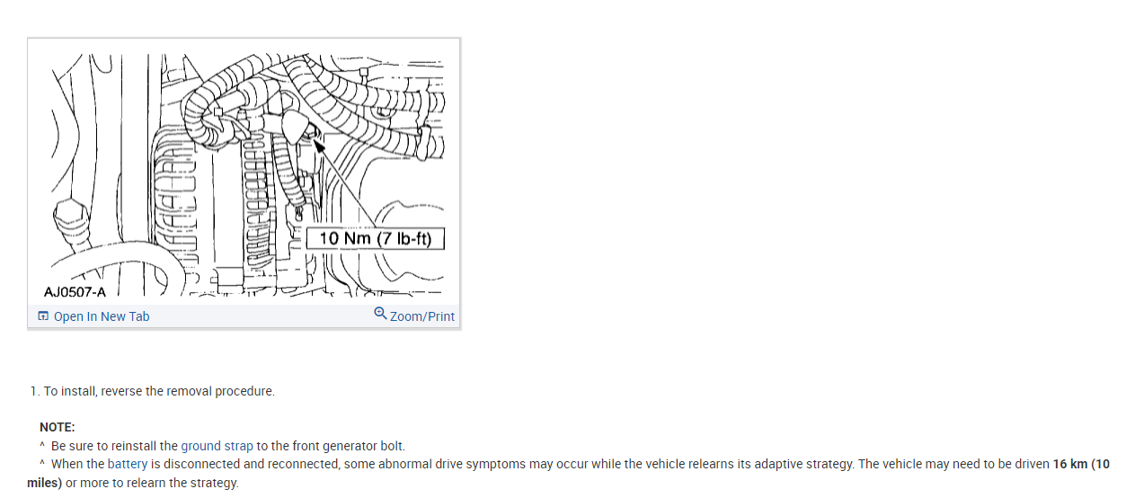

The charge rate should be 14 to 14.5 volts. That low voltage tells me it needs to be replaced.
https://www.2carpros.com/articles/how-to-replace-an-alternator
I attached the wiring diagram for you and the procedure.
