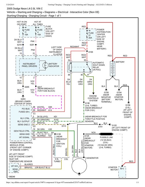

JOETECHPRO
  • 705 POSTS
Hey AL N EVIE,
I have attached the wiring diagram for the starting/charging system on your vehicle.
It looks like there is an in line fusible link in the black wire you shorted out originally when fitting the alternator. This wire goes from the starter directly to the alternator not through the fuse box.
Can you please check voltage between battery negative and the bolted terminal on the alternator (black wire) with a multimeter and see what you have.
Let me know if you need further information on how to do this.
Regards, Joe

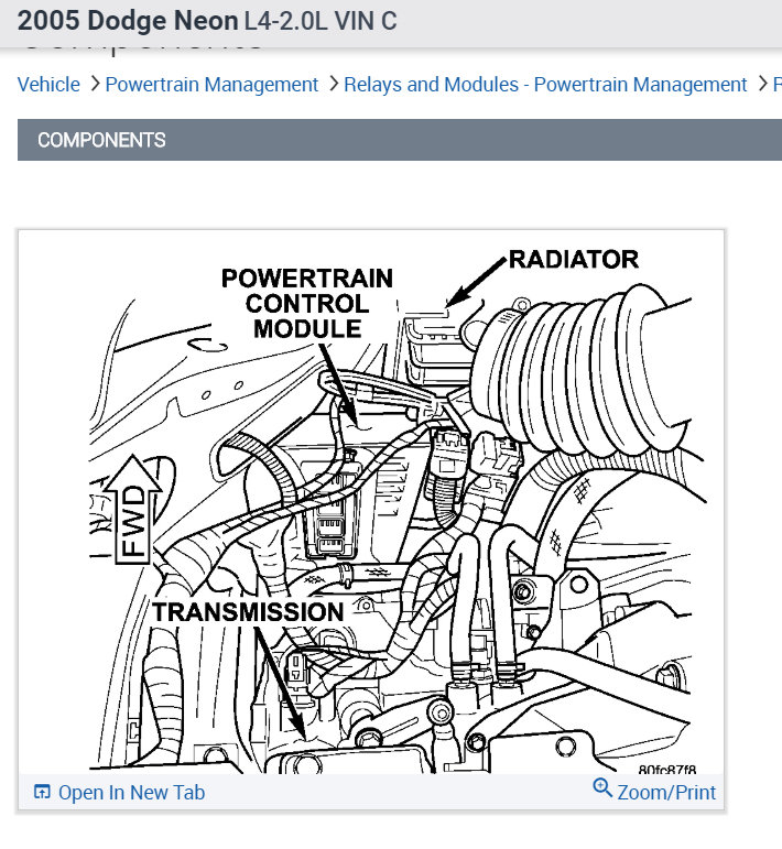

  • 55,423 POSTS
You might fo blown out the PCM, here is the location os you can get a rebuilt/used unit to try it. Check out the diagrams (below). Please let us know what you find. We are interested to see what it is.
Mar 25, 2019 at 3:25 AM
