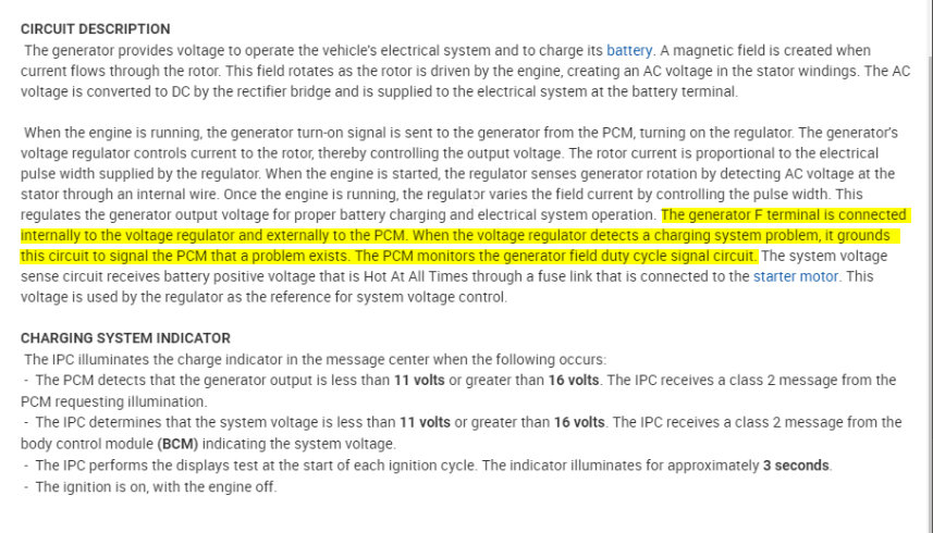

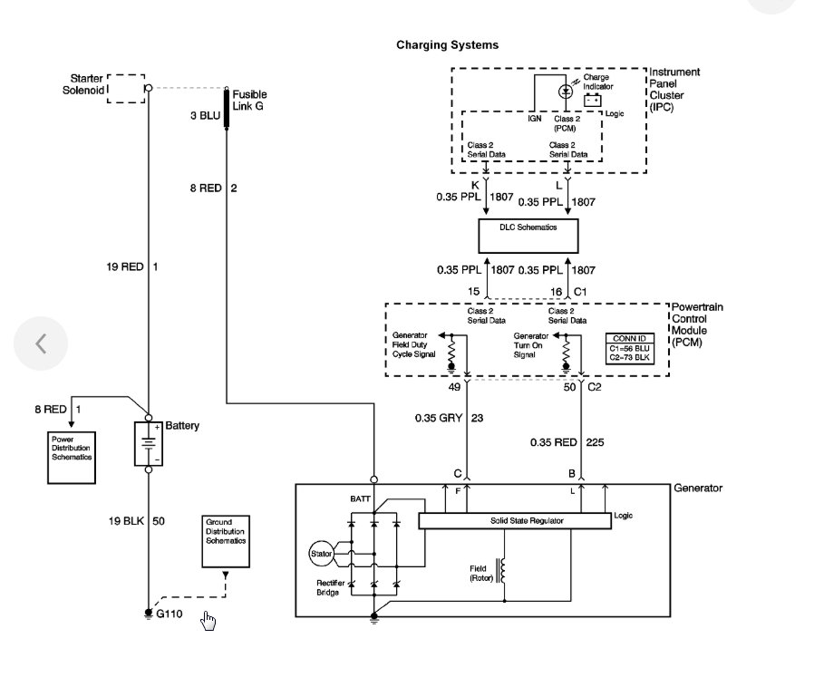

Hi, I don't know if it would make a difference but it's from Canada. So the battery light came on a couple weeks ago and the car shut off on me. I bought a brand new alternator (the one I took off I put on a week before from a salvage yard) still nothing later in the day I noticed the wire from the alternator to the starter was off. I put a new end on it and fixed it and still nothing. I even tried putting an additional wire on the stud on the starter and going straight to my battery and still wouldn't charge it. The plug on the alternator has a red wire and a grey one the red wire lights up the test light and the grey one won't. The schematic shows that the grey wire goes to my computer. My buddy thinks the computer is bad but I have no clue at this point. Any help with this would be amazing. thank you

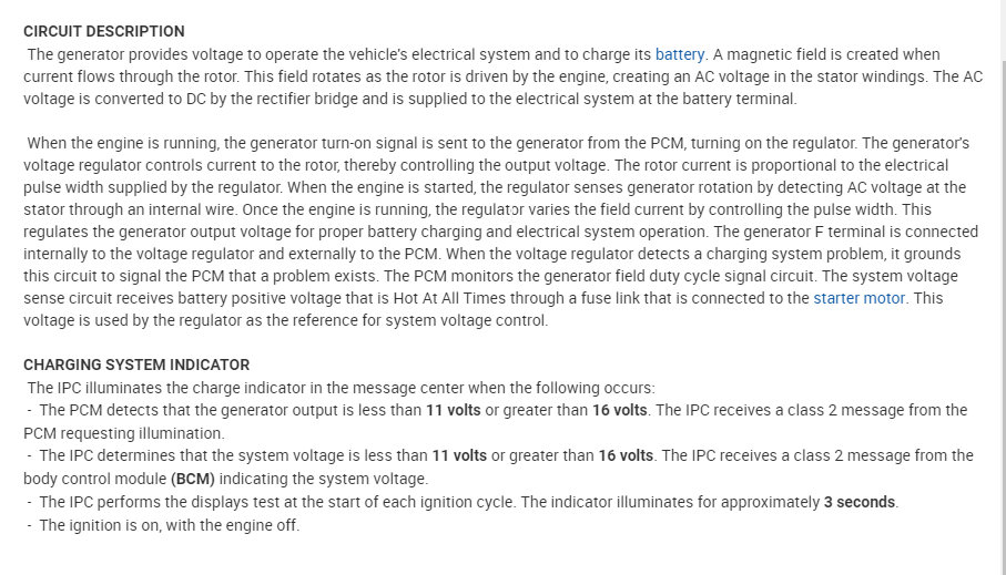

The PCM is responsible for turning the generator on and off. This is done through the smaller red wire on the generator. The grey wire is the duty cycle that the PCM monitors. It is only grounded when there is an issue. So I would not think this is your issue.
A battery light normally comes on when the running voltage drops below a threshold. Normally we think this is caused by the alternator but it can also be caused by a weak battery.
I assume you are measuring the voltage on the battery when the engine is running and expect to see close to 14volts. If you are not seeing this then first thought is the alternator. However, if the battery is discharged enough then the alternator will not be able to reach this voltage.
Think of it this way, the battery is your foundation and if it is not around 12.6 volts on its own then the alternator cannot reach 14 volts of the overall system.
I would stop by a parts store and have the battery load tested. If it passes then let me know and we can dig deeper.

Okay. Per the service information (highlighted in attached) the grey wire is only grounded when the voltage regulator detects a problem. Otherwise the circuit is not grounded so there should be no voltage coming from it to the PCM.
If the battery has 12.4 volts or more and the alternator is new, here are the next steps.
1. Inspect the serpentine belt (replace if suspect) and the tensioner to make sure your alternator is not slipping due to insufficient tension.
2. What is the voltage on the B+ wire with the engine running? Large red one that probably has a bolt holding it on. Not the red wire going to the PCM. I know you said you have voltage on it but what is the number?
3. Check you battery terminals and wires for looseness and corrosion, including the ground for the battery negative. The I would suggest doing a resistance measurement on them. Basically, this is just unhooking the cable from both ends and measuring resistance from end to end. This is where you set your meter to ohms and it should be around .5 ohms.
4. Just run through your fuses with the engine running and make sure you don't have any blown fuses. This is unlikely but is easy enough to check and could drive us nuts if not checked.

Update. I replaced the alternator a couple more times with the warranty my local parts store doesn't test them. We put power to the red wire on the two wire plug going to the alternator and it is now maintaing the battery but still isn't charging it. I work at a GM dealership but don't wanna pay to have them look at it for days but I got the schematics from the GM computer

Ok. As stated in the first response, have you monitored the PCM? The lead tech should be able to do this. The PCM is responsible for sending the turn on signal to the regulator when the engine is running. If the PCM never sends this signal then the alternator will not have any output. Go back to the first post and read that circuit description.
