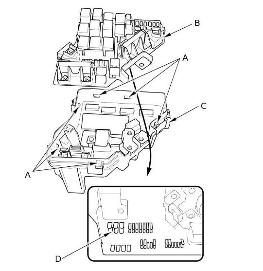

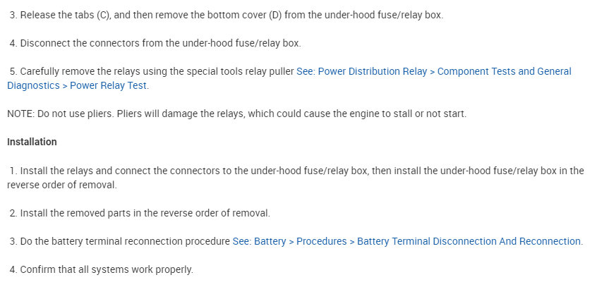

Research on Honda forums suggest this blinking is often caused by a faulty electronic load detector (eld). We understand the eld is located in the engine compartment electrical box.
Could you provide us with the testing procedure for eld and step by step instructions for the replacement of the eld? Also, any other insights you might have as to why this blinking is occurring.

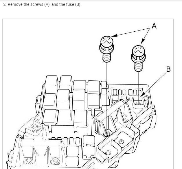

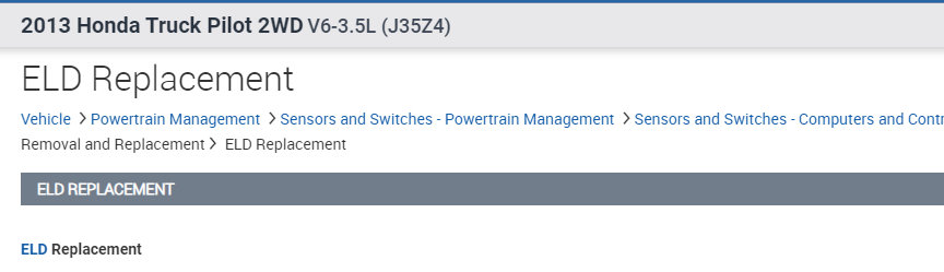

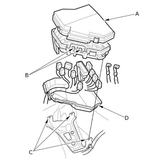

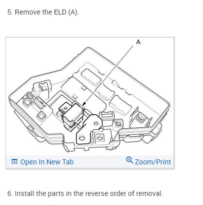

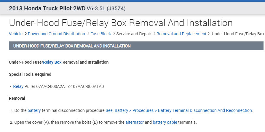

This could be the cause. However, according to my manual, there isn't a specific test just for this part. However, I have an idea. Since the light comes on for approximately 25 seconds, I suggest testing at the battery if there is a voltage change between when it's on and off.
Here is a link to help with that:
I suggest doing this because it started after the new parts were installed. The alternator may be keeping the battery charged but may have an intermittent issue causing the light. If there is no change in voltage, then the VLD is the likely cause.

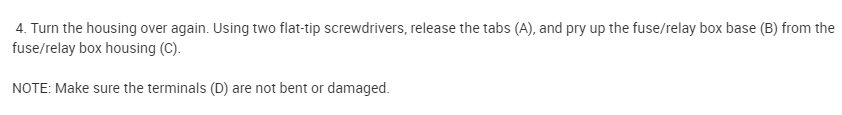

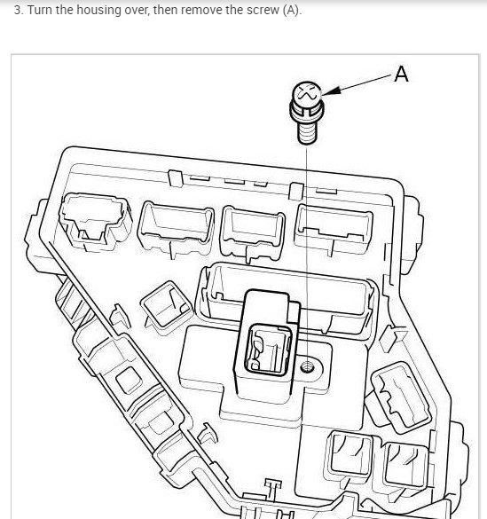

As far as the replacement of the VLD, I attached them below for you. I started the directions with the removal of the fuse box under the hood. That needs to be done first. However, make sure the battery is disconnected prior to removing the box.
Let me know if this helps.

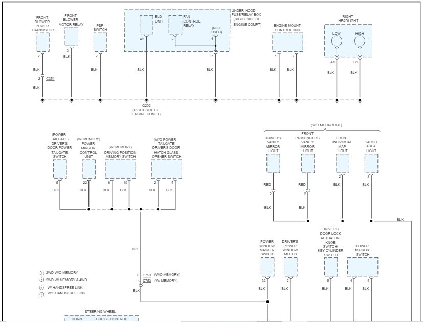

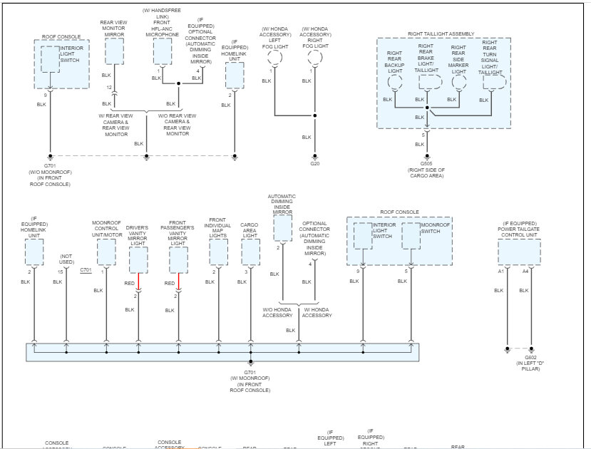

So far, we have replaced the electronic load detector (ELD) with no change. Next, we replaced the alternator with another new alternator (14.4V output) with no change. We load tested the new battery and it tests good. My son says he cleaned the battery terminals and block ground however sometimes his idea of cleaning is not the same as mine. Since it now appears to be somewhat intermittent maybe we have a grounding issue.

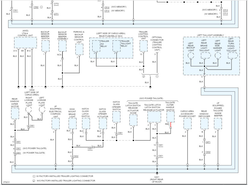

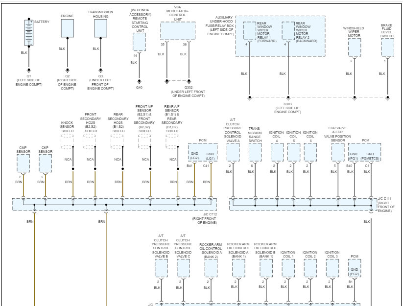

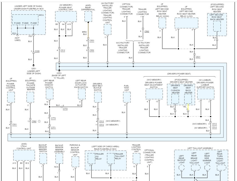

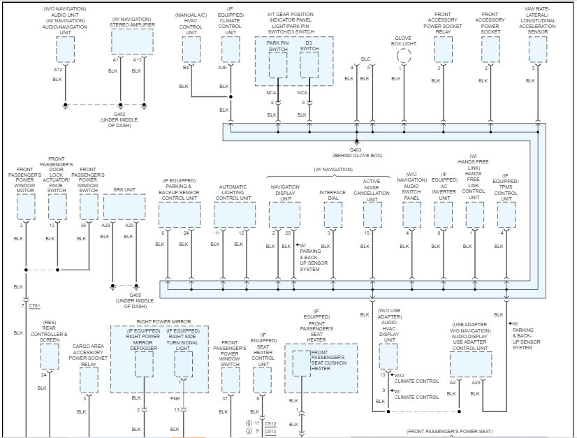

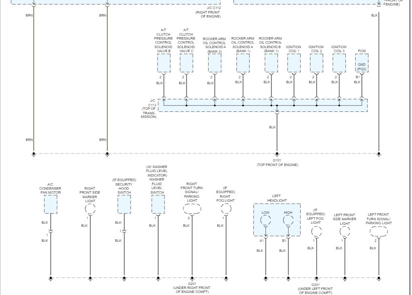

Could please you get me a diagram of the grounds locations both body and engine for this vehicle We will then go through each and insure they are clean and bright.
Thank you in advance for your reply and thank you again for your help in the past.
Dec 14, 2022 at 12:01 PM
  • 110,251 POSTS
Anything is possible. It could be a weak ground, but I would expect that to trigger the light every 25 seconds (when it happens). But, stranger things have happened.

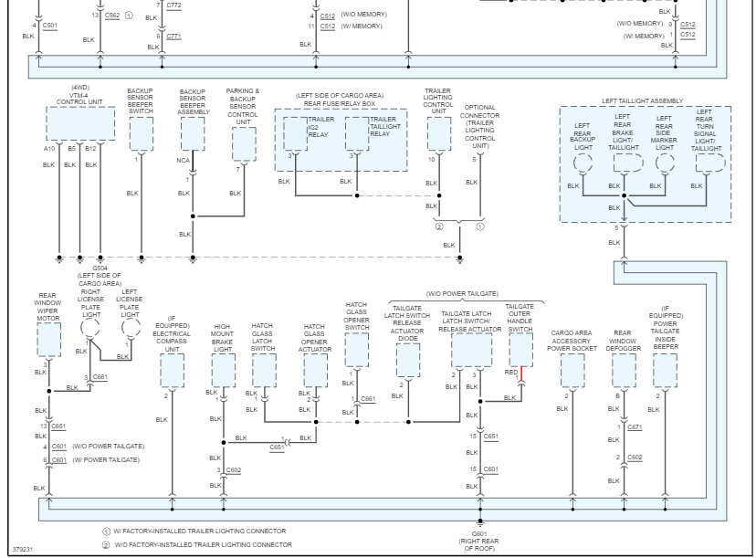

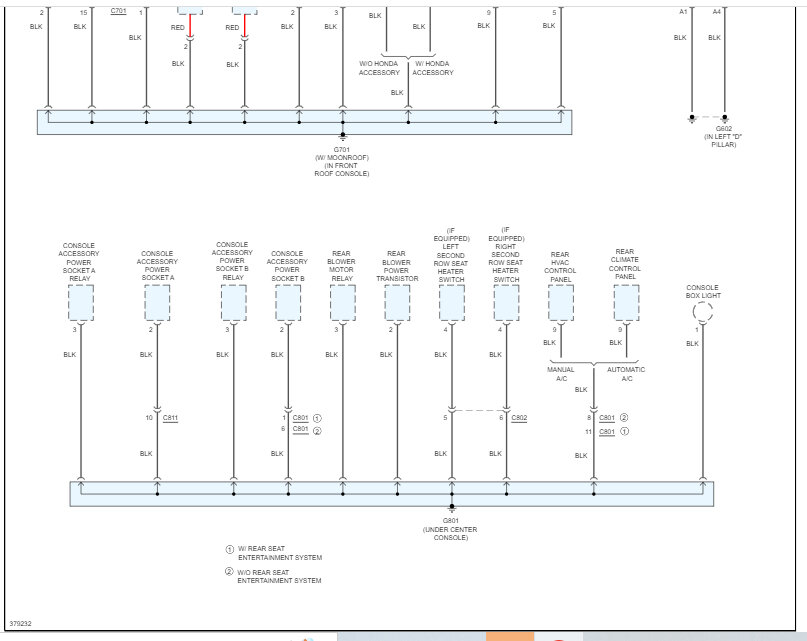

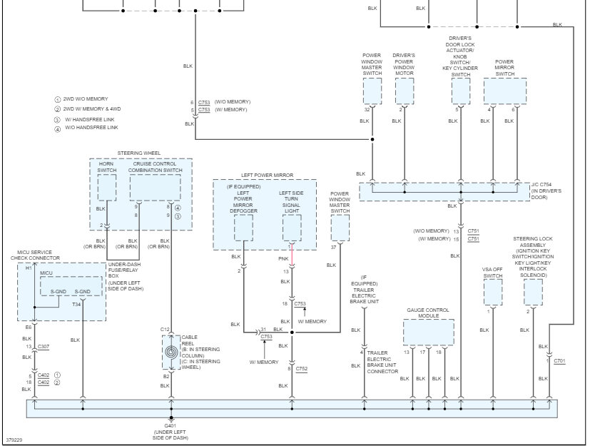

I attached the entire ground distribution schematic below. I had to cut each pic in half to make it readable. I did overlap them for you.
Take a look through them and let me know if you have questions.
