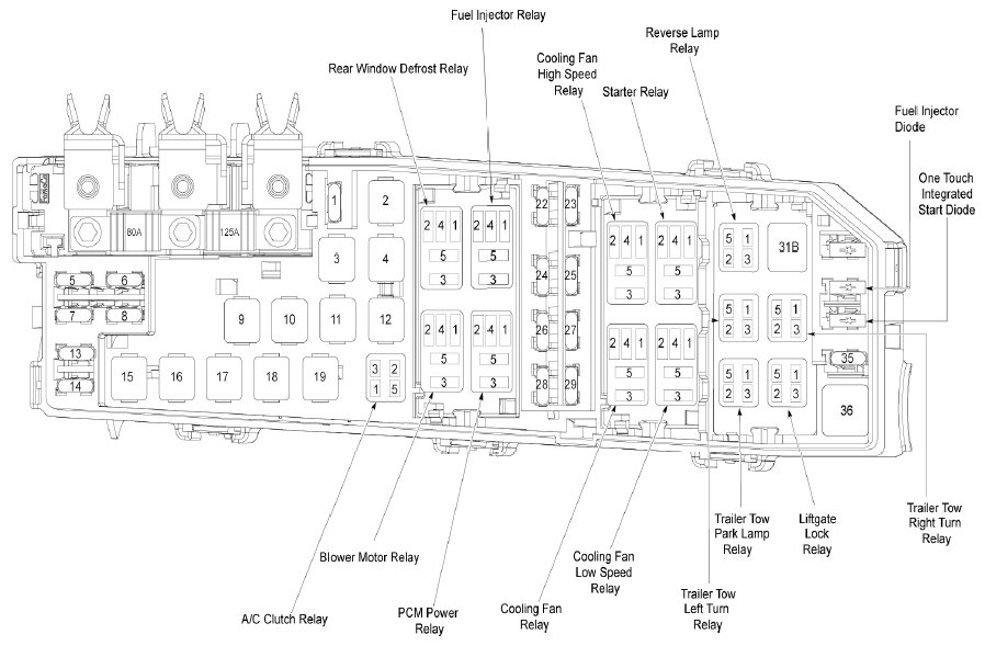

My car is charging and battery is okay, but battery light stays on.

I had the alternator tested and the battery to both okay. I said I knew very little about fixing cars but I am not a mechanic, but know a lot about car repair.

This is the junction box located next to the battery. Check fuse #6. It is for the alternator. If blown, your alternator will show as charging, but not actually be charging, which will trigger that light.

I checked number six fuse it is not blown it is okay. there is something I forgot to mention when I sent the first question in the light go's out sometimes usually of a morning when you first start the car but soon as you start to move it comes back on but sometime it does not come on at all, but usually it does. I hope this helps you to figure it out. Sorry I did not mention this before. I just did not think to about it, sorry.
